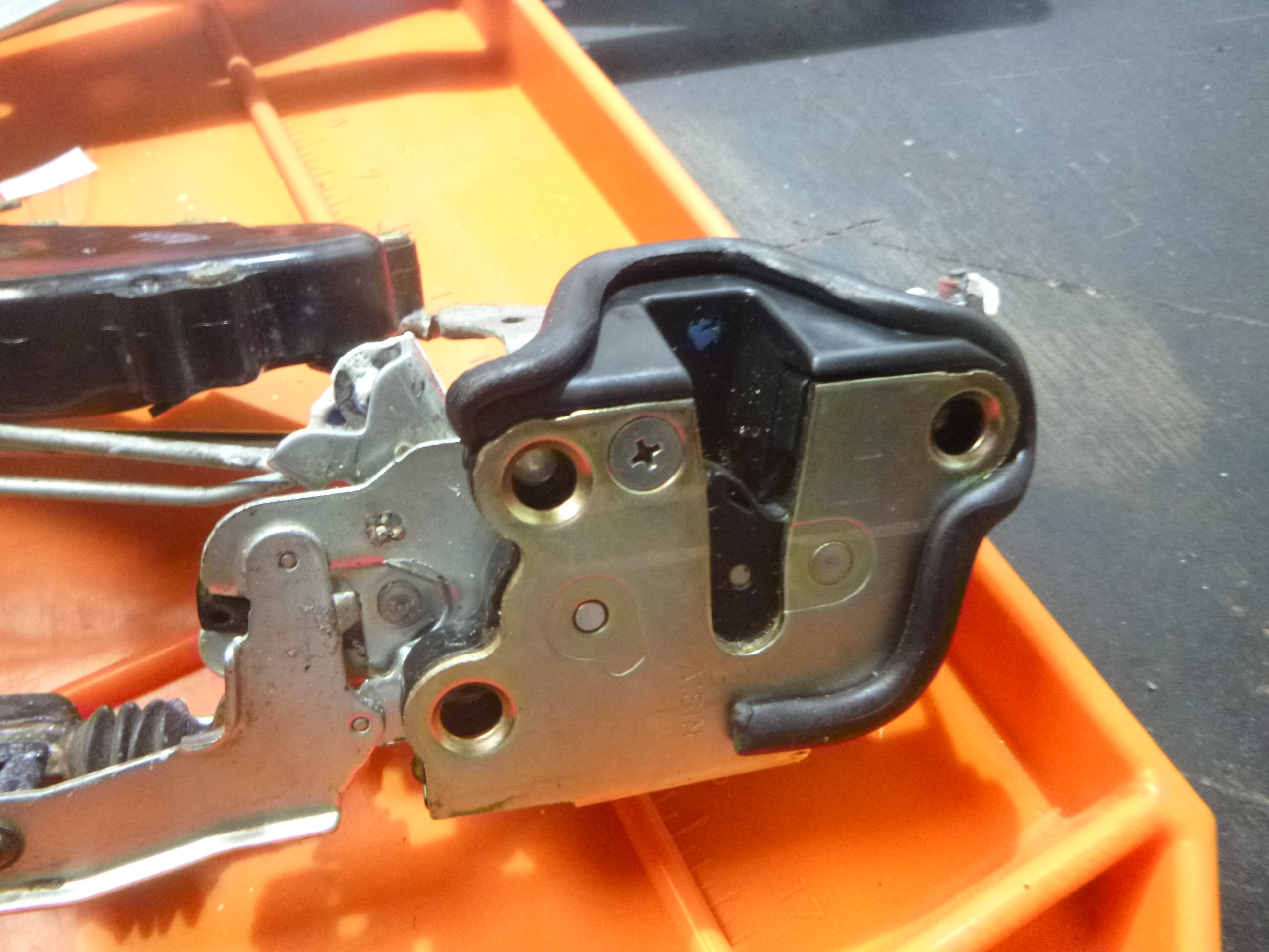

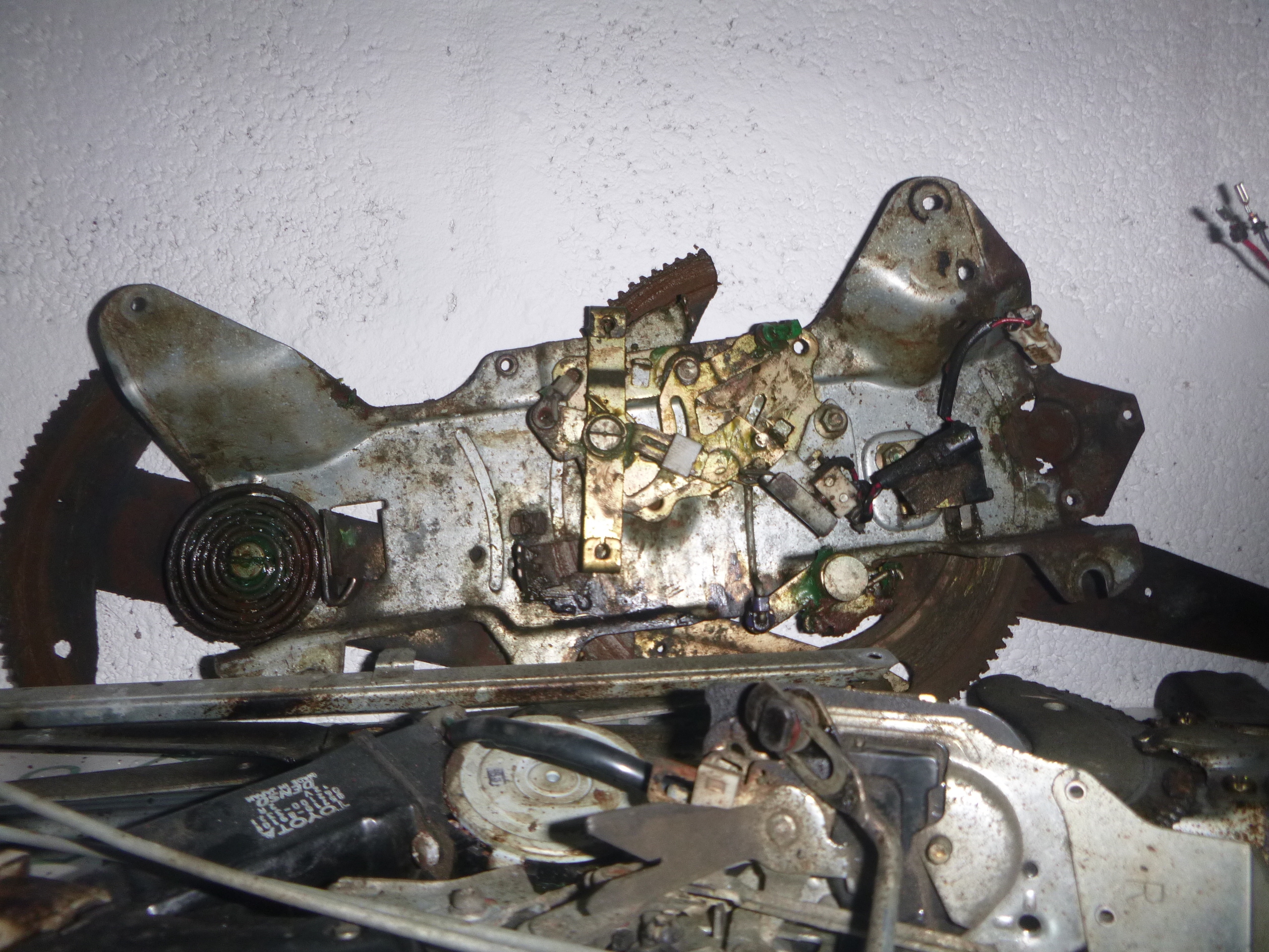

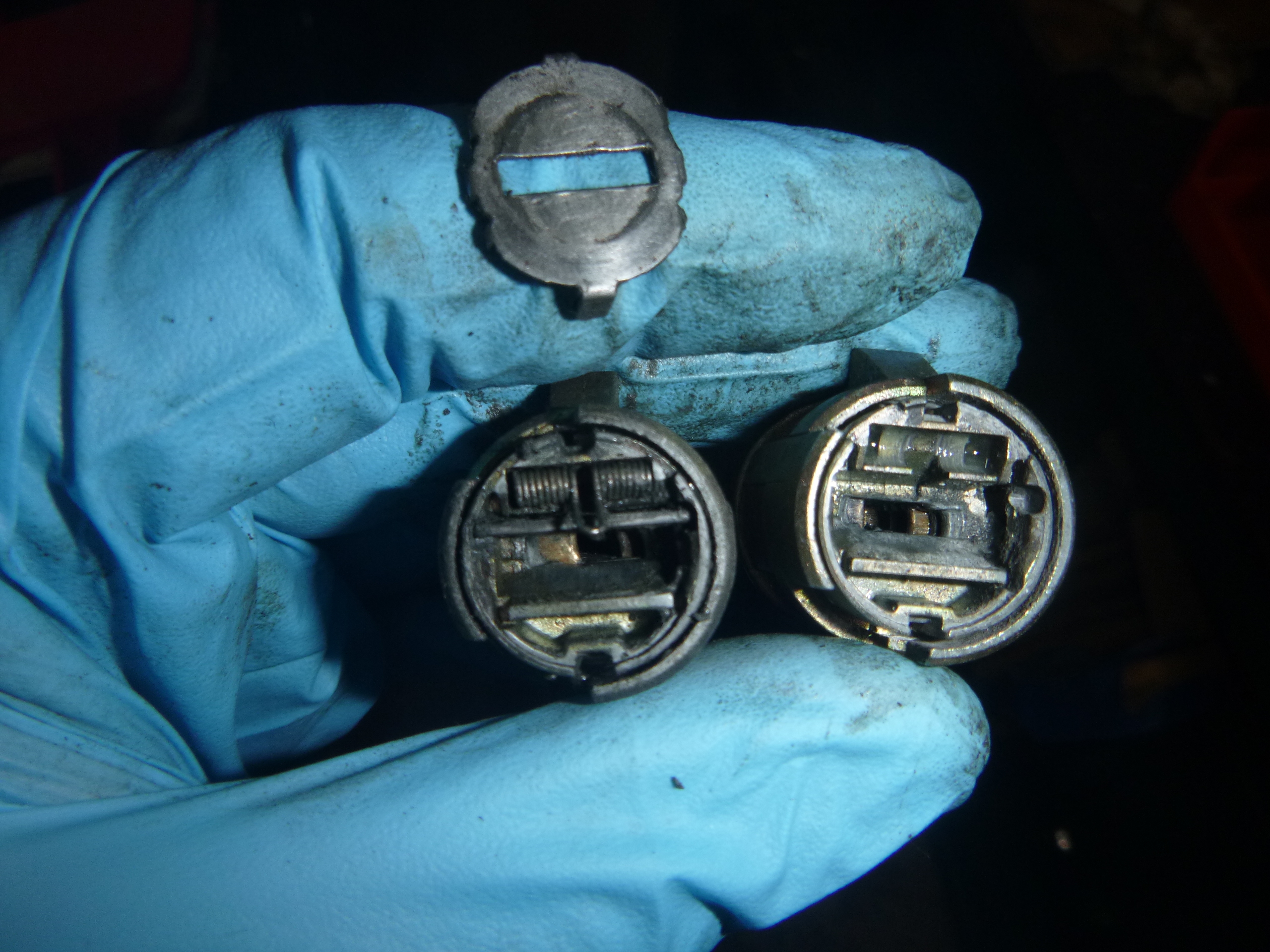

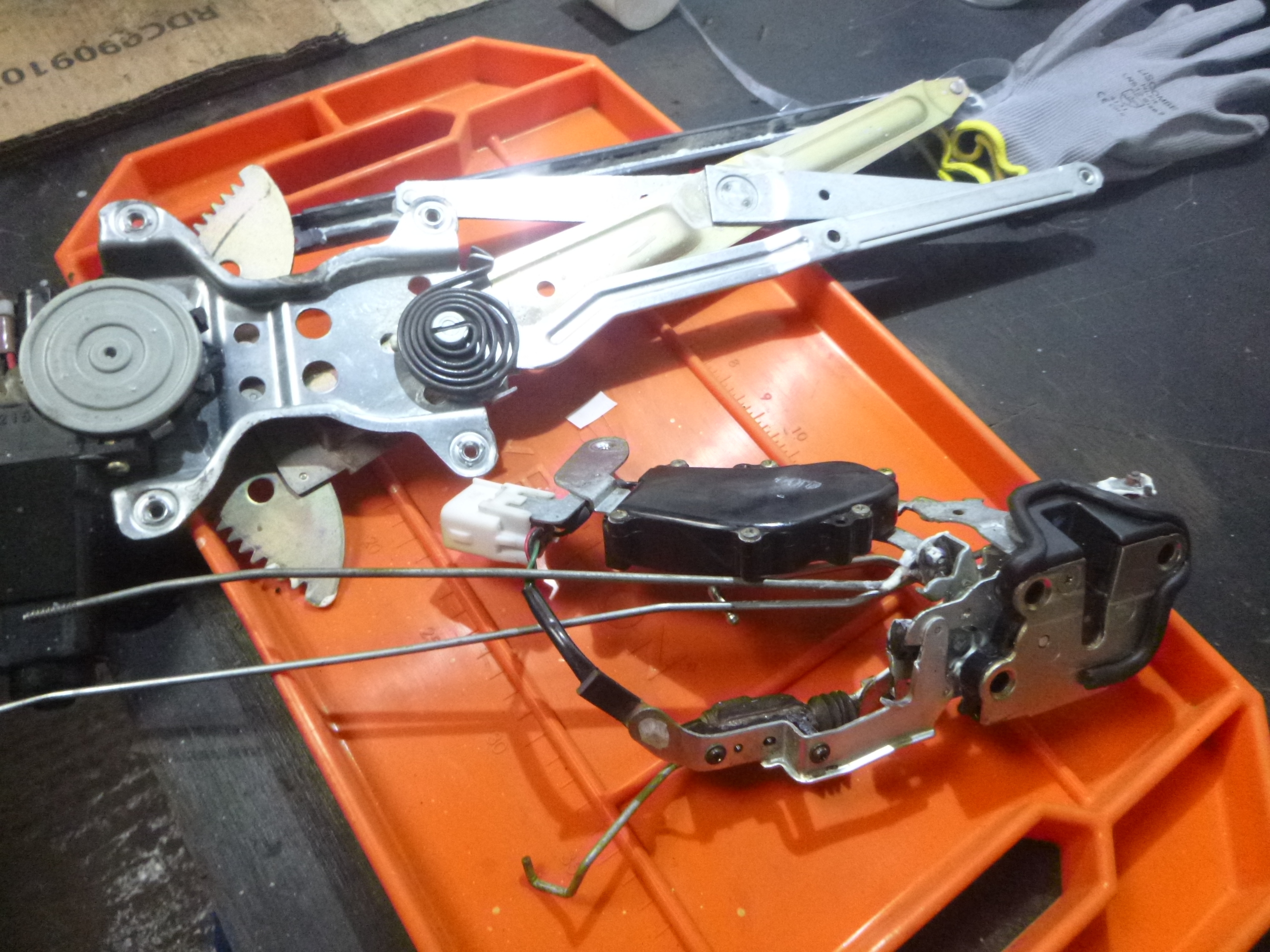

            Doors! My ignition barrel was smashed so I'm changing the lock cylinders to match. The ones that arrived (example on RH of first pic) didn't have the closure plate (slotted front) or the hinged plate that the key first presses against. Fiddly but OK to do.
            Window regulators were dirty with old grease, grime, and waxoyl back from doing the door cavities - as you can see on the tailgate one, pictured. I've cleaned them all up, regreased (white spray grease that dries non sticky) and fitted with freshly tinted glass in the front doors. Latches and outside handles also done.
            I have spare regulators for back doors if anyone needs. Also got spare outside handles - chrome as pictured on mine.
