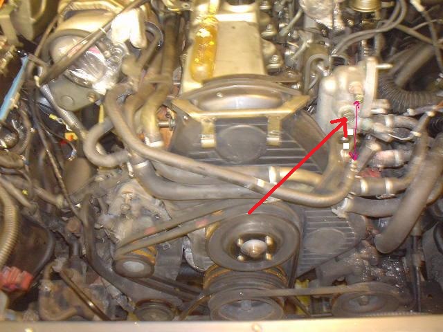

    Anyone know what thread this plug is? I need to obtain an adaptor to replace it so I can fit a water temp sender in it, (also am I right in thinking the aftermarket (cheap) gauge senders are 1/8th npt, or whatever they are)

    most i've come across, are 1/8th npt.or bspt, ian
      Cheer's Scott, thought the senders were 1/8th, just wanted to check on that blanking plug before I attempt to remove it, I have some odds and sods of adaptors knocking about but in case I need to order one!
        M16 for the plug. Most gauge senders a 1/8 NPT.
        Nev.

          Thanks Nev, I was hoping you would reply
