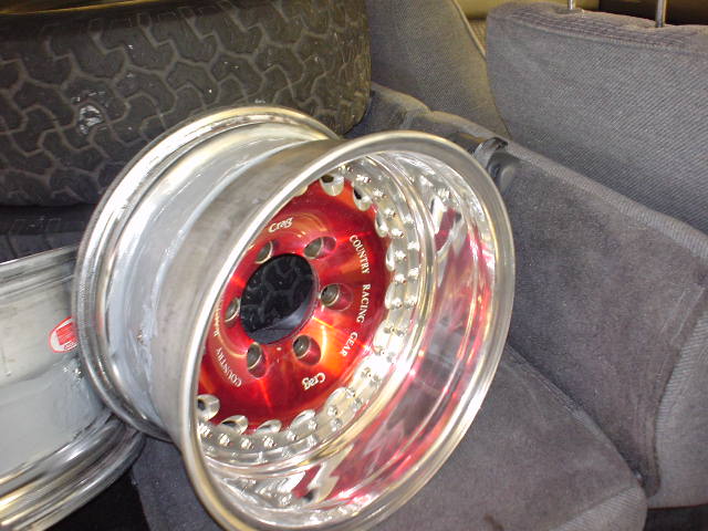

I did do a fair bit of work on mine to get em shiney, they are three piece split rims, I changed the rims round on the center spider so I have the deep dish rim on the outside, from a label on the rim I found they are made in Japan by "W works" in Osaka, tried several times to find a seller dealing with them but all I got was a Japanese ebay type site selling one gold center rim!Too young to die and too old to give a toss

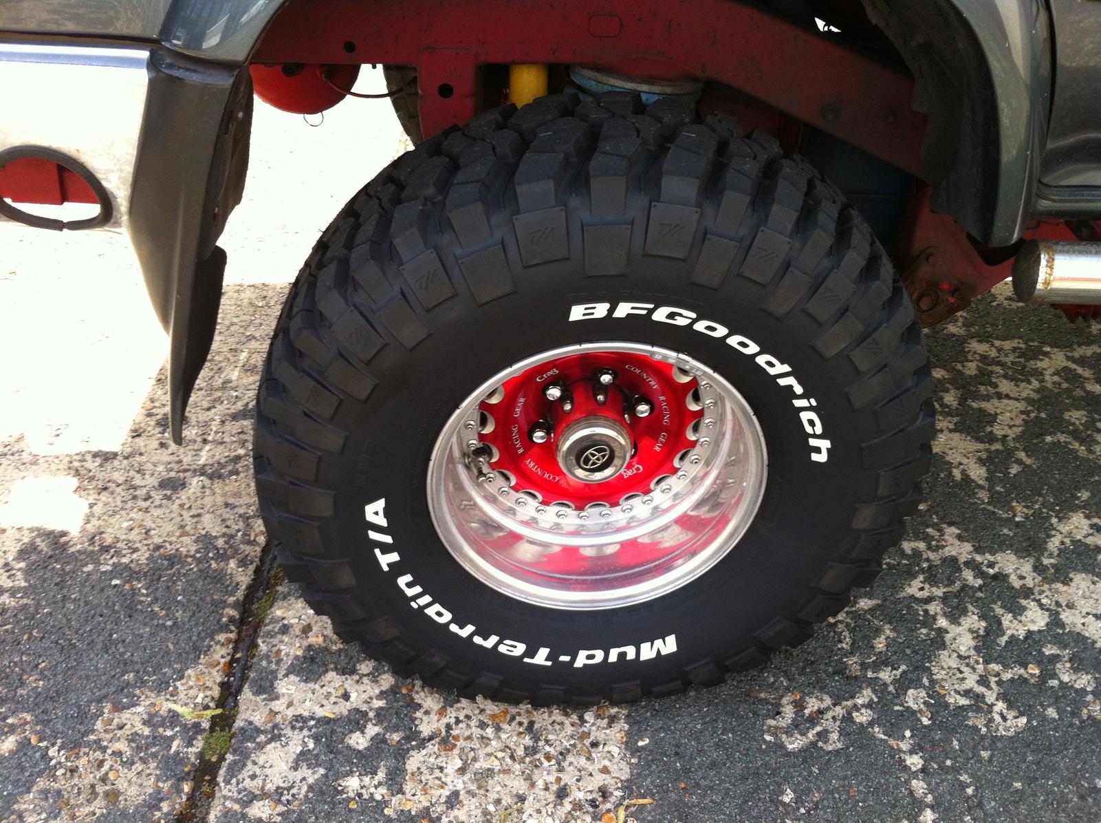

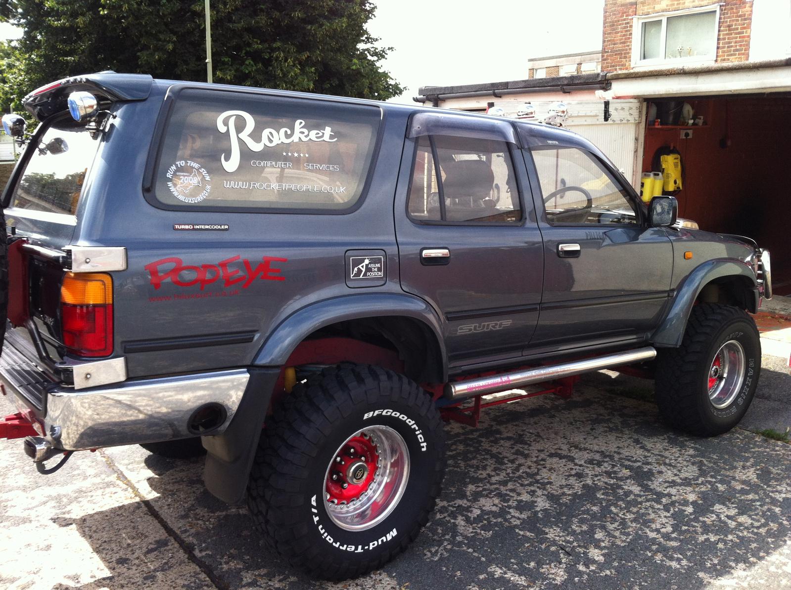

Thanks Scott, some more pics, if the rims you've found are "splits" then I guess they will look good, a lot depends on how much works you want to put in on them, the center "spyder" on mine are done I a sort of colour clear laquer, you can get this coloured laquer in several shades I think, (Vince "bushwacker" did some lexus alloy engine parts with it) looks stunning, you need to polish the alloy first, degrease it then apply the laquer, that way you get the metallic shine through the paint, the rims you will prob have to just polish, nothing special about it other than had sodding work, I used polishing mops in an electric drill, hard worh and very messy, I got black hands and face doing them,

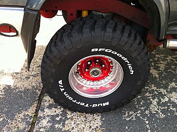

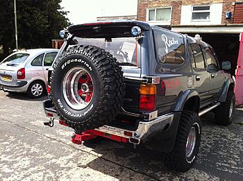

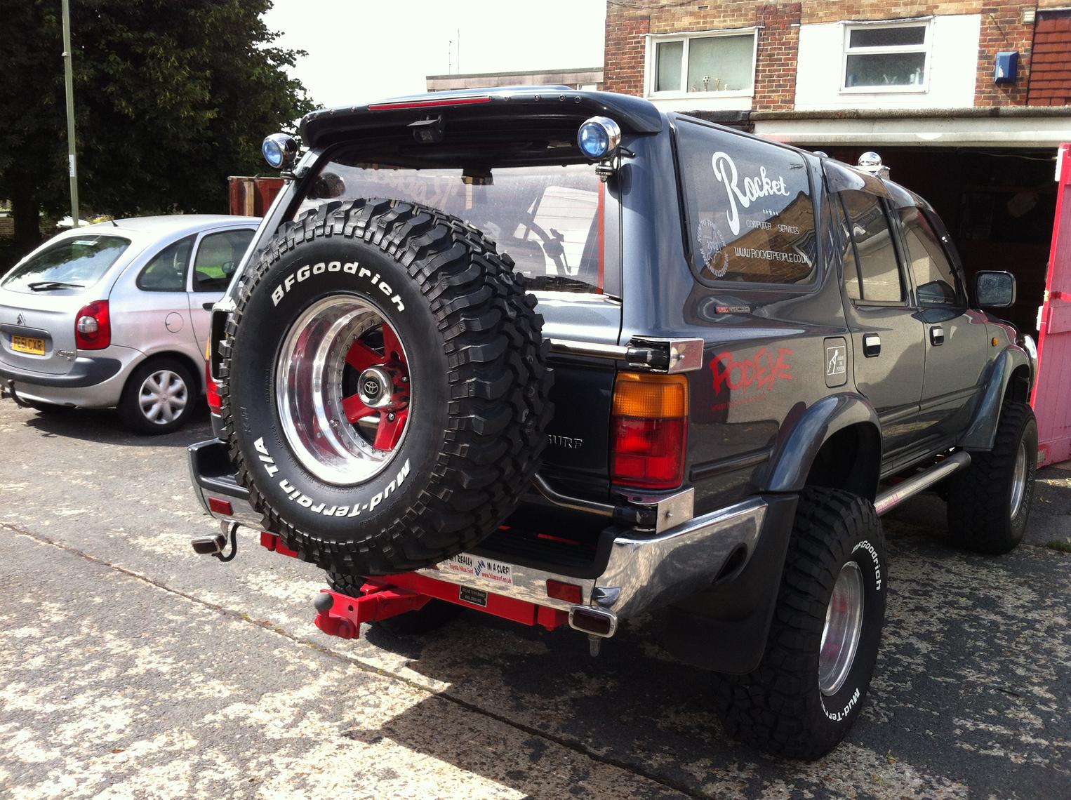

as you se from the pics my spare was also a 3 piece split but a different wheel style, 5 spoke, just did the center in red, cheer's ianToo young to die and too old to give a toss

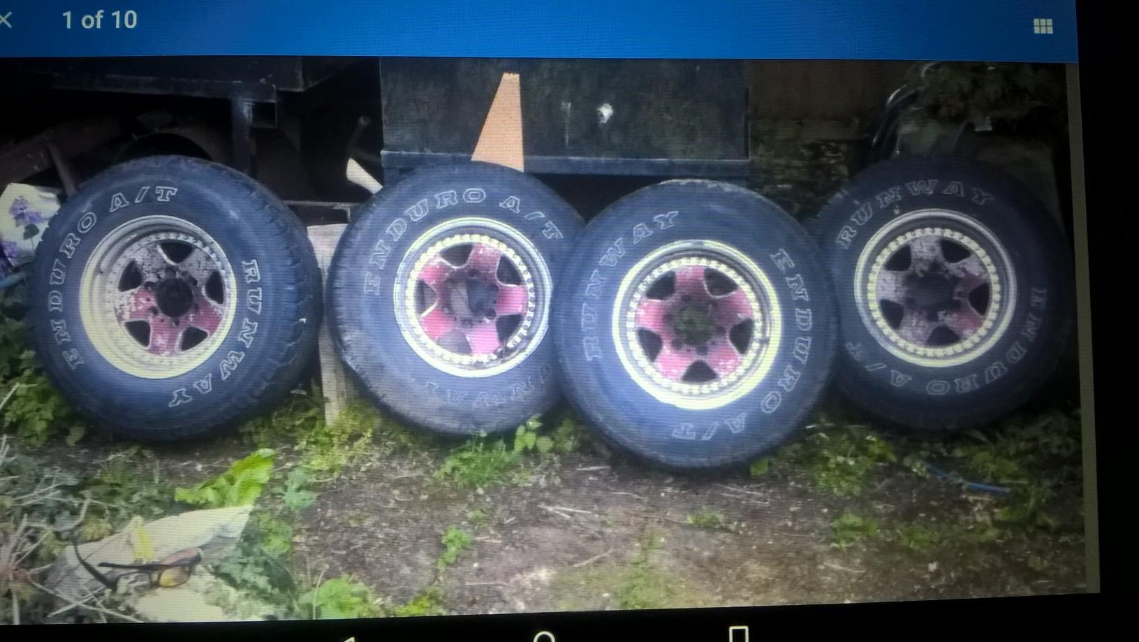

Hi ian , thanks for the pics your truck looks superb , the alloys I am looking at are very similar to your spare wheel , they are 16 x 8 and came of a hilux , so hoping they will fit my 3rd gen surf , I will try and post a pic of them but they do need total refurb but I like the style of them
The one on the back isn't a bad design, do you know if the ones your looking at are 2 or 3 part rims? like I say mate it's hard work refurbing these things,
it makes it easier if there split rims as far as polishing goes also for painting if you want the centers a different colour to the rims, they will look very nice either way,
if they are splits and you get em don't do what I did, I started undoing all the little nuts and bolts and didn't properly let all the air out, all of a sudden it went BANG! nearly shat myself
two part one are easier, you can just undo the center without letting the air out but I'd advise letting it out anyway,

Not wrong at all mate, your truck, your choice, you wouldn't be the first to fit Mitzi wheels, I always thought the stock Toyota alloys (2nd gen) were a bit crap, especially when the old corrosion got at em, one of the first things I did was to get rid of them, saw the Crag country ones I have now and just had to get them, they came down from Scotland btw, Falkirk I think, there are a lot less decent ones on ebay lately I see, one time there were lots of them, now all there seem to be are the spidery spoke things and elastic band tyres
They look exactly the same as my spare Colin, they will "do up" very nicely, depends on what you want the finished wheel to look like, myself it's colour and polished alloy but you might want a different look, thye are 3 part rims I'm sure, if you need to strip them you will need to coat the mating faces of the rim half's with a decent sealer, I used a good quality silicon sealant, and had no problems, use it spareingly, too much and it can pop out and leak when you pump them up,
I'd strip the centre spyders and polish them then spray a colour lacquer, they will look great.Too young to die and too old to give a toss
if there like mine they are nuts and bolts although I think some rims just have decorative studs, whats on the inside? you should be able to see the nuts if there split rims, I take it you don't actually have them yet?Originally posted by Big dog View PostThanks for that , what are the little studs around the wheel are the just decorative or something I need to watch out forToo young to die and too old to give a toss
