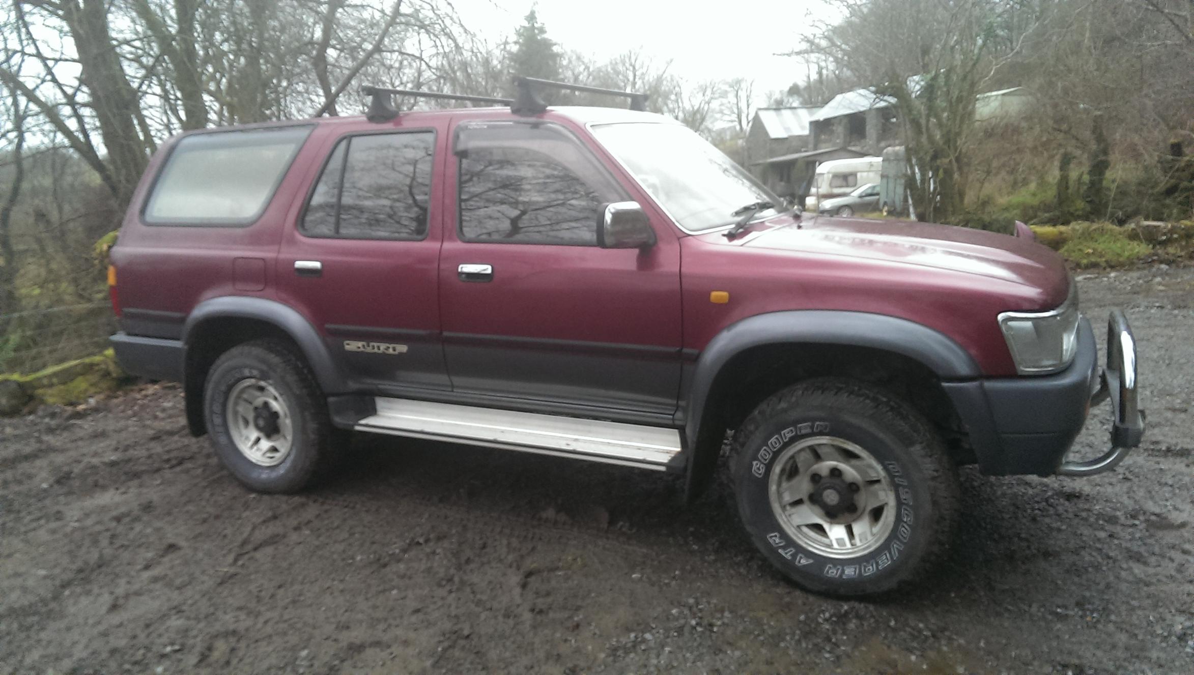

Hi all,
Picked up my new (to me) Surf last weekend. Got a few bits to do on it, but looking forward to enjoying the truck. 3.0 Diesel SSRX, Gen 2, 1993, manual.
