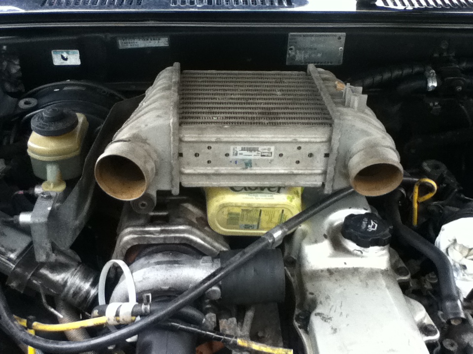

    Another one to add to the growing pile of intercoolers in the garage, the Rover and VXR units are now on eBay, and have now acquired this unit.
    Following on Vince's advice I have gone for a more compact design, and I'm sure that you lot are all waiting with baited breath to see the installation pics.....
    In preparation for the install the coolant hoses have been rerouted to give more room around the turbo and rocker cover area, (the metal coolant pipe assembly has been junked)which in turn will give a less obstructive air path to the intercooler.
    Just got to pluck up the courage to cut the first hole in my bonnet.

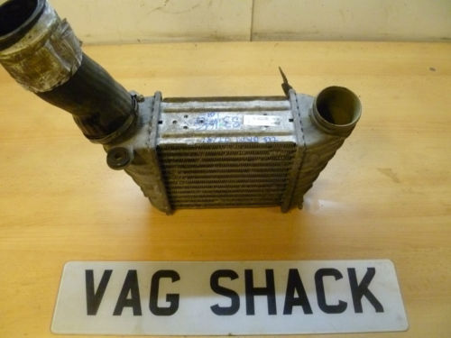

          VAG shack Ade? Isn't that a brothel?
            LOL
            God knows, I never looked at the signs just liked window shopping
            When I was surfing eBay and saw that name I did actually spray out a mouthful of tea.
            I just can't believe that Gra missed it, he must have mislaid his glasses.
            Eat.Sleep.Surf.Repeat.
              Must be where the vagatarians live. Gwaham did spot it, but he goes all silly and embarrassed when we talk about girly parts.
              That and it brings back memories from his pre op days.
                Ooohhh....I've gone all unnecessary.

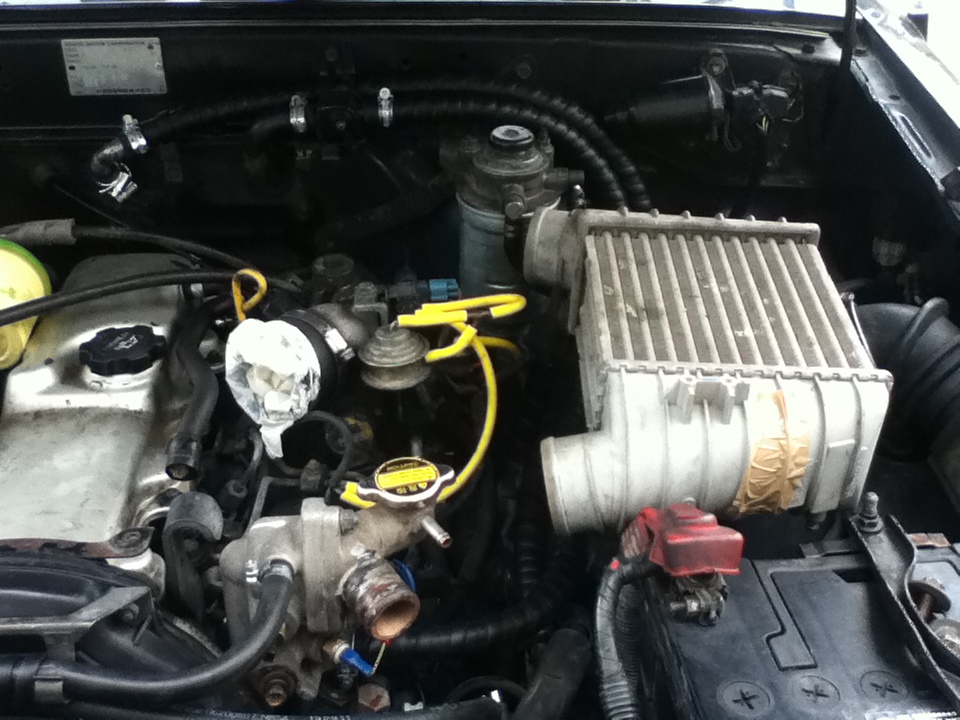

                  This is the position I have settled for shown in the picture on the left, it's a shame that the airbox is in the damn way!
                    Excellent positioning.
                    It's a low pressure turbo remember, so the shorter the pipework the better.
                      Slightly more manageable size I/C than the VXR one
                      So "S" shaped pipework feeding intercooler entering on the left will be better than straighter pipework crossing over and feeding into the RHS?
                        Yes. The air won't be gushing through the 'cooler so keep the runs short to prevent heatsoak.
                        Can't you shift it over to the passenger side a tad to centralise it?
                        Then you could probably pipe it up like the one TLB did.......
                        http://www.toyotasurf.asn.au/techsit...lingpajero.htm
