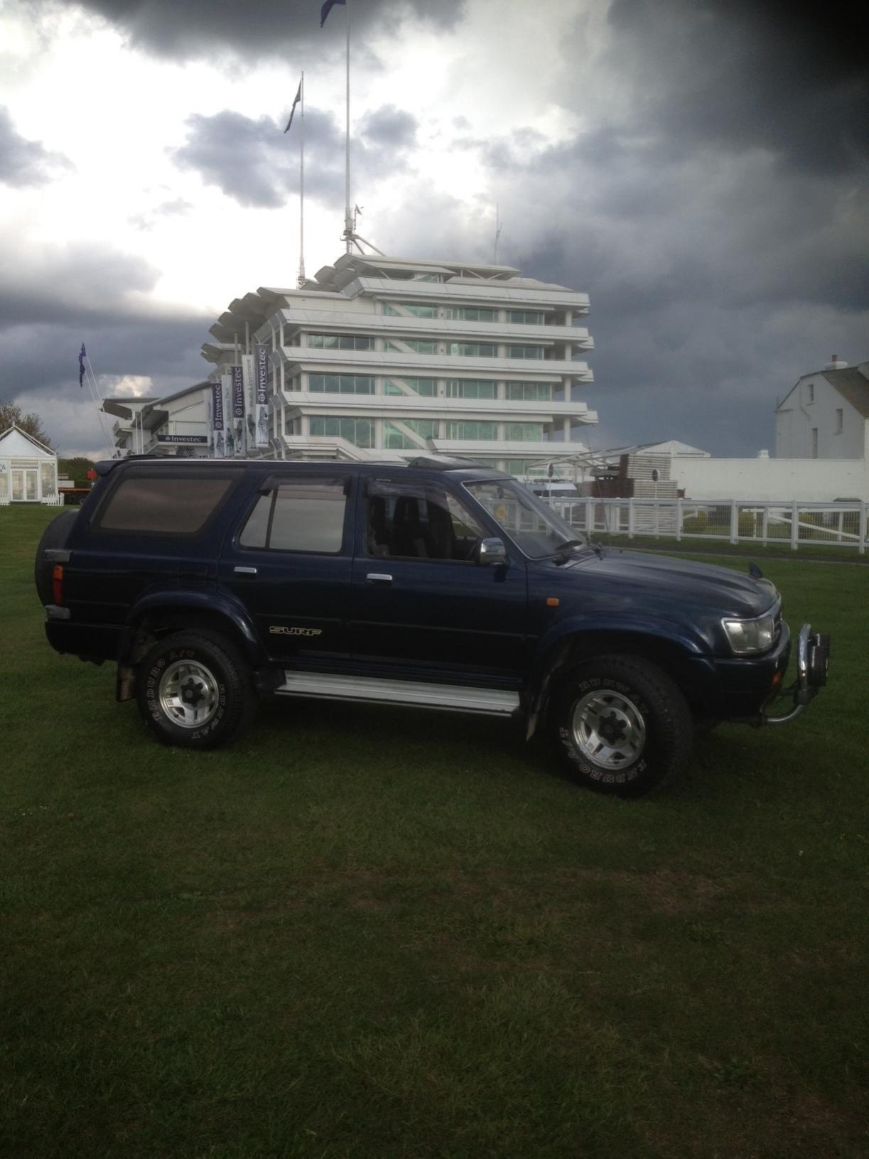

    I've had my Surf for 6 months and have got to say its the best car I've owned. From the picture can anyone tell me what is the maximum size tyre I can put on without any lifts, changing rims etc and a good place to buy them.

    For standard truck and rims then max size will be 31x10.50x15's

        Ya could go up to 16" Steels/Ally with 265 x 70 (or 75) x 16 Rubber ..

          What is the average cost (or are there any surf specialists around Epsom) to lift the suspension 2 or 3mm?
            you have Tony at 4x4 toys in basingstoke he is a member on here TonyN
            SWIFT AND BOLD
              If you're handy with the spanners you can buy a set of +2" rear springs from Roughtrax for under a hundred quid and then just raise the torsion bars up an inch or so...couple of hours work, use the search bar to check out the threads on it.
