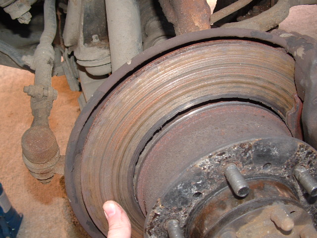

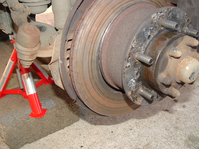

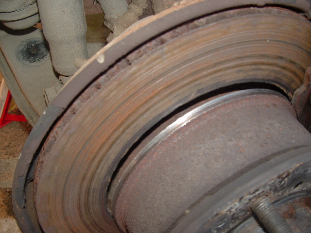

                            I have a feeling that this entry in my brake thread will possibly go down in the history files of this great site. That's not to sound conceited or anything, but when you see the pics, you'll see what I mean.
                            I freed off the offending caliper (front left) with more ease than I'd anticipated. G-clamps & plenty of brake cleaner aerosol/wire brushes action did the trick. The outer seals (dust boots?) were toast, as were the pads.
                            Obviously I need to fit new discs, pads and dust boots. I'm going to order them from Milner this morning.
                            My biggest problem will be removing the wheels. Purely by luck, the only wheel I can get off the Surf is the front left - the security nut on all three others won't budge. They're destroyed from previous owner's attempts to remove them. I guess I'll have to get my local garage to break them off.
                            Learn by my mistakes - investigate brake doubts immideately.
                            I'm lucky my bogey brakes didn't kill me or anyone else before I did something about it.
                            Mark
