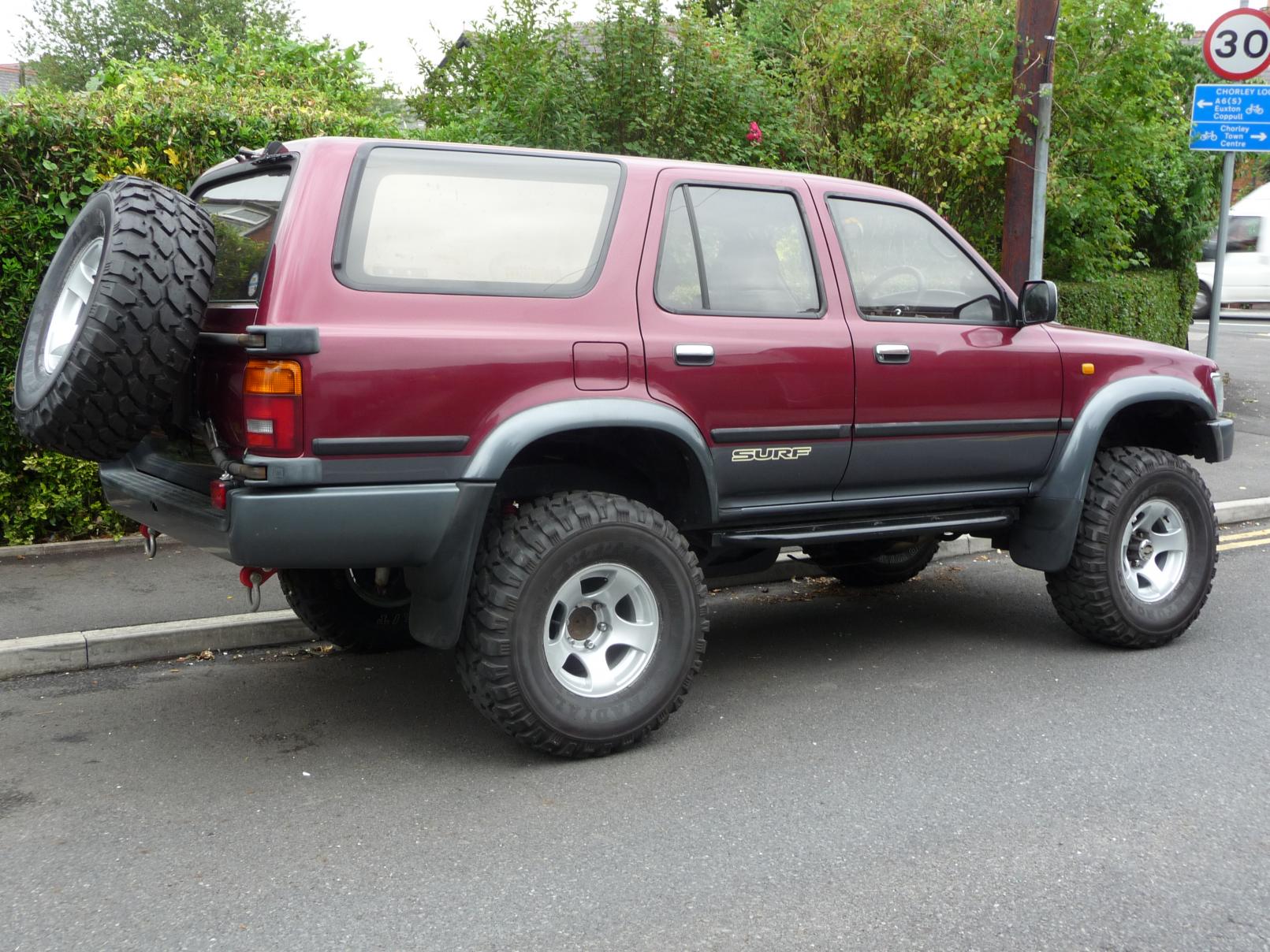

            Any pic's of this truck that you have on 35's ?

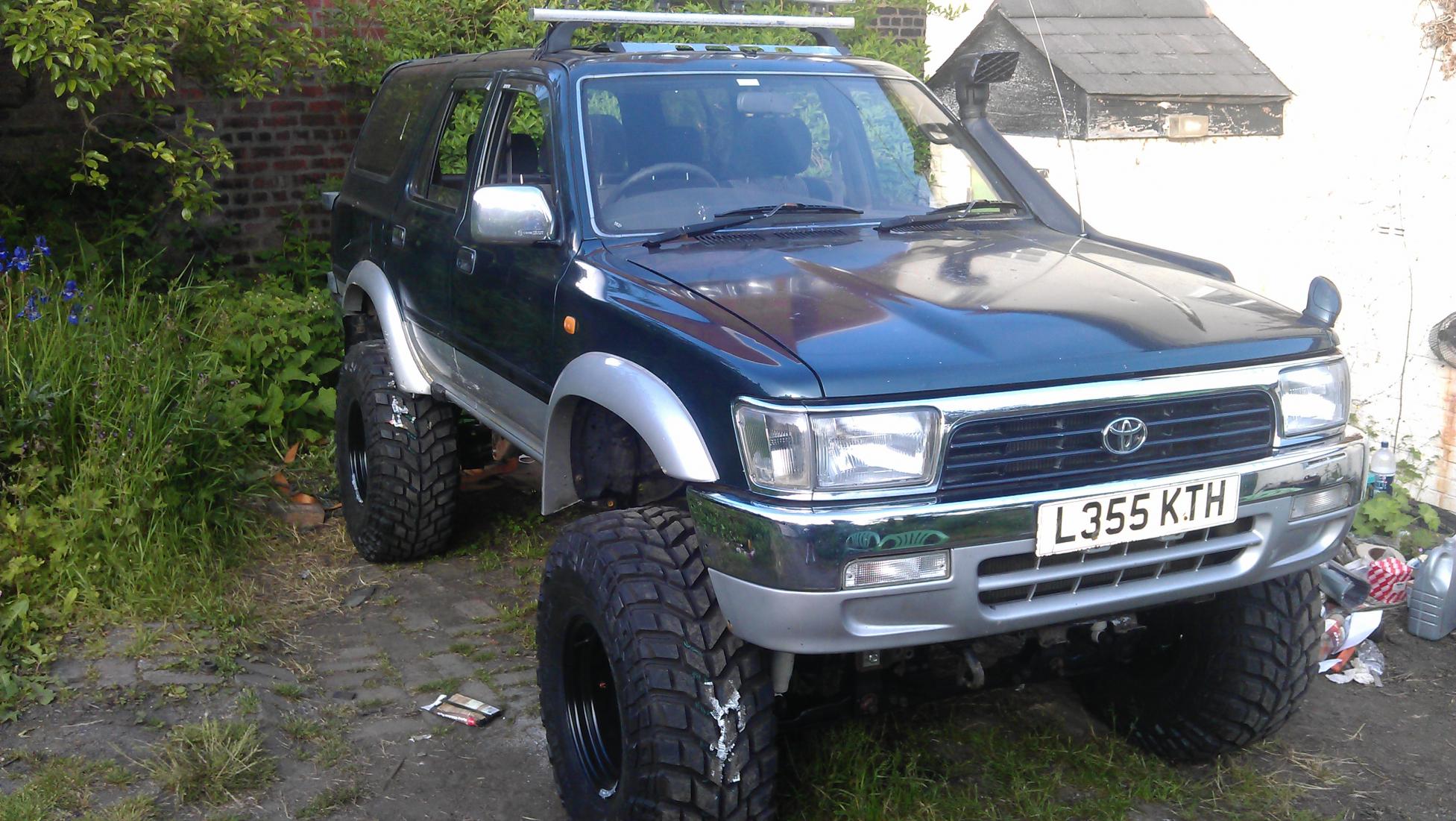

                    I do have lots of pictures as I rebuild the truck and all its running gear. I bough the 4-5 lift kits from roughcountry to see about the height for when I put live axles on it.but the spring on the back were way toomweak and feeble. And I had to modify the upper wishbones with a plate for the ball joint mounting because it kept catching on the ball joint spacer and puttin the ball joint angle way too much. It was just something to do whilst I was off work. Eventually my pland are to live axle it, v8 engine on 38's and spray it red and black. But im learning bpdywork as I go along.
                    Completely bitten by the off road bug, and what better vehicle to do it in!
                      Nice truck. Looking forward to seeing more pic's.

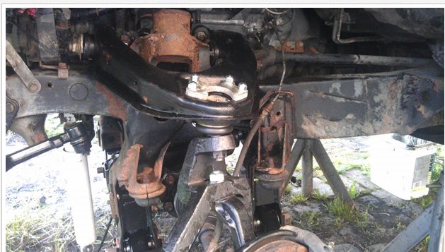

                            Your truck does sit nicely on those wheels. I can't work out what's going on with the ball joint spacers though ? (it's meant to be between the balljoint and the upper arm ? )
                              I sat the ball joint originally where it should have been without any spacers at all. What happened was 1. I lost my articulation from the front, because the bump stops were back to normal which give about maybe six inch of travel. 2. Because of all my rewelding of the shock towers, im using the kits rear shock for the front giving me a huge range of movement. My wheels will tuck right into the wheel arch from sitting on the sill line at ride height. But in doing so the hub adapter spacer was hitting the underside of the upperwishbone. So I used the ball joint spacers to drop the ball joint lower as a test. The spacers you see on the top is merely sandwiching the balljoing and allowing me to test it as I didnt have shorter nuts and bolts to hold it on.
                              Now I have plates welded covering the hole in the upper withbone that the ball joing sits on and is all square and neutral at ride height. So with modified bump stops my 35 tyre on the front will flex up to the top of the rim on the other side. Probably two foot or so. But only without the arb but driving is brown trousers without it, probably need uprated torsion bars. But all null and void now as I want live axle 3 link on fron and rear.
