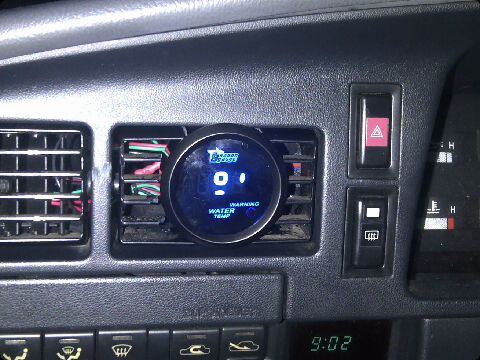

    Where to fit new digital coolant temp gauge.
    didn't want to buy or even know where to mount a pod.
    Solution, gently remove one air vent above heater controls.Cut a 50mm hole in the center & cut out 20mm from the top of vent frame,enabling the gauge to fit flush into the vent.
    The aperture leading into airbox is sealed, so to run the 3 wires I drilled a hole through the inside towards the back of the hazard switch.the wiring was easily routed to power,earth & temp sender.
    Pics to follow

              After wiring the unit, it failed
              Digits are illegible, ie only shows 1/2 of the numbers.
              Waiting for an answer ref replacement from ebay supplier

                  Double check your earth connection, if that is not sound, it gives the symptoms you described.
                    Hi Will
                    Removed the gauge from dash & connected direct to battery.
                    Same problem.

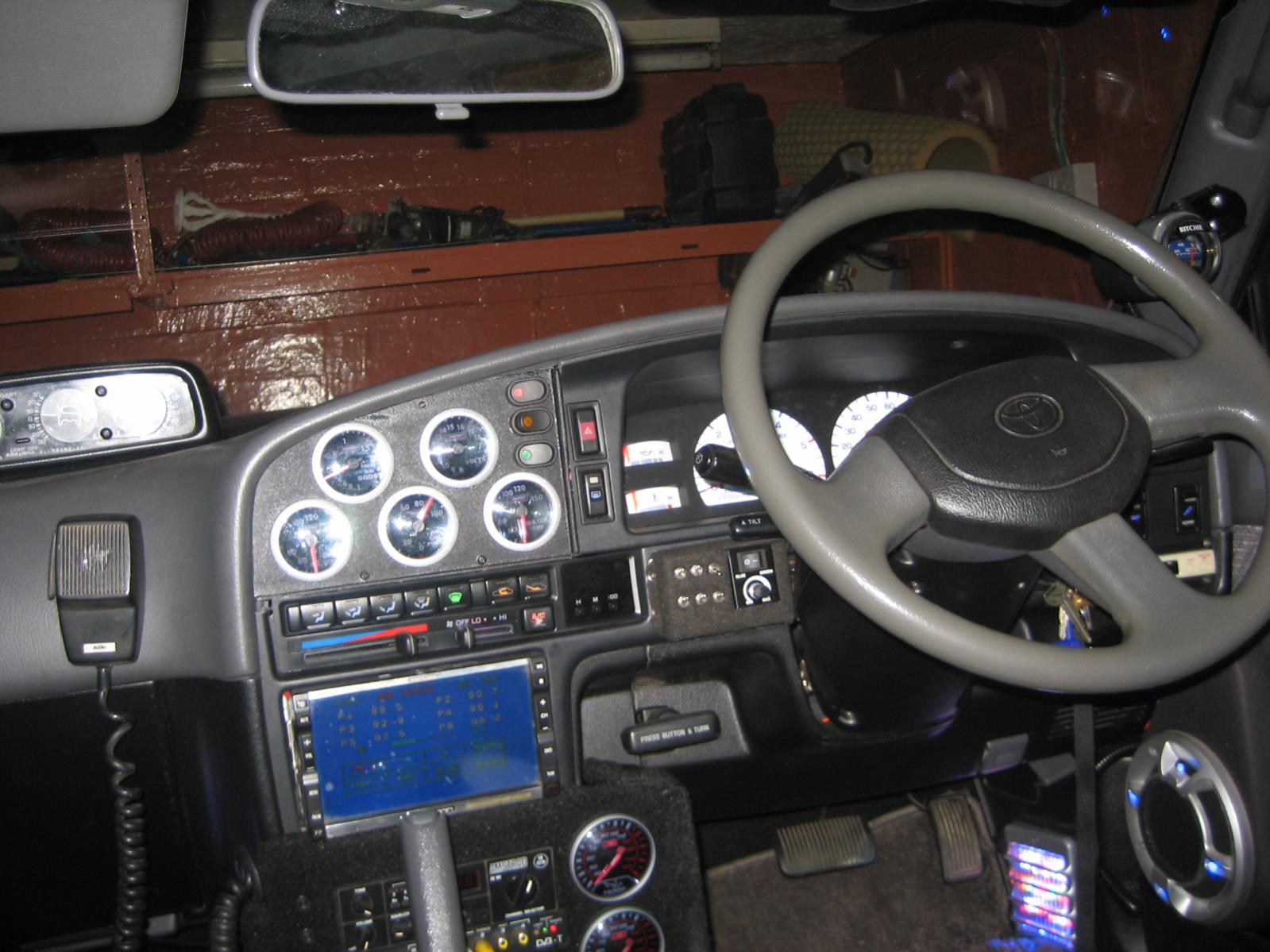

                      Have you tried putting it here? ↓
                        Why would I bin it, only bought it.
                          It was a joke.
                            Originally posted by Sylux View Post
                            It was a joke.
                            I know
                              Thats where i stuck mine
