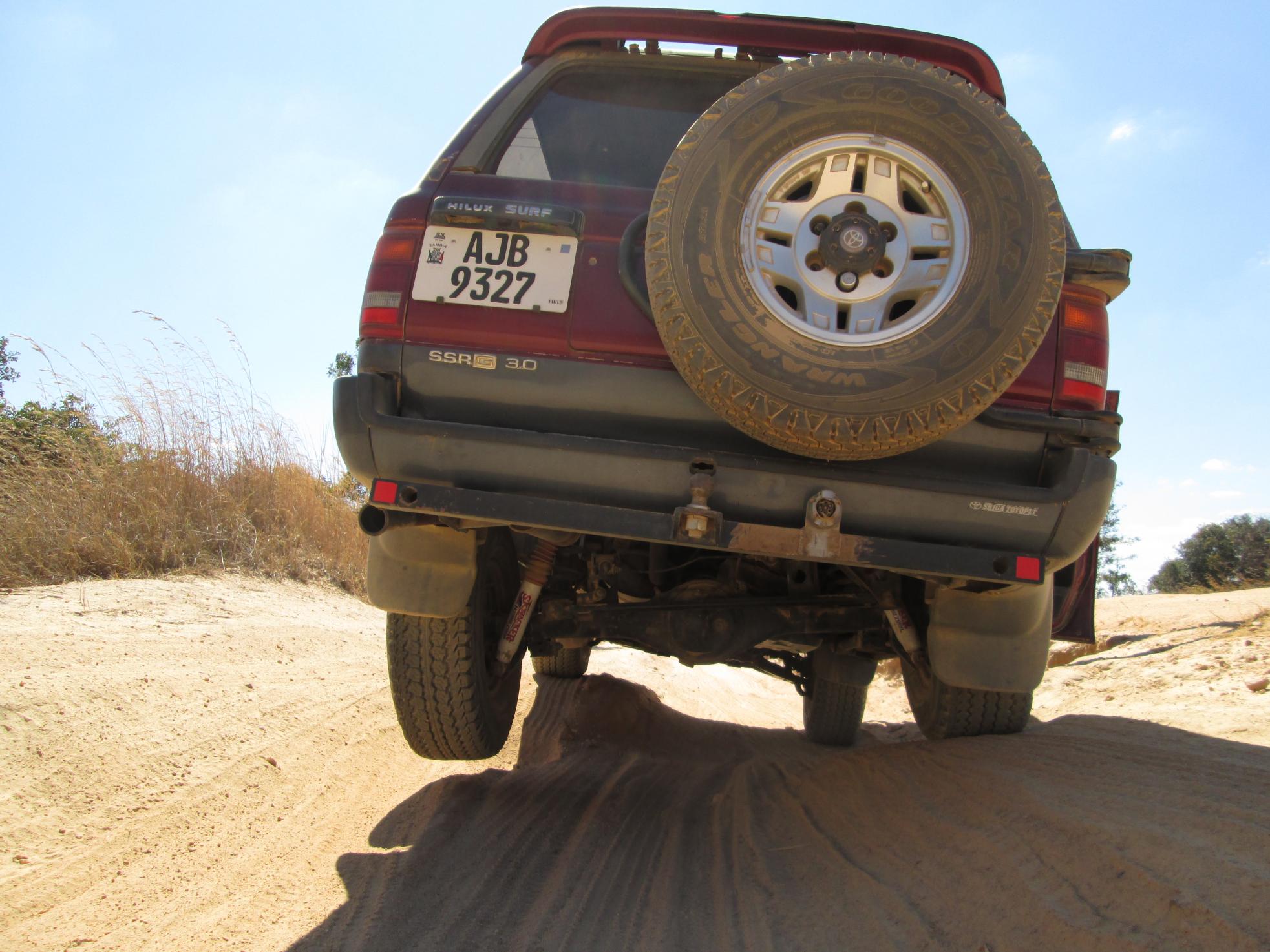

I have lived in Zambia for the better part of the past 6 years working for an NGO. My wife and I are currently running a bore hole drilling operation to bring clean water to remote villages. Our Surf goes with us to every drill site, and has become our part time home as our drill trips usually last a week to 10 days and are usually hours away from modern amenities. We find that it is more comfortable and convenient to sleep in than most tents.
About my Surf:
Over the past year I have somewhat restored a 94 3.0 SSRG after it was left for dead at my organization here in Zambia. She has been affectionately named "Limpo" by co-workers of mine who had the privilege of driving her years ago. Limpo has earned the name after surviving numerous incidents that would have written her off in any first world country.

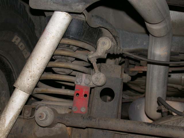

I've owned surfs over here for 10 yrs now, so I can definitely see why you want to keep yours alive!
). Since you have longer LC rear springs, and I'm assuming that those Skyjacker dampers are at least +2", then it might improve your rear braking if you fit an LSVP adjustment bracket. Hope this helps. See pic.
