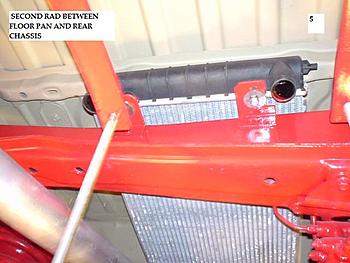

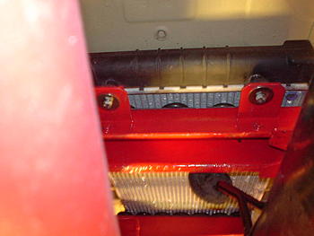

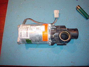

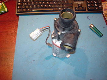

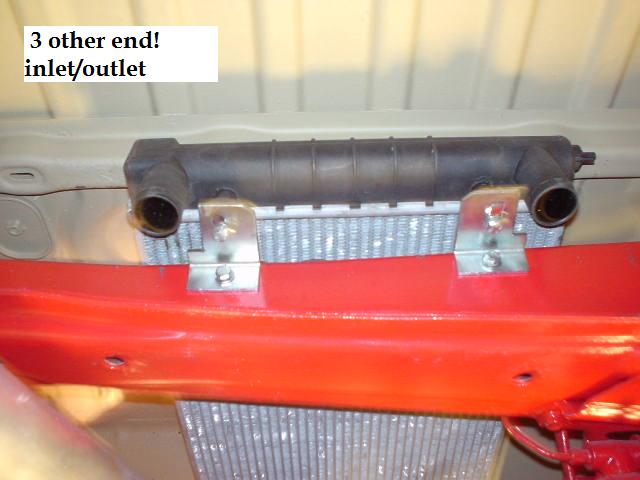

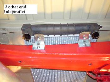

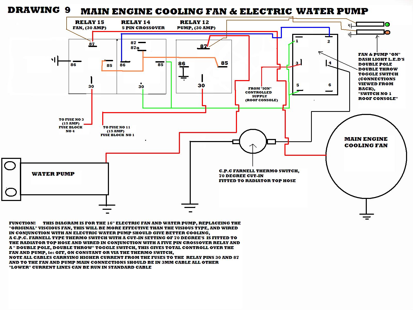

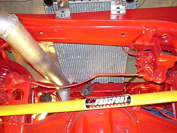

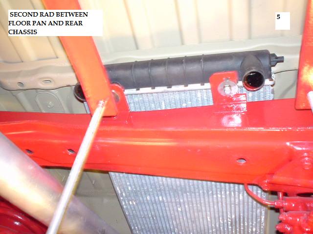

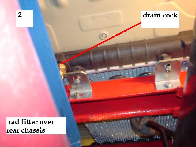

i plan on fitting a rear mounted rad to my surf, will the standard 1kzte water pump be powerful enough to pump the coolant all the way to a rear mounted rad?
if not does anybody have any recommendations for electric coolant pumps i could use?
thanks
thanks
all i intended was being able to push some coolant to the back (and back again)
