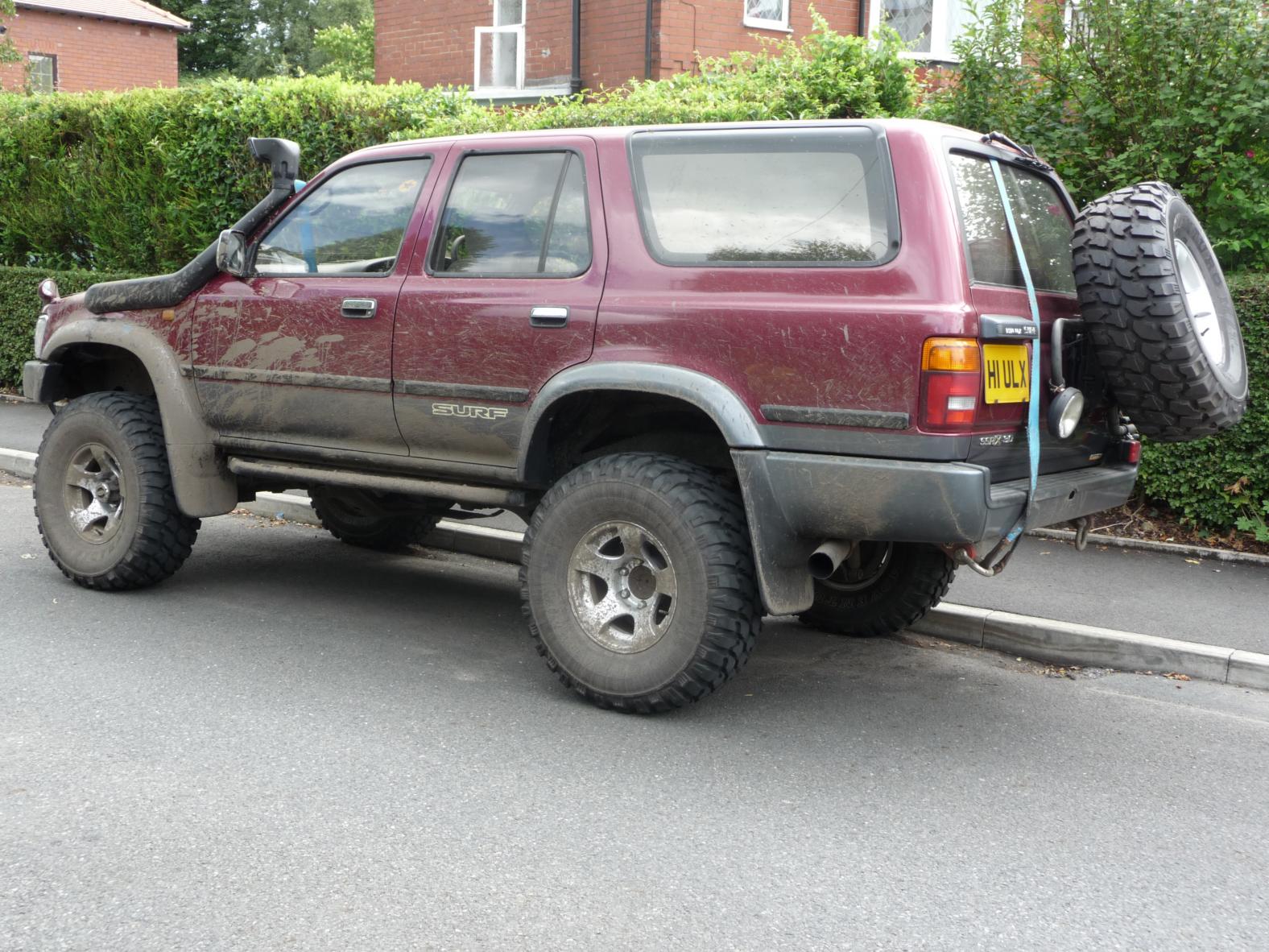

                          • #28
                            Excellent!
                            See how smart it looks?
                            Now imagine those wheels painted grey, they would just blend in with the tyres.
                            Hey Vince. I decided to see how they'd look in a darker shade after all. In the end I opted for a subtle two tone effect..... .
                            " Time wounds all heels ".

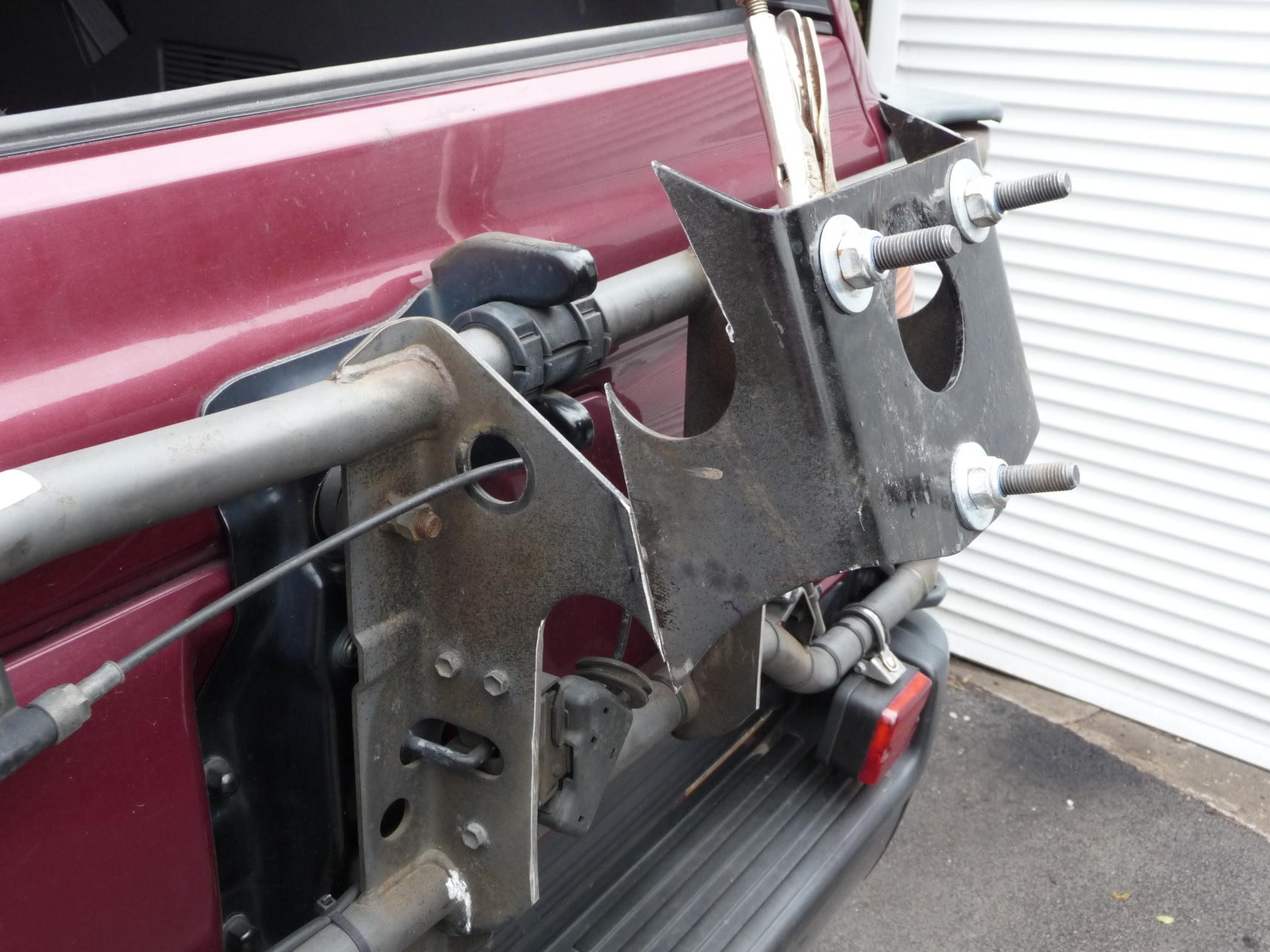

                            • #29
                              I really do like your rear wheel mod. Have done since you posted about it.
                              You and your mate (IIRC) should knocks some up for sale
                              • #30

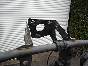

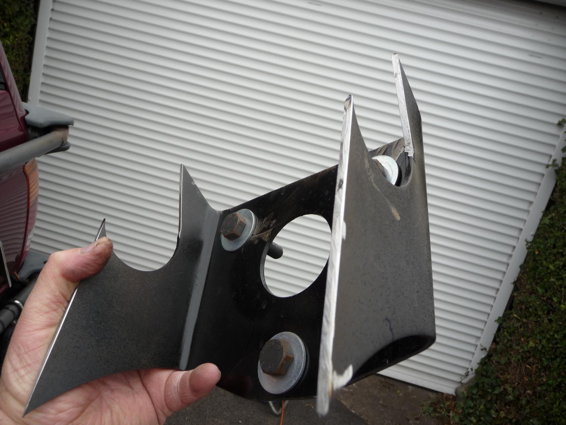

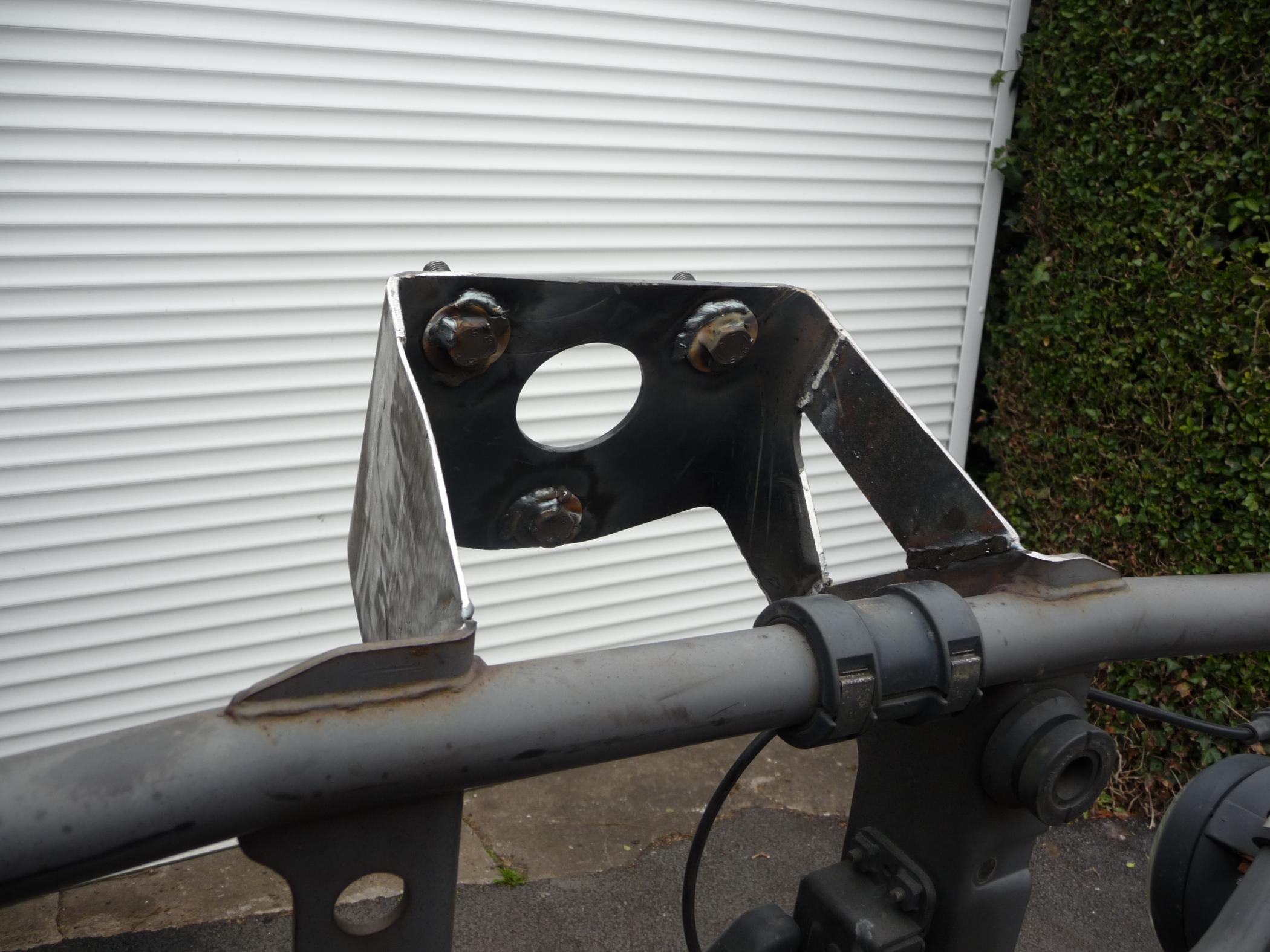

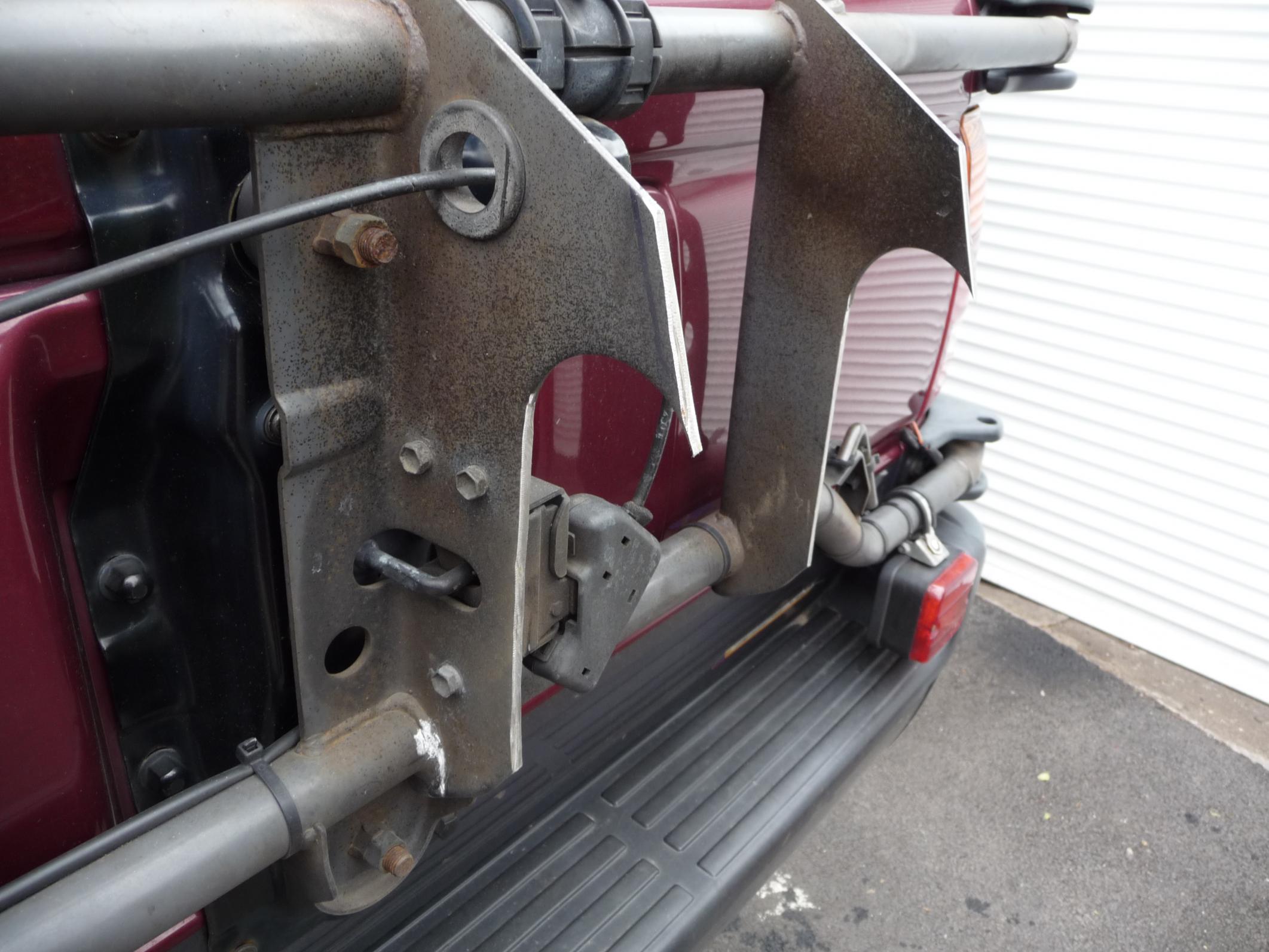

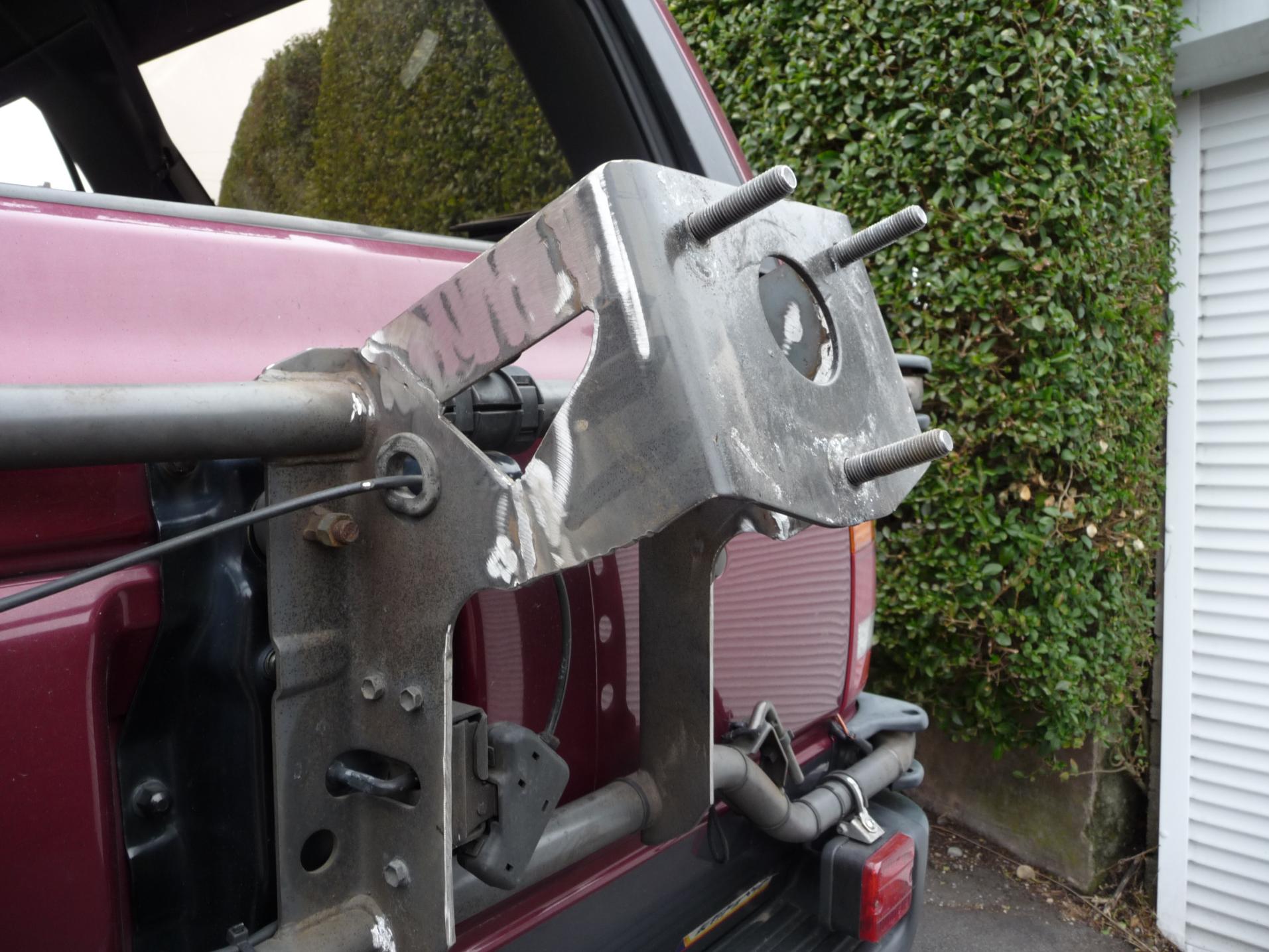

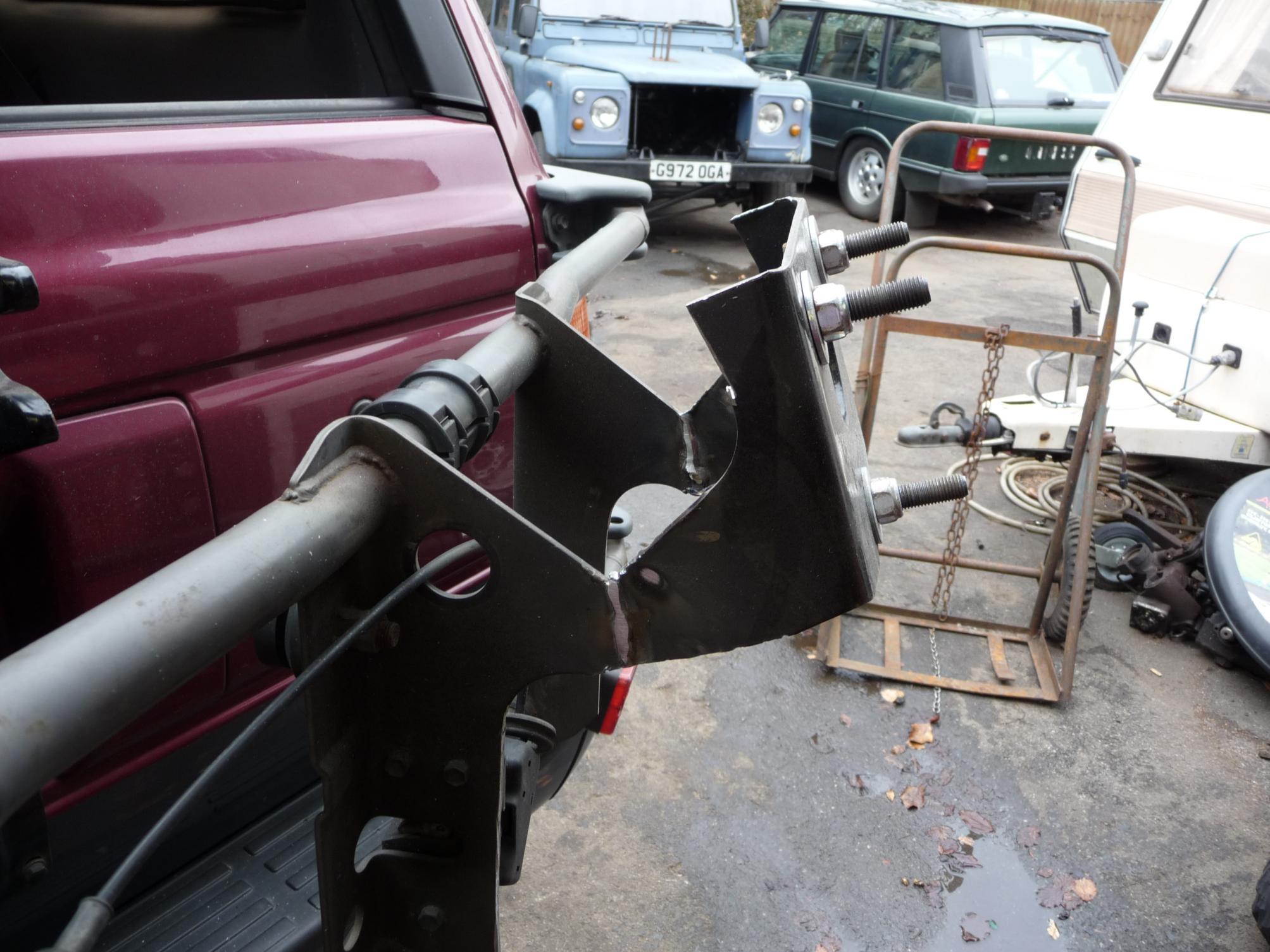

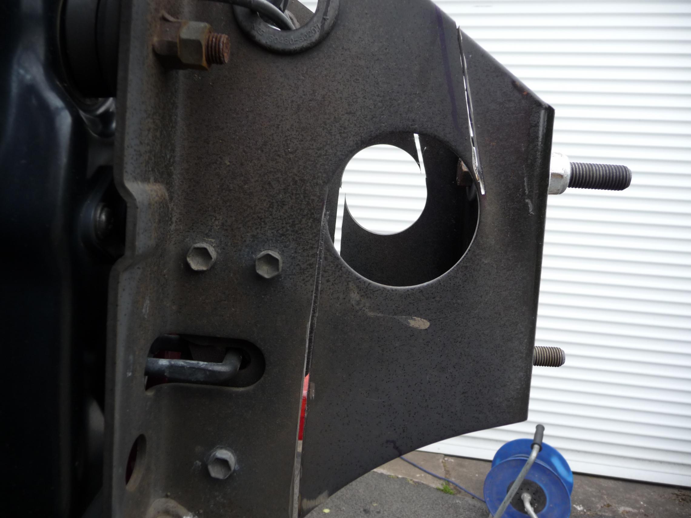

                                Thanks, Sy. It's not really a matter of fabricating anything. It's more a matter of cutting, re positioning and re welding the existing mount. A couple of bits of scrap plate were welded in to fill the gaps. These pic's may help...
