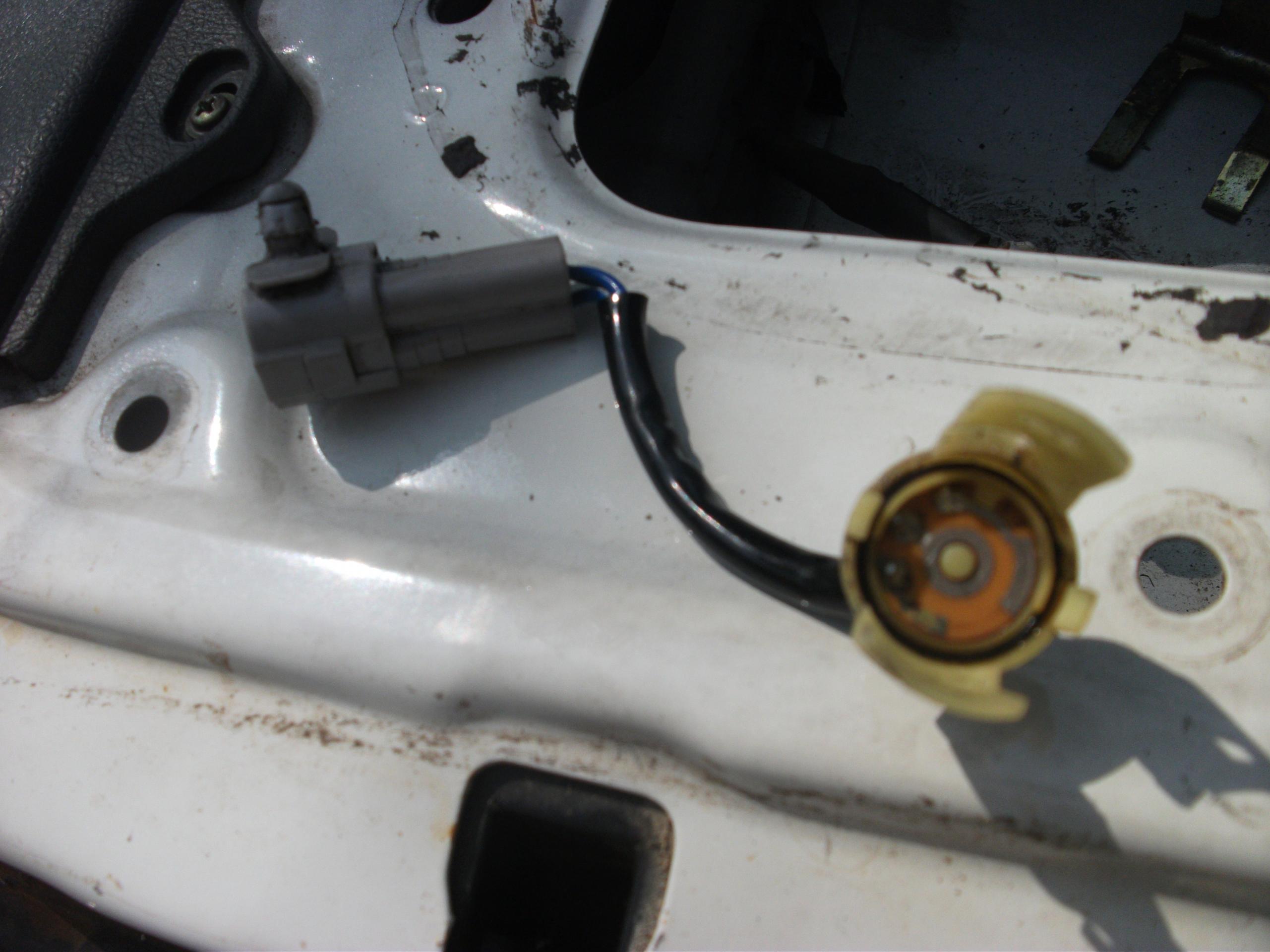

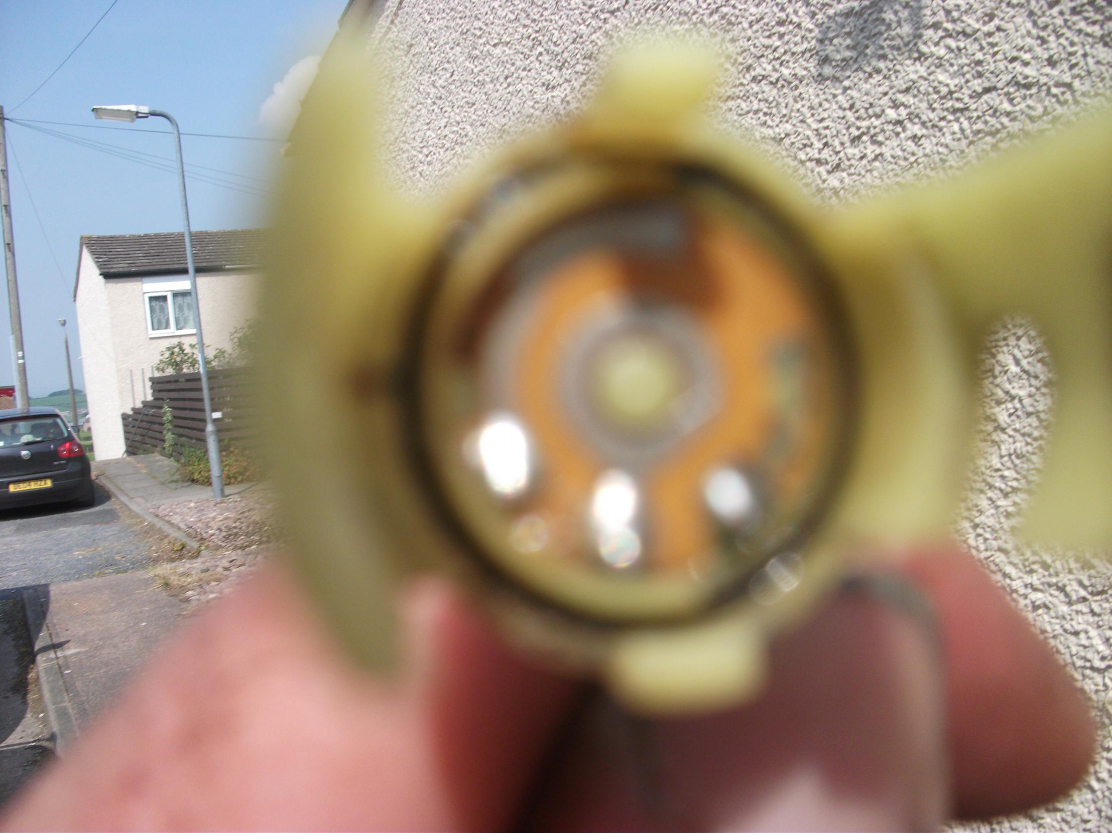

Hi Sylux (and anyone else reading this)
Only today got round to checking the continuity.
Bit of a job getting to the relay box, wot!.
Anyhow got there, all connections A1 OK.
So back to rear door switch , took it to bits and it appears its the contacts on the back of that little plastic disc....see photo.
There's continuity in the wires but the silver contact strip has corroded/worn away on the "down" contact..a bit blurred in the pic I'm afraid.
So next question can I get a replacement part anywhere ??
It's the bit from the door lock barrel to the first connector.
