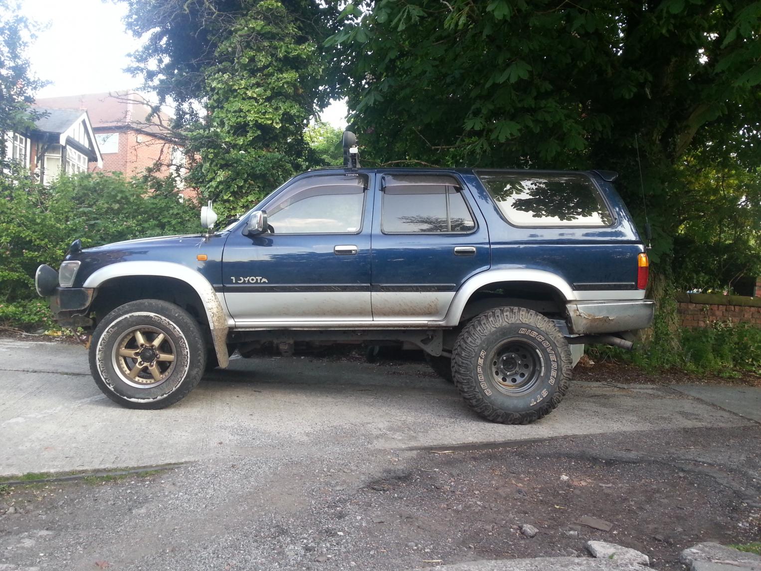

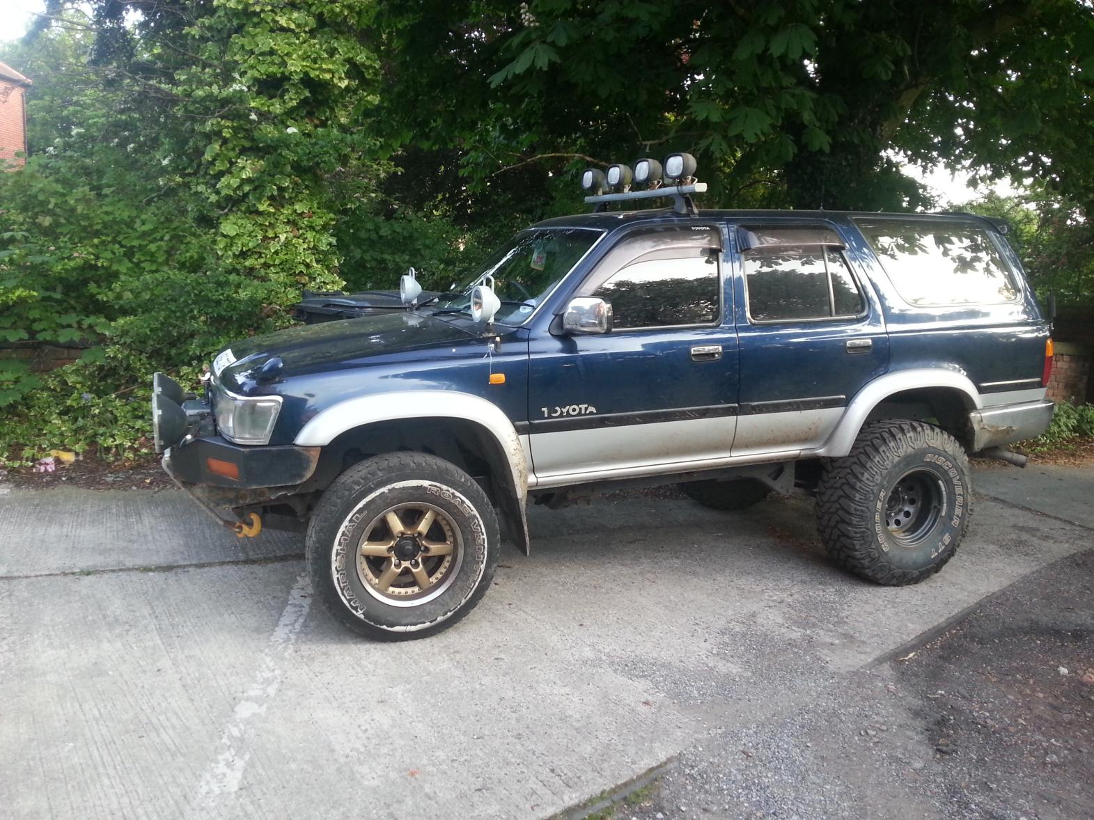

    managed to do the rear suspension for now! drives great but gets a few funny looks hahaha! i`ll do the front at the weekend but not sure how to do it!

    Lift the front so the weight is off the wheels and wind the torsion bars up.
    Or fit ball joint spacers.
    Or you could spend some cash and fit a proper lift kit which would keep CV angles.
    Most however choose option one above as it's free
        Will the 35s fit on the front ok with the free option?

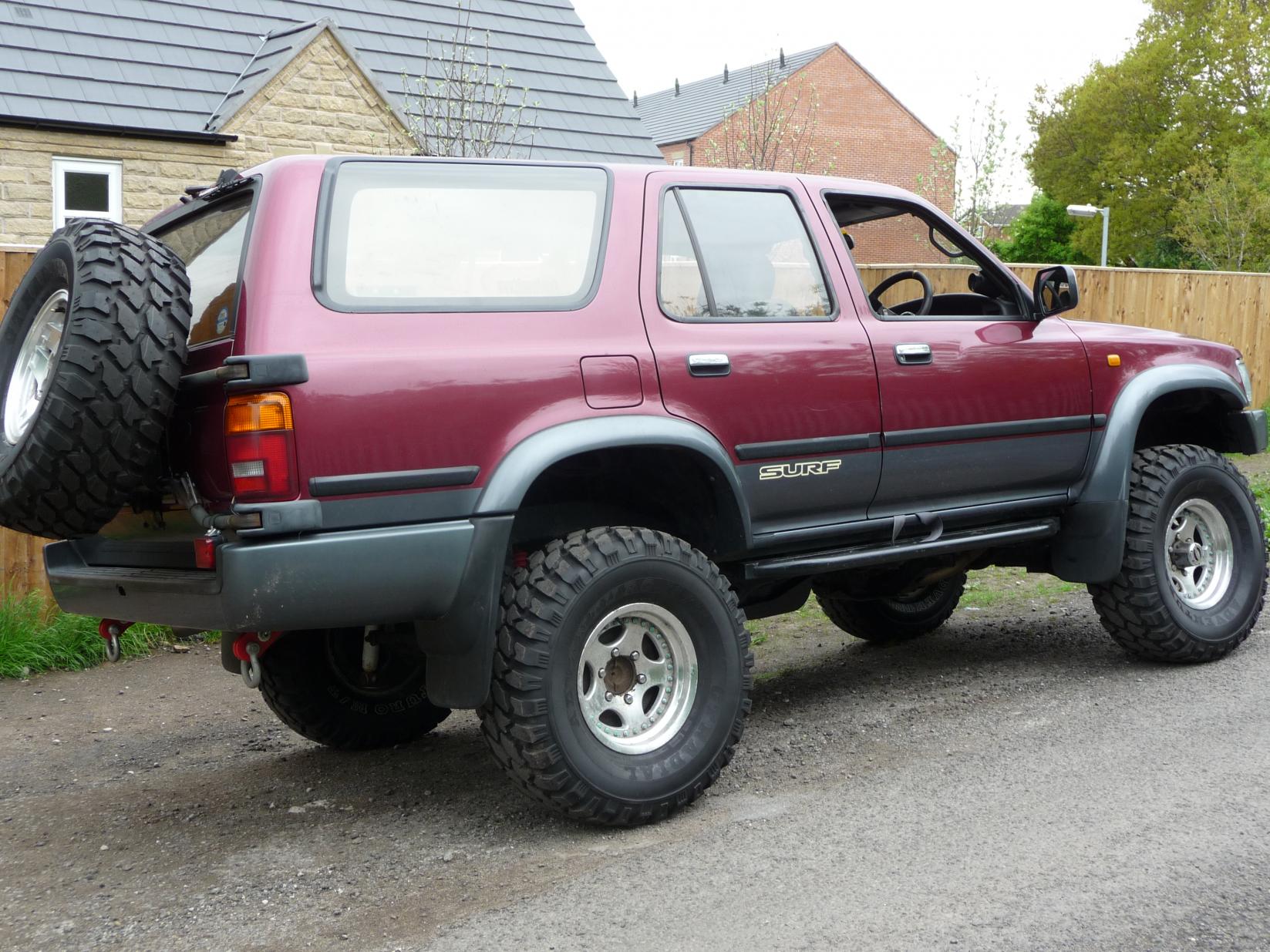

            What car donated those rails?
              Mine were from a Peugeot 406 estate.
              There's a write-up here about fitting some rails....
              http://www.hiluxsurf.co.uk/showthread.php?t=33499
                      unfortunatly not you will have to put a 2 or three inch body lift on before you can fit 35s
                              winding up the torsion bars is quiet easy but its recommonded that you only wind up 1.5 to 2 inches
                              i put uprated springs new shocks and a 3 inch body lift on mine without any hassel and im a carpenter !!
                              i`ve fitted a 2" body lift and i`ve just bought a donor car that had the 35s on, i`ve taken the bigger springs and shocks and fitted them to the back of mine so all that seems ok with loads of room with the 35s on! i havnt got a clue what i`m doing! i`m just fitting it to my truck the way i take it off the donor truck. i`m doing all the work on my own and i`ve lost a bit of skin on my knuckles and a lot of efn and blindin! i managed to do one side of the front this afternoon and found it had 5 metal plates above the ball joint about half an inch thick each so i guess thats a 2 and a half inch ball joint lift! so i`ve managed to fit them to the left side of mine with the extended brake lines. i`ll try the right side tomorrow then fit the wheels and see what the clearance is like!
                              can i still wind the torsion bar up for more lift with the ball joint spacers?
