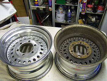

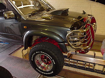

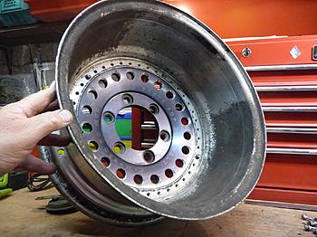

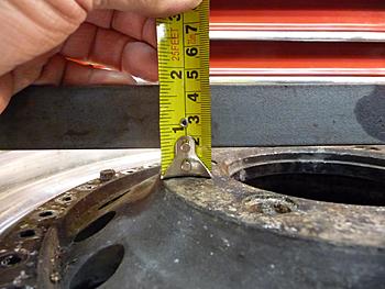

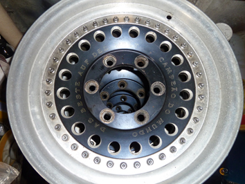

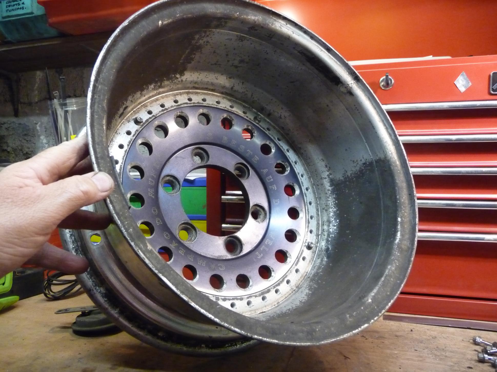

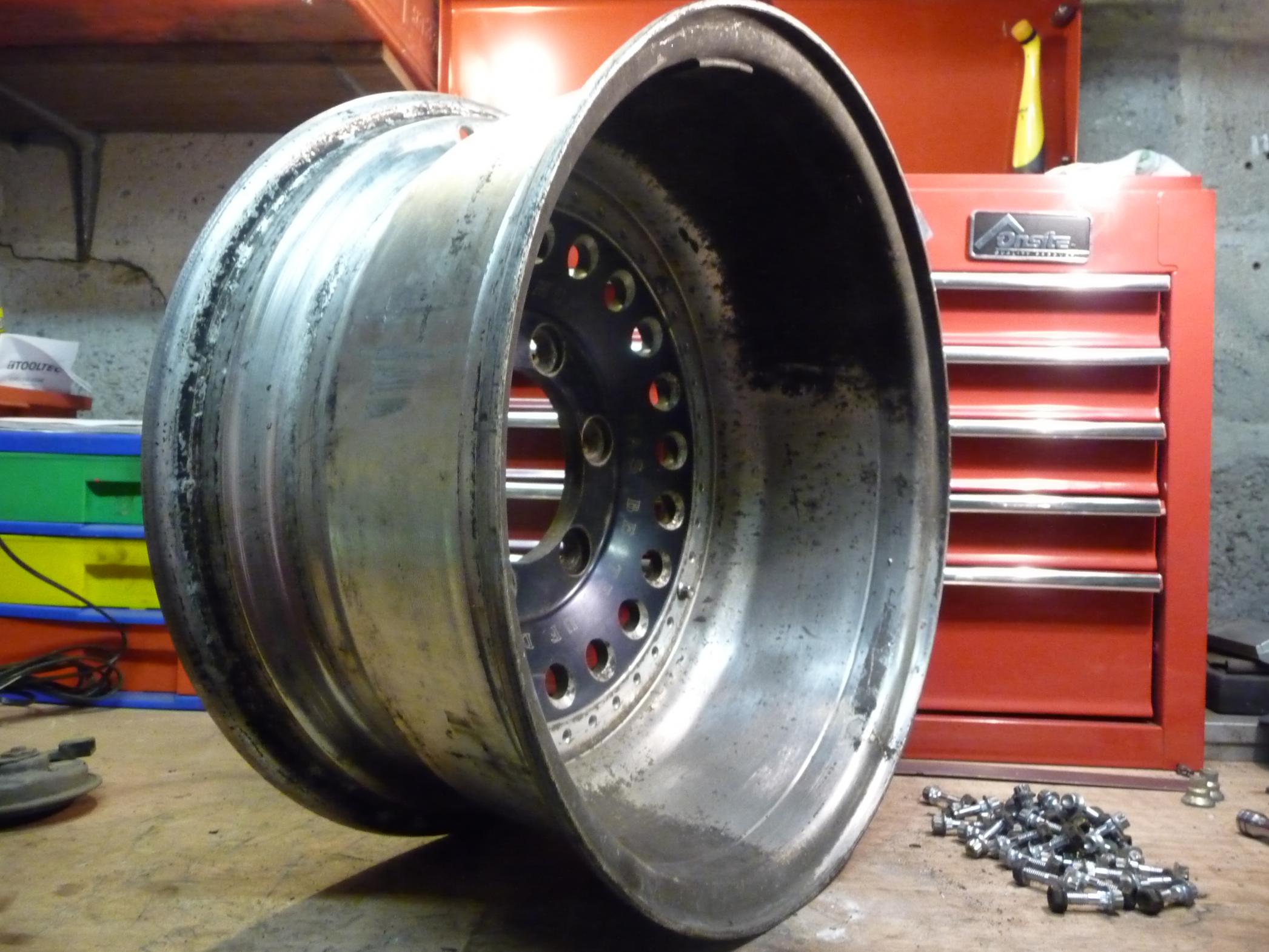

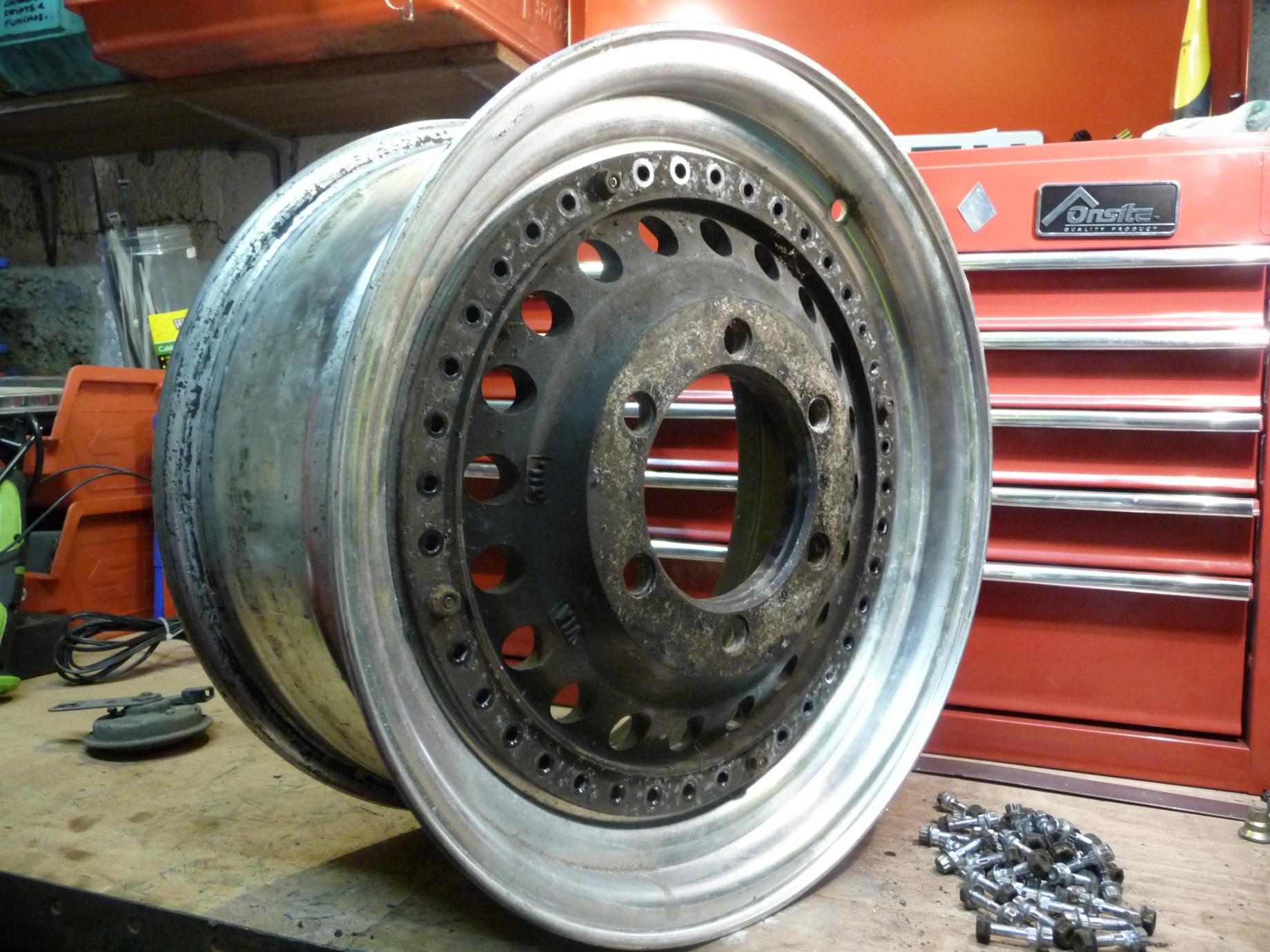

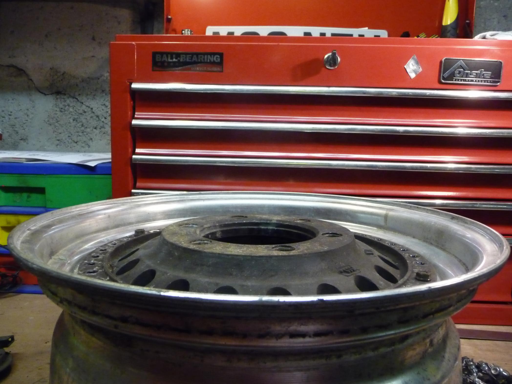

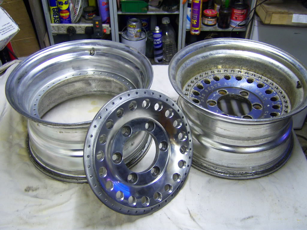

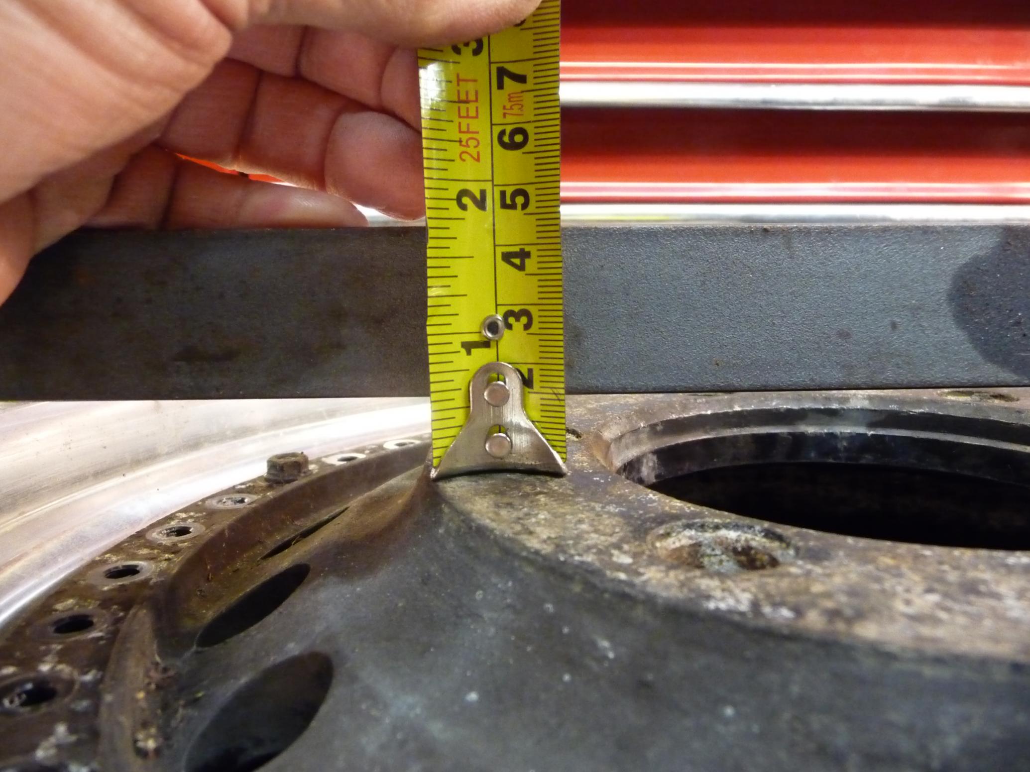

Does anyone know if there's a maximum legal offset allowed on wheel rims for use on the road? I'm aware that a much more extreme offset will put much greater cantilever stresses on the wheel bearings etc. I'm planning to reverse the rims on a set of two peice alloys. The first three pics are what I plan to do, and the last pic is one of the rims that I was hoping to reverse.... Thanks chaps.

They'll look like this with 33"s on Mick...

Thanks Vince. I thought as much. Pity, cause they're a full set of five. Guess I'll just rebuild to standard and get rid of them. THE SEARCH FOR A MATCHING SET OF FIVE DECENT ALLOYS CONTINUES !Originally posted by BUSHWHACKER View PostNot good. They will kill the bearings in no time, plus the steering will be very, er, interesting.

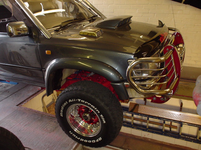

MWS I have -43 offset which had wheel spacers. I think they are 30mm? Which makes it -73 offset equivalent. Steering was a bit oo-err but it looked nice. Removing the spacers, truck drove completely different.
Also I got pulled over and I had to remove the spacers to be able to go back on the road.Oh Nana, what's my name?

Thanks Ian. I did read both yours and Vinces write ups on reversing rims. The problem with the ones that I tried to reverse was that there was virtually no back spacing at all, placing huge cantilever forces on the wheel bearings etc. I do like to go off road a bit, so they weren't worth risking. I'll just keep looking for a matching set of five 8x15's with a sensible offset and back spacing.Originally posted by POPEYE View PostFor what it's worth i reversed my rims several years ago and have had np problems, However i dont do "off road" and am a pretty low milage user,
