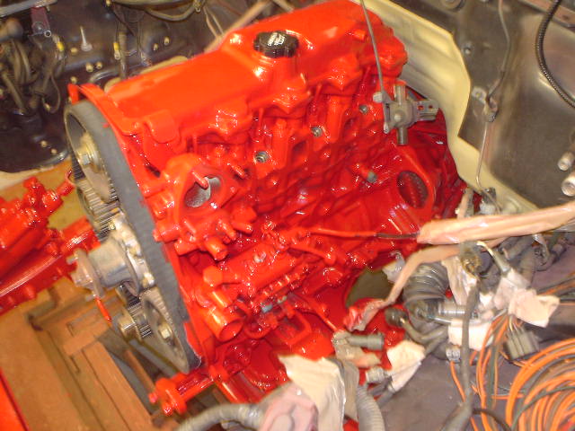

            I cleaned my engine up while it was out, used some VHT black paint, its not a nice matt OEM finish. It stuck really well and dried in 10 minutes.
            I was going to paint it some vibrant colours but decided the factory look would be better in my case. Will have some pictures up tomorrow if I can get her started which is the plan.
              Hammerite smooth red has lasted on mine, although i do like the BBQ look,
