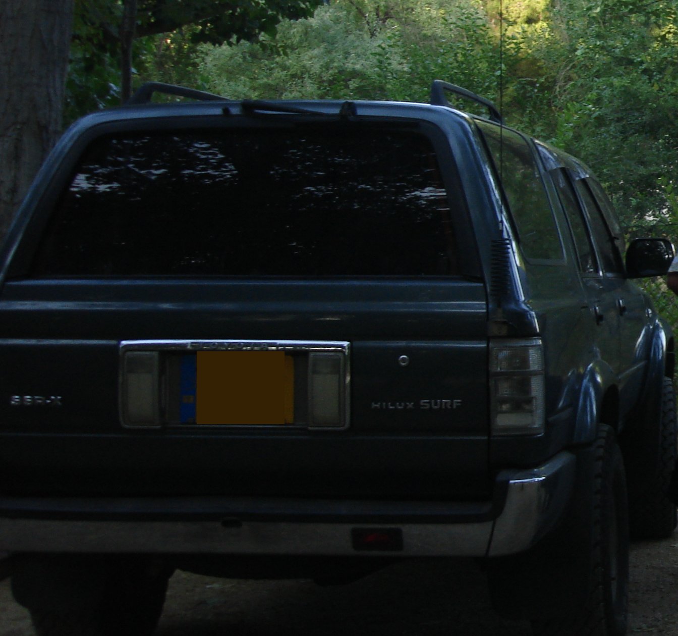

    The back on the wheel carrier is one of the worst places for an antenna if range is important to you, even if it does look good.
    Somewhere on the roof is better as you'll get a better ground plane. Either way though, you should get a couple of miles.

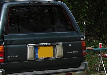

      I used a firestick door jamb mount on my old 2.4 - yours with enough cable to run to the front for a tenner delivered
      It fits between the side of the tailgate and the rear lights.
      If you go for the ebay one make sure they supply at least a 6 metre cable. I've just bought a new mount with cable for my rear wheel hanger and the 5 metre lead isn't long enough.

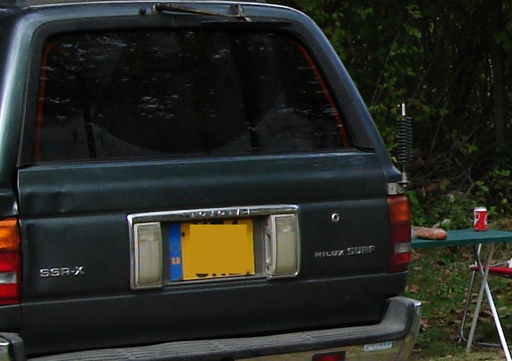

        Hope you we'rnt having a nude barbeque when that photo was taken!!!!
        (Look on the table)
        Gman.
        If it aint broke, keep goin' till it is.
          That's made me laugh !
            (Look on the table)
            Gman.
            what is that?!! on the table.
            and that ariel looks ok on the back, did you get good range with it there? as i dont wanna go drilling holes in the roof if i can help it,
            thanks for the offer. if i get one i think i'll take you up on it.
            have a good xmas all
              It's a french stick and a can of Kronenburg on the table
              I was happy with the performance of the aerial mounted where it was. Not sure of range as only ever used it off roading. My new aerial is even shorter than the one on the 2.4 and it will be fine for what I want it for.
                Lol @ the nudist.

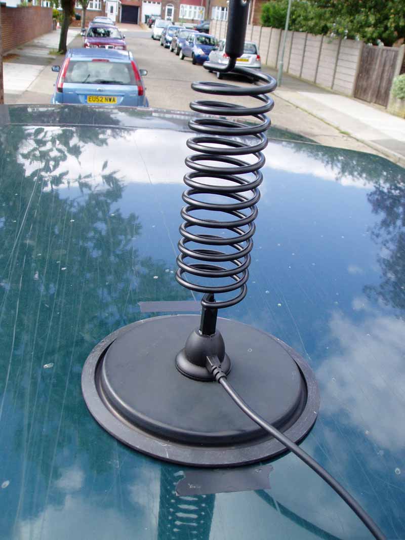

                    Swap you my mag mounted, 6' whip for yours Mick?
                    Similar to this.....
                      If range is important you can get artificial groundplane mounts to help out..
                      Mounts
                        dont fancy a magmount vince, i couldnt be ar*&^ to keep putting it out. but it looks a nice one though. though i will look into driling the roof if its as easy as apache says.
