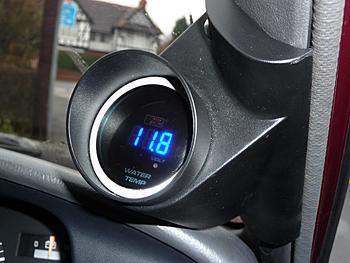

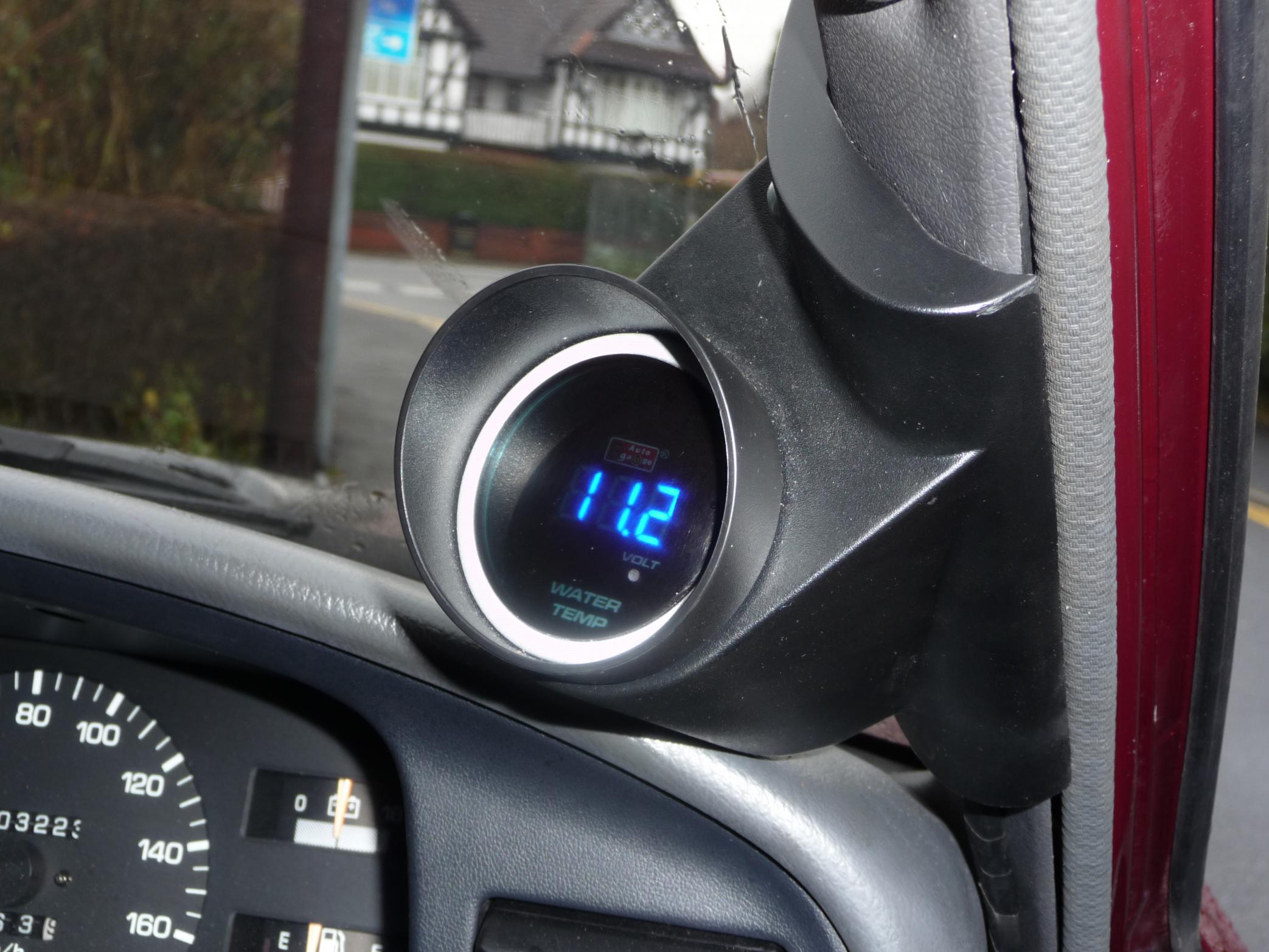

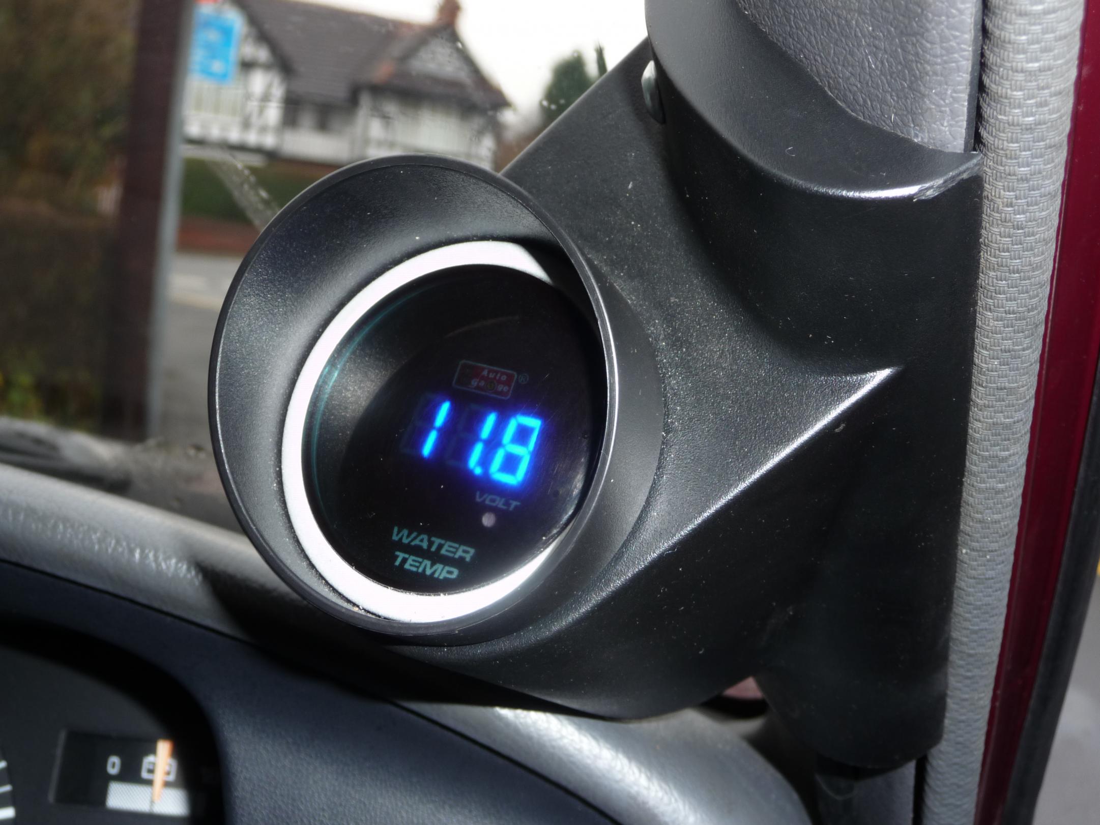

                            Hey Dave. Here's a couple of shots of it, fitted. Actually, I'm not happy with the fitting. It's too obtrusive. I think I'll trim more off the gauge pod, and possibly splice it into the "A" pillar trim. .......As a post script to my running temperature issues, I took it for a run on the motorway last night, to get it a bit hotter. Guess what ? Temps actually dropped. At 70 mph, it was running a constant 65 degrees. It was only when I came off the motorway that temps started to climb. Maximum, though was still only 73 degrees. Guess I'll have to accept that for this time of year, and with the mods that I have, I've just got a very cool running motor.....Anyone got any further ideas, or comments, please?

                              Like it
                              One question is the display ok at night?
