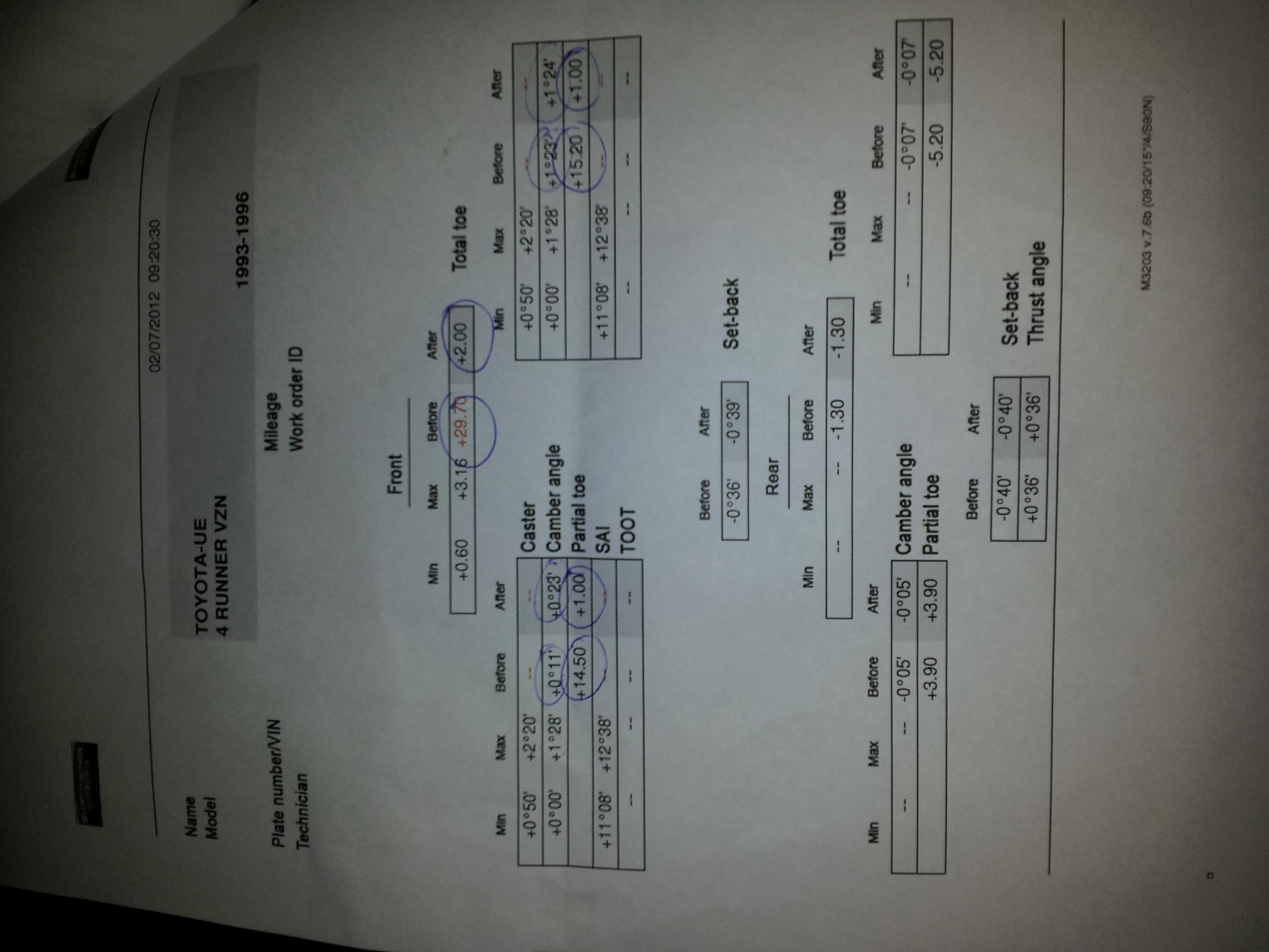

I've just this week replaced a lot of front end steering/suspension parts and also fitted a rancho steering damper from roughtrax.
I've not been far since all the work but I'm finding the drive a little strange, the truck turns in a lot better and the steering is more responsive in general (new idler and pitman arms fitted, lower ball joint and new wheel bearings), the problem being (if I can figure out how to describe this right) the steering doesn't seem to self centre any more, it will to some extent but it won't find straight ahead if you like, meaning both hands on the wheel at all times to keep it going in a straight line, motorway driving is a constant series of corrections leading to an unnerving weave rather than the steering finding its own path and you just keeping it there.
I've reset the tracking, done all the tyre pressures but none of this has helped. I'm hoping that its just down to everything being tight again and will loosen off in time but I'm worried that it may be down to the uprated steering damper.
