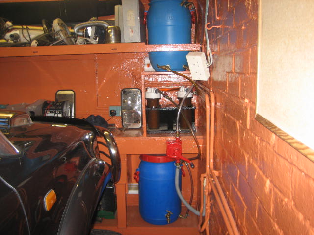

        For used oil i'd let it settle for about a week, then filter through a pair of greenteam filters, first one with a 10 micron element and a final with 5 micron element, if you have a regular reliable supply then its worth buying these filters and a couple of large cans and plumb it up properly (i used a pair of those blue mango chutney barrels i got from an indian resturant, they hold about 10 - 15 lts
        ment to add filtering it through cloths etc is a right pain and you cant help ending up in a sticky mess and it takes forever

              tried getting tubs like that but can't seem to find any, plus dont have much space so doing about 10ltr at a time, filtering that is then leaving the filtered tubs to settle before mixing in either petrol or white spirit.

                  got some nice tubs now with taps on the so i can filter it to 5 then 1 micron. should all be good then. already have spare fuel filters.
