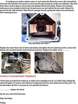

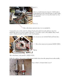

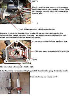

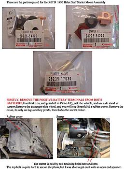

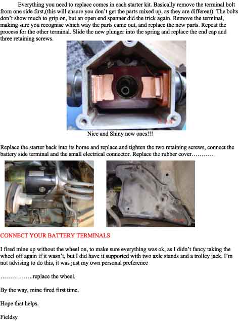

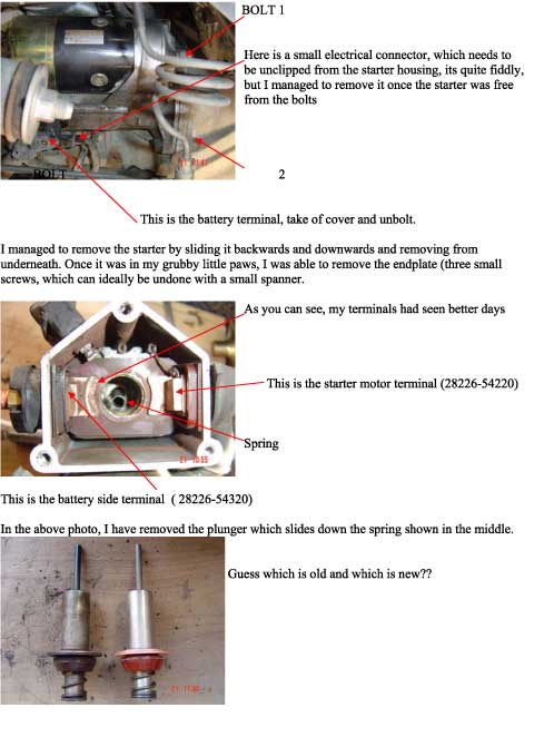

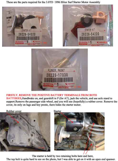

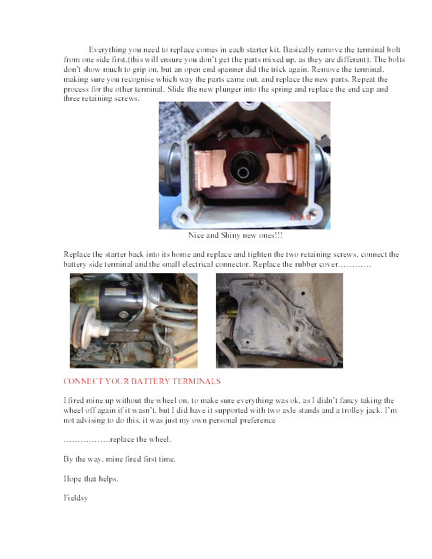

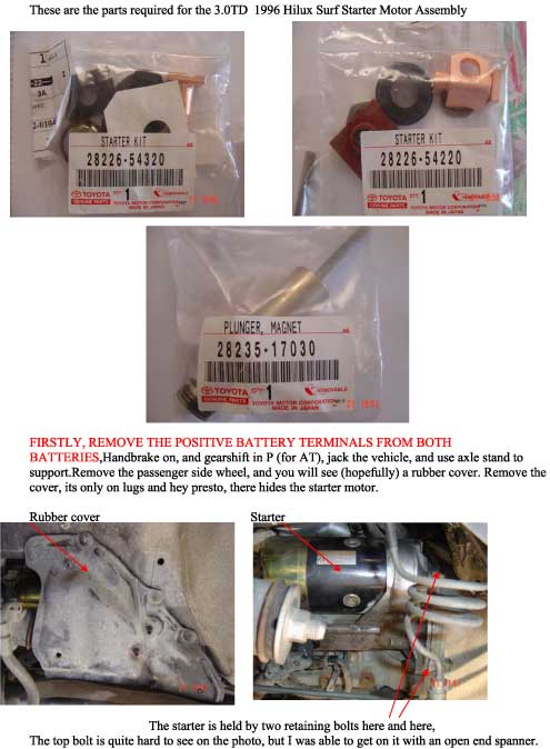

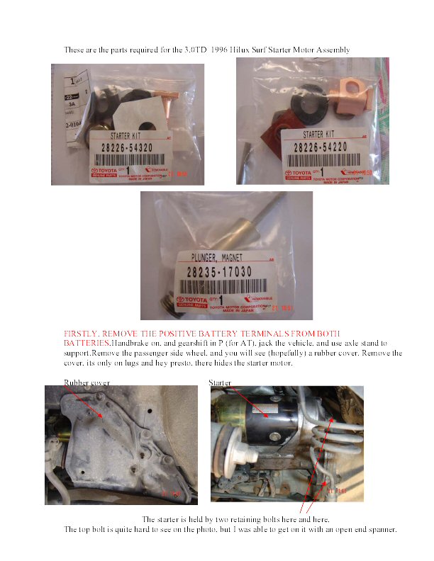

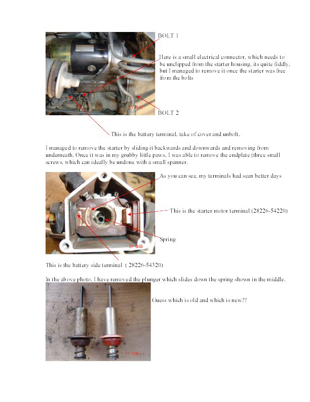

I've made a little tut for it, hopefully it hasn't already been done on here, as i know there is a link to a 4runner, but if it has then sorry
I've made it in .doc format and also .pdf format, but unfortunately they are toobig too upload, so I've converted to jpeg, hope they come out ok
