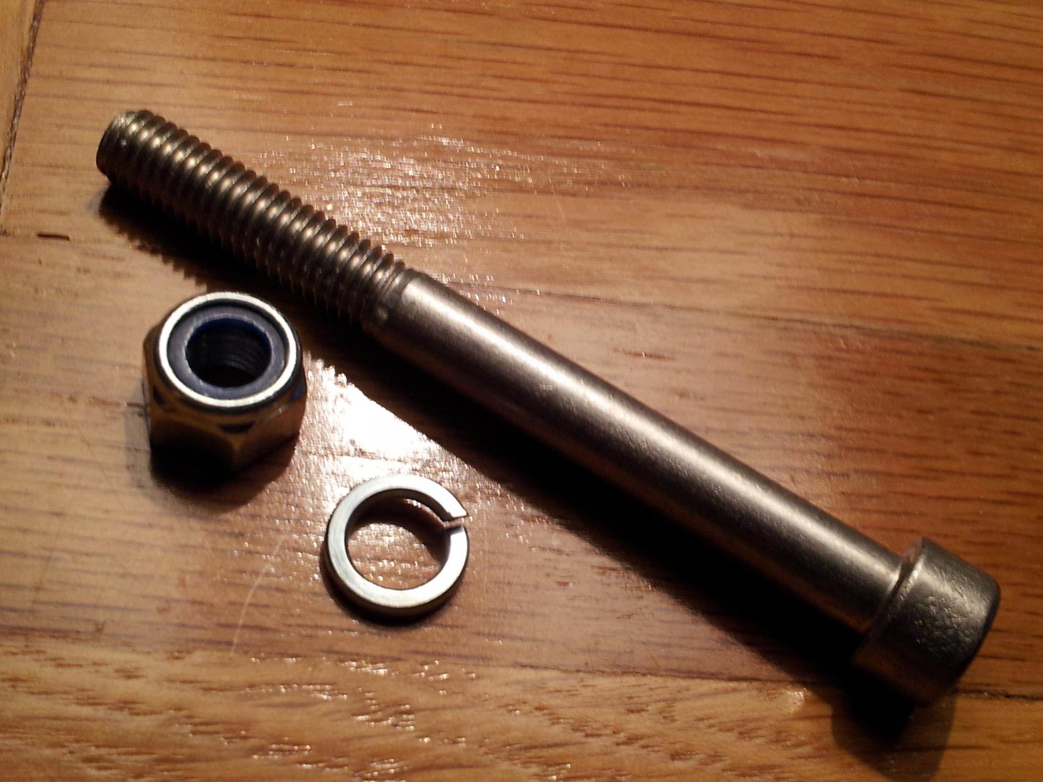

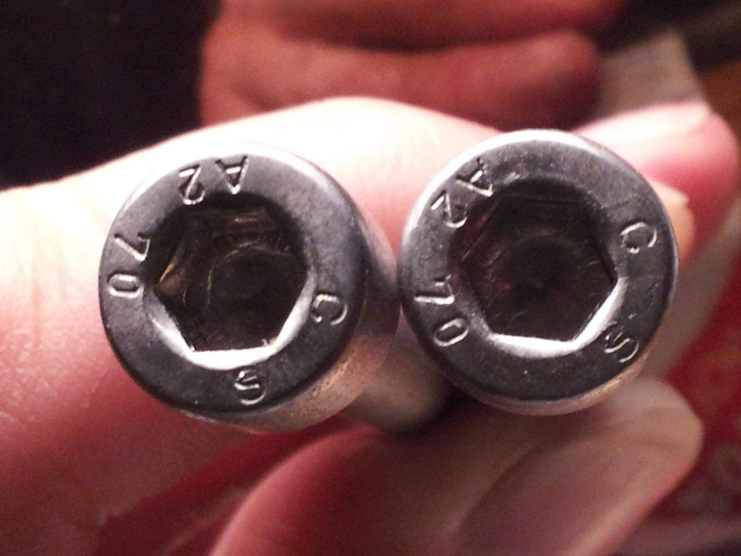

                Thanks for the info guys. Got these the other day from our local bolt shop... they only had stainless steel... shows 70 on the head is that the strength rating?

                  "Both A2 and A4 grades come in three property classes: 50 (soft) , 70 (cold-worked) & 80 (high-strength) – the most common of which is the 70 class which is cold drawn” from bar stock"
                  Taken from here
                  Looks like you need to go up a grade John
                  Might be worth giving these guys a call
                  I can collect for you if needs be so long as you can wait a few days

                        Don't use stainless. Get steel in at least an 8.8. Stainless bolt with stainless nuts of same grade will cause galling if a suitable lubricant is not also used.
                        http://www.google.com.au/url?sa=t&rc...CeIlNw&cad=rja
                        Nev
                        • #42
                          Agree with Nev there, stainless is a big no no for steering and suspension parts.
                          I had a look at work today and 10.9 seems to be the standard bolt strength for steering/suspension, the one`s Growler posted the pic of look pretty much spot on, if you can find similar you wont go far wrong, just be careful when you tighten them up the more tensile strength a bolt has the more brittle it becomes, read as if you over tighten it will snap, and not necessarily when you tighten it!
