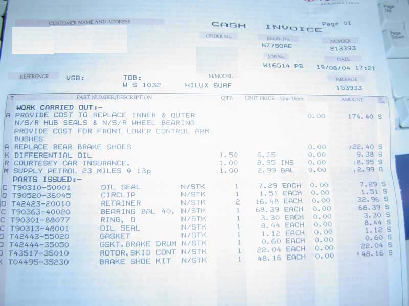

£483 on rear wheel bearing and seals? I've not done the job and dont really know much about it but Milners do a rear wheel bearing, rear inner seal and rear outer seal all for £17.50. Is there more to this???
Not really Jim, just Toy dealers being !!!!!! expensive. Oh and that 3rd gens have abs which 'apparently' makes the job more difficult and requires extra parts. From what I can tell, the dealer cuts off all the stuff from the half shaft rather than spending hours trying to pull it all off. Here's the bill (without the Vat added).
