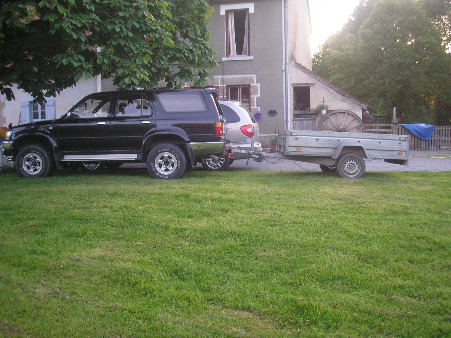

    Following my suspension lift,my trailer has been pointing skyward,and when loaded only had about 2" clearance,so I gave it a body lift. I used some longer bolts and 50mm of gas barrell.
    Just thought some might like to know it's an alternative to a drop plate(and much cheaper)

    As long as you don't keep the spare wheel on the top it should be fine.
    Alan
      So when are the 33"s going on?
