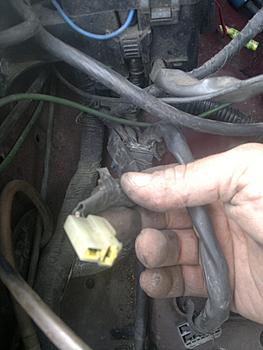

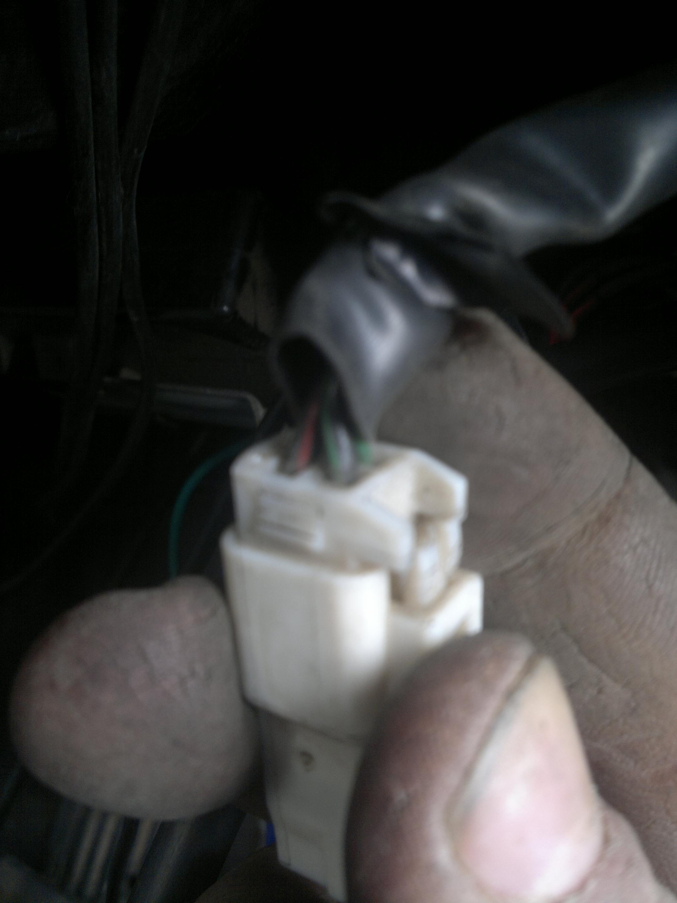

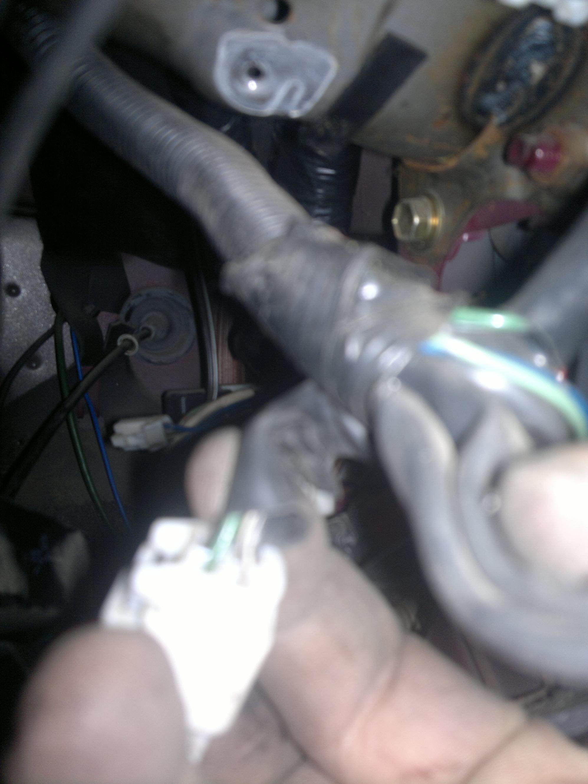

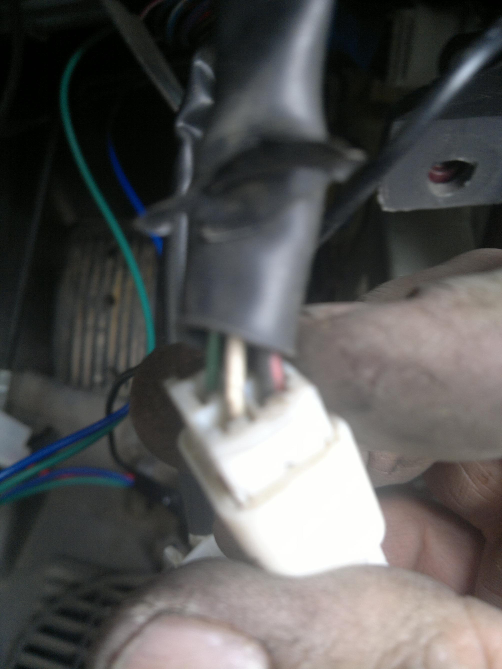

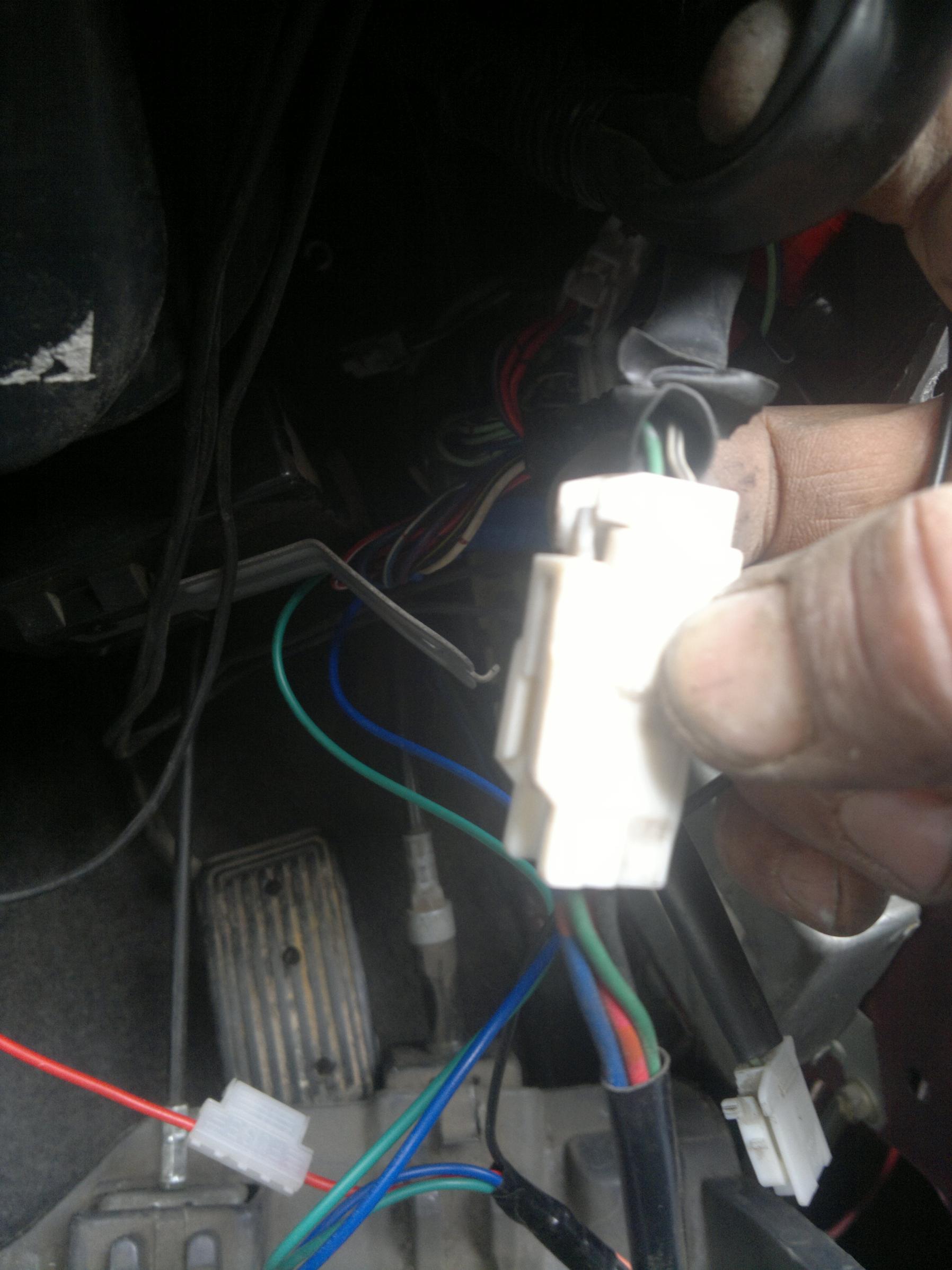

    i didnt know there is a factory ready wiring loom for front fog lamps,
    took this pics while i took it off a scrap one (2.4) to be fitted on my 3l.
    the first 4 pics are behind the driver speaker, from the same loom it comes the cable of the speaker,
    from the centre console took of the switch follow the cable till got to a relay, then to that connection you see on the pics,
    then, on the front followed the cables from the fogs till behind the battery under the fuse box (see last pic) disconnected that joiner,
    and just connected to mine and all works fine.
