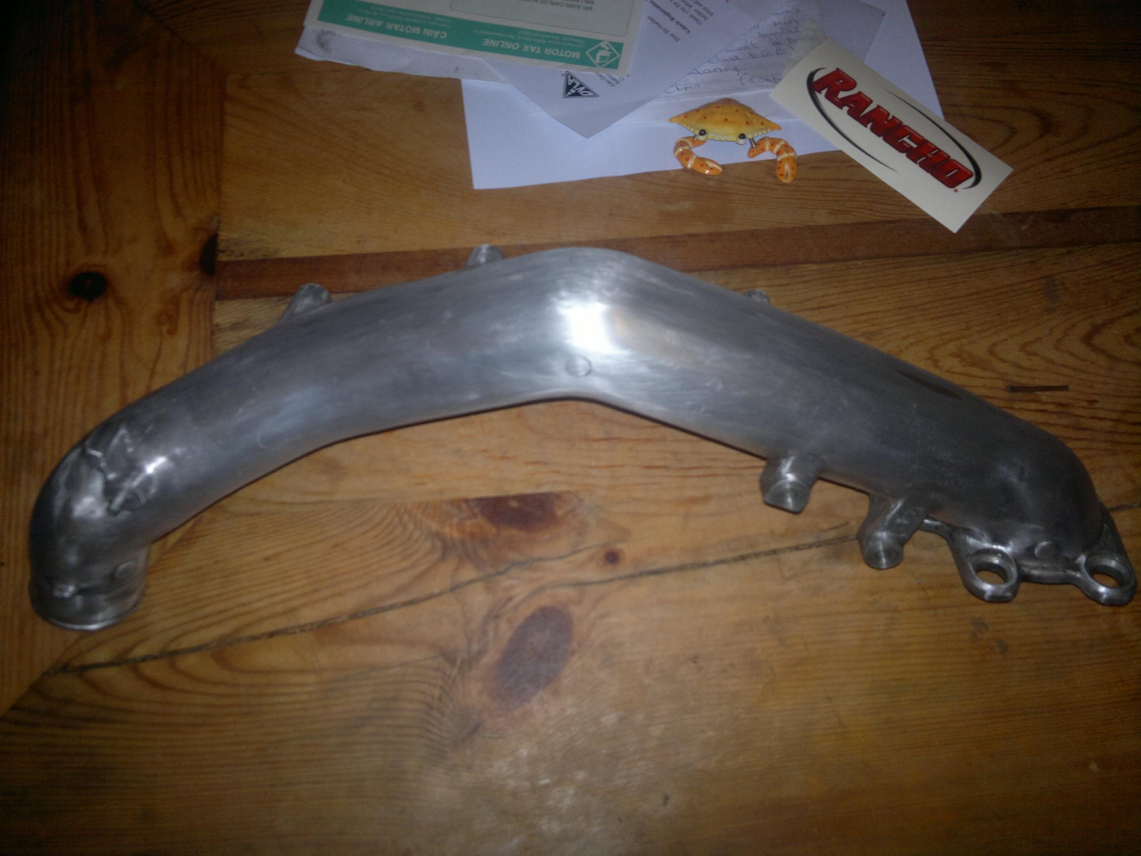

    nearly finished polishing this pipe, and wondering what do you use last to keep it shiny for longer, a coat of clear lacquer? thanks

      The only product you can use onec it's polished is Autosol. Engine heat will discolour and flake off any lacquer you spray on to it.
      Just give it a another coating of Autosol every time you wash the truck.
