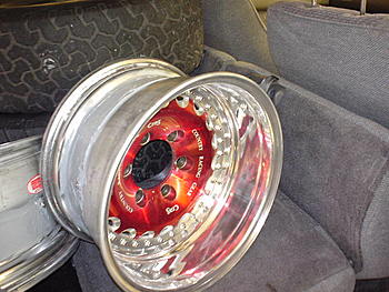

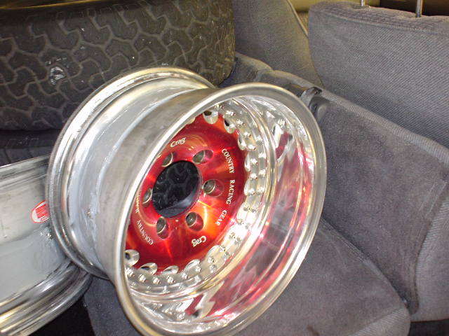

Originally posted by MWS View PostHello Jason. If you decide not to use them, I'm looking for a set. Are they anything like these?...............
Originally posted by Long way 'round View PostThat's them, mine are in dark blue. I've only just got them off of eBay for £185 for all five. They just need a polish around the outside otherwise they're in good condition.

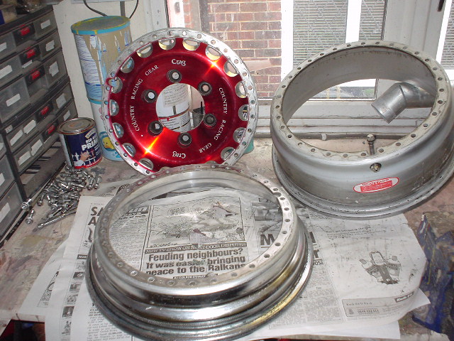

I recall a thread some time ago where Popeye (I think sorry if wrong Ian!) split his rim. Even though he was only removing the centre piece, separate from where the tyre is mounted, it deflated with pressure. It's vague, may be I dreamt it.Oh Nana, what's my name?
Yes it was me! mine are three piece rims, which i reversed so the wider part was on the outside, i believe there are two piece rims but never seen any, you need to let the air out (unlike my first attempt, nearly blew my head off)
and get the tyres removed as you will need to spread a quality sealant on the mateing faces when you re assemble them, worth the effort tho polishing them,Too young to die and too old to give a toss
Originally posted by POPEYE View PostYes it was me! mine are three piece rims, which i reversed so the wider part was on the outside, i believe there are two piece rims but never seen any, you need to let the air out (unlike my first attempt, nearly blew my head off)
and get the tyres removed as you will need to spread a quality sealant on the mateing faces when you re assemble them, worth the effort tho polishing them,.............
