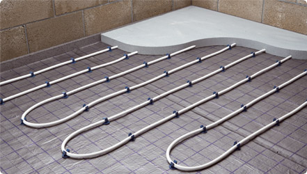

      Fabricate something similar to a domestic underfloor heating system under a false floor made of thin plywood and refit the bed liner on top? Connect into the vehicles cooling system with a seperate flow control valve similar to the one on the bulkhead, to shut off the coolant flow when the heat isn't requiered.
        You may also need a extra water pump to get the coolant round there, top idea vincent
