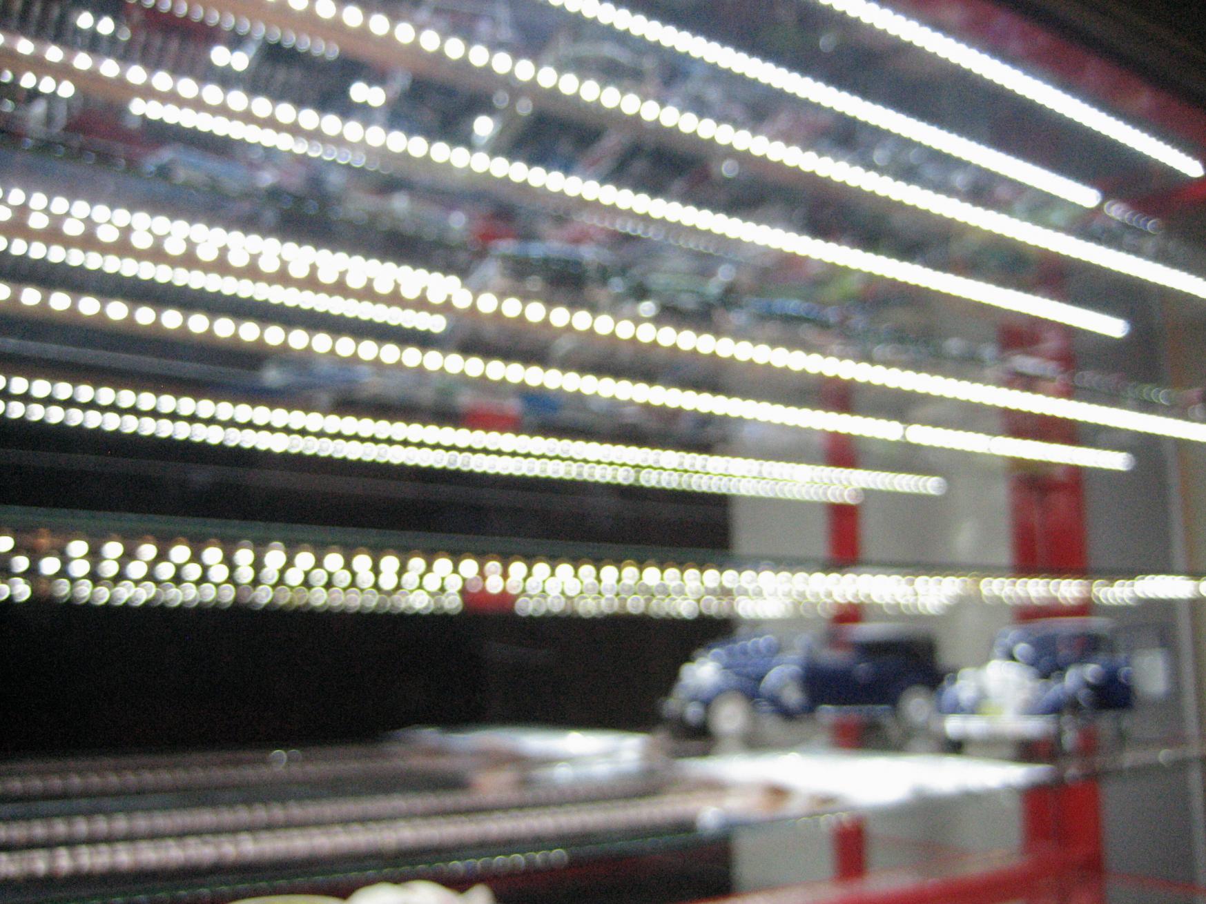

      Work this one out then!! when i wired a load of leds up to light the model car display they worked fine from a 12v battery but when i connected a domestic light fitting (the ones with 12v spots, GU thingy's) they went crazy, they'd go dim then bright and do it again, then flash like mad, then back to dim and bright, all led's were wired with a ristor each, (no series or paralell)
      gave up in the end and now i have "SMD" tapes (light strips) much easier, just hook em to a suitable tranny,
      if you have a small "gell cell" battery handy just test each led before fitting, ya never know thye might have accidentally dropped a flasher in there,
      i've had flashers, duff ones in some packs, especially from the peoples republic of tiddley winks sorry that was a bit "politicly incorrect" of me
                  Indeed they can be mixed up sometimes.
                  Thanks for the laff, (im an electrician) A 12 volt transformer as found on lv(12v) downlights in a house is only stepping down the voltage the current is still ac-alternating current.-which works at 50hz meaning the current is 'switching' on and off 50 times a second.Im suprised the leds worked at all!
                  led's work on dc-direct current, If using them on a mains supply in a house you need a 12 volt driver.
                  A driver and transformer are two different things

                        Yes as you guessed i'm no electrictian, the gu10 thing was just a try, i thought (foolishly) that if it powered three spots it'd do for the led's
                        anyway it didn't explode in my face so no damage done,
                        this is the new case and "SMD" strips i got the transformer/driver from the same supplyer, they do verious units that can drive strips from 3mt to about 30, (theres about 15 mt's of smd's in there,
