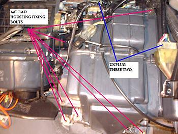

    You have to remove the passenger side lower dash, the small air con rad is in a plastic houseing there, some screws and clips if i remember right, i can look out some pics of when i did mine if it'll help

                The heat control is a cable straight to the valve on the bulkhead. Can't remember if there is 1 or 2 other cables to work the 'flaps'. Easiest way to find out is unplug the box and see what happens.

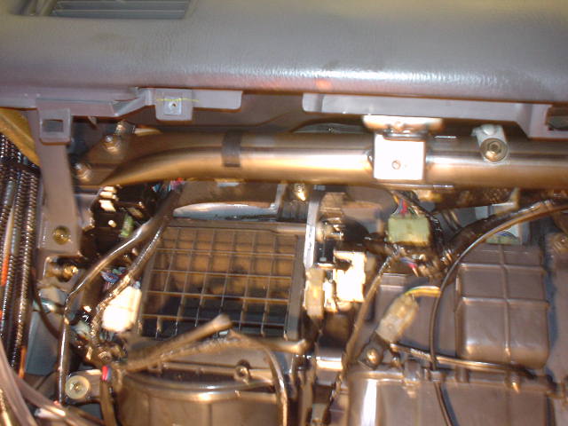

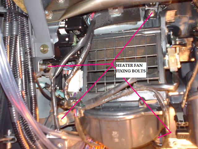

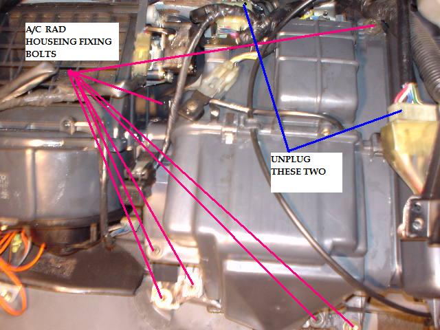

                    sorry me ole mate, totally forgot to check on this post, i left the board in place as i wasn't sure what effect it'd have by removeing it, you actually dont gain much weight loss by removeing the small rad and theres not a lot you can do with the space it took up as it sits between the fan motor and the heater matrix, if you remove the caseing air from the fan cant get to the rest of the heated so i just left the caseing in place, dont forget to block the holes left in the firewall where the pipes went through,
                      Just thought id better add that the pics are for removeing the unit, i re-connected the wiring plugs you see there after removeing the rad, main reason i removed this rad (apart from the fact it no longer served any purpose) was i had visions of makeing an engine oil cooler out of it, never came to pass tho
