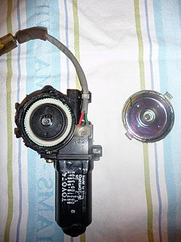

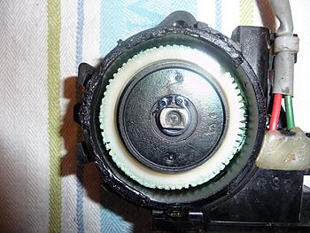

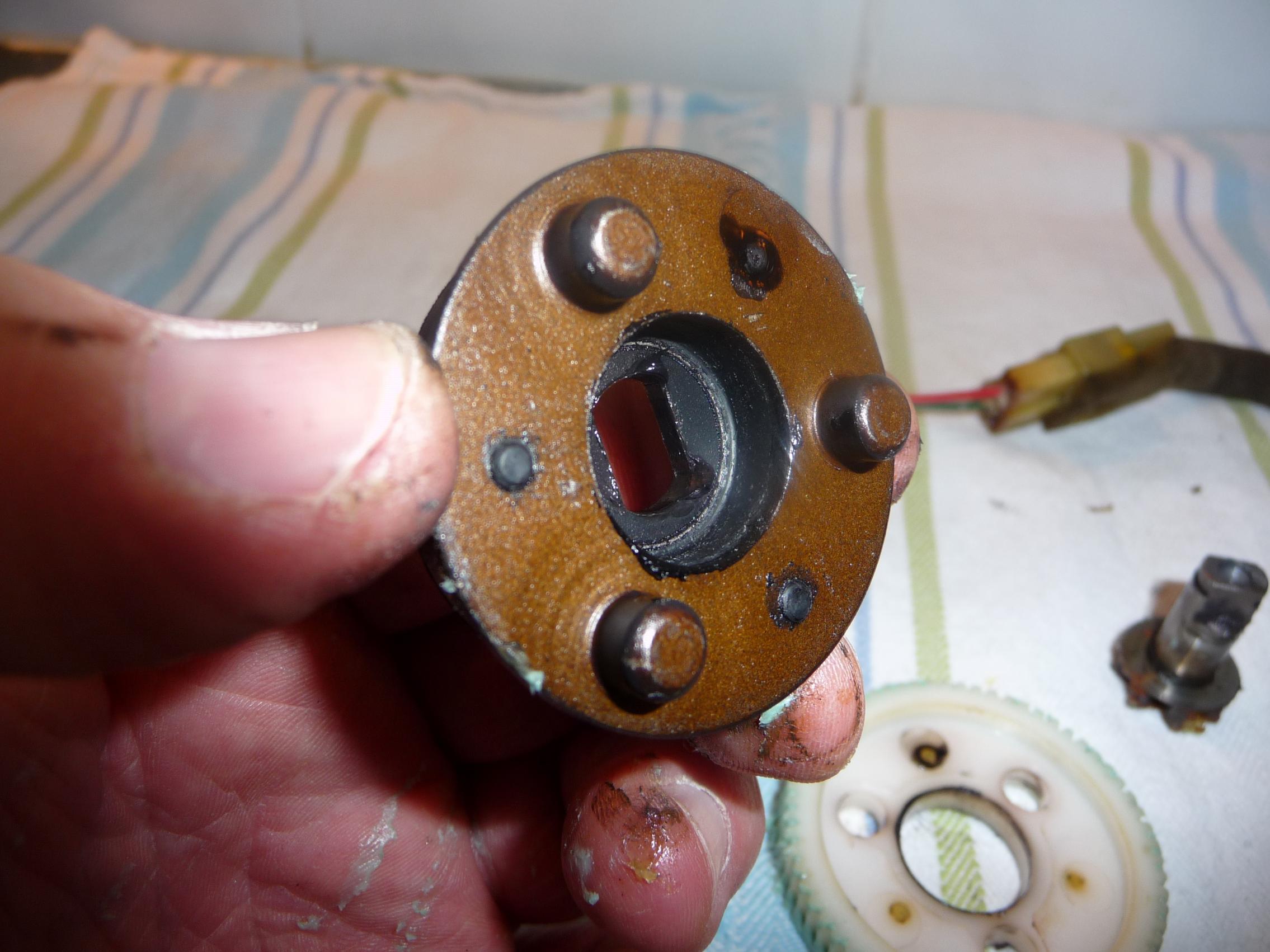

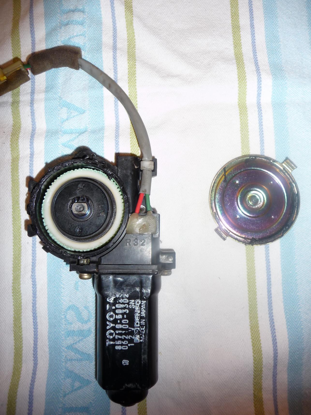

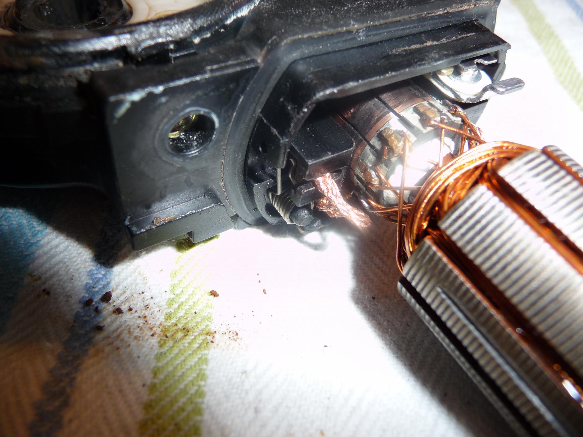

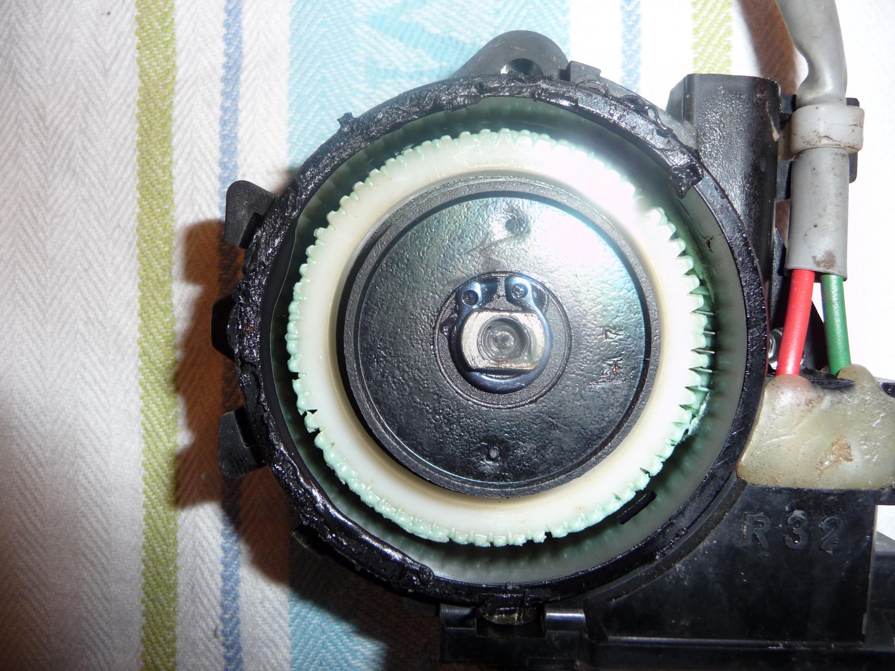

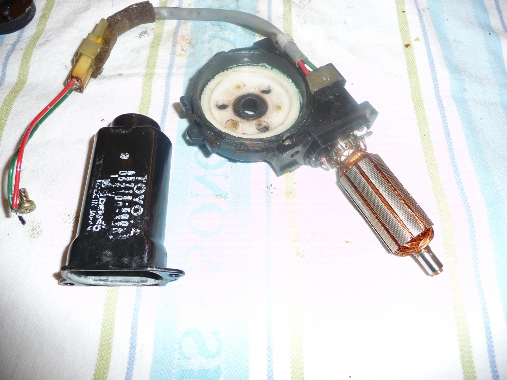

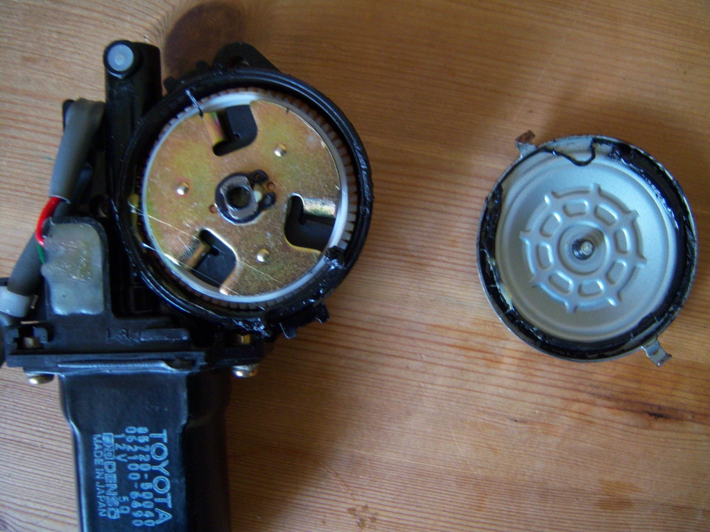

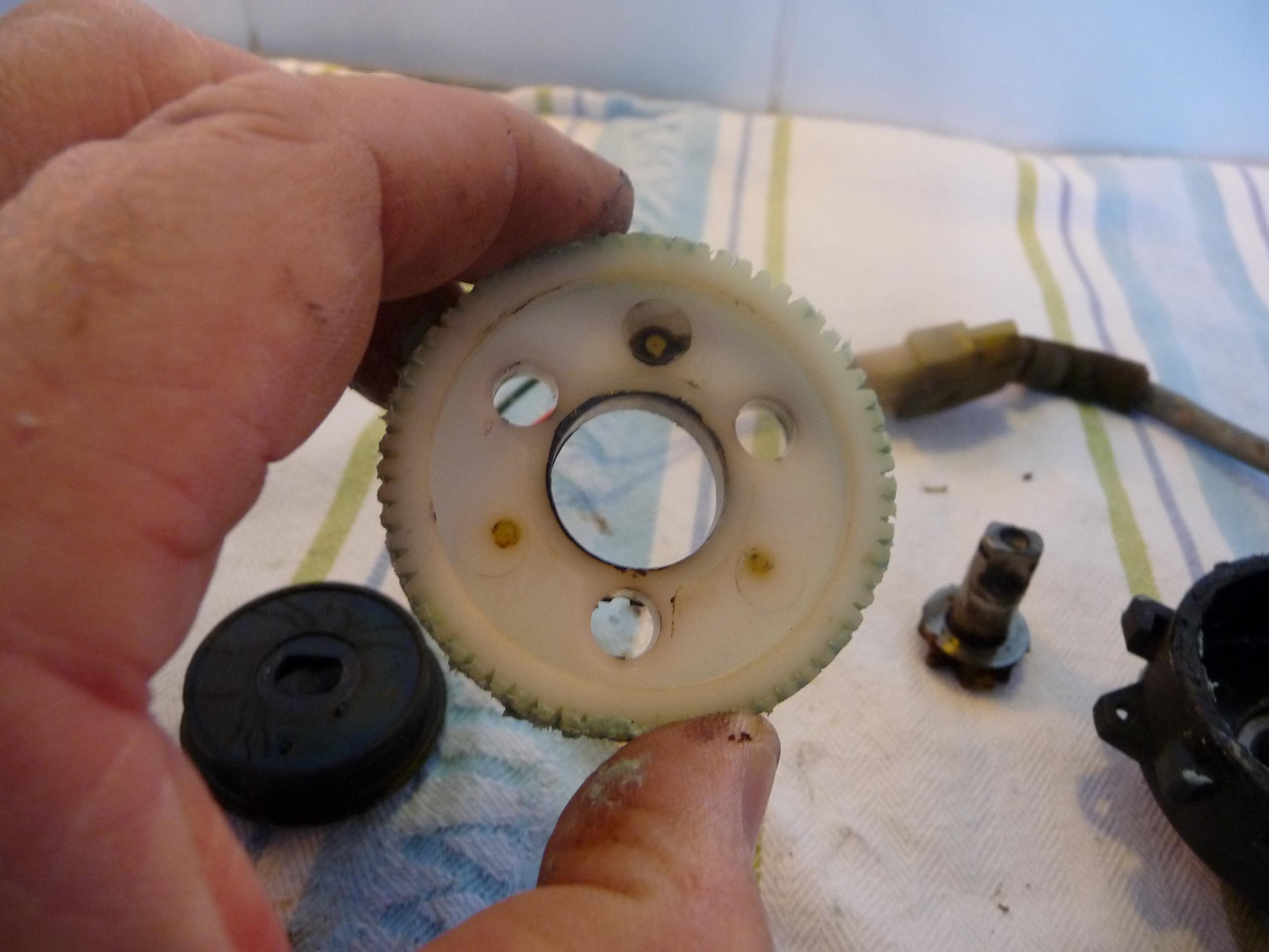

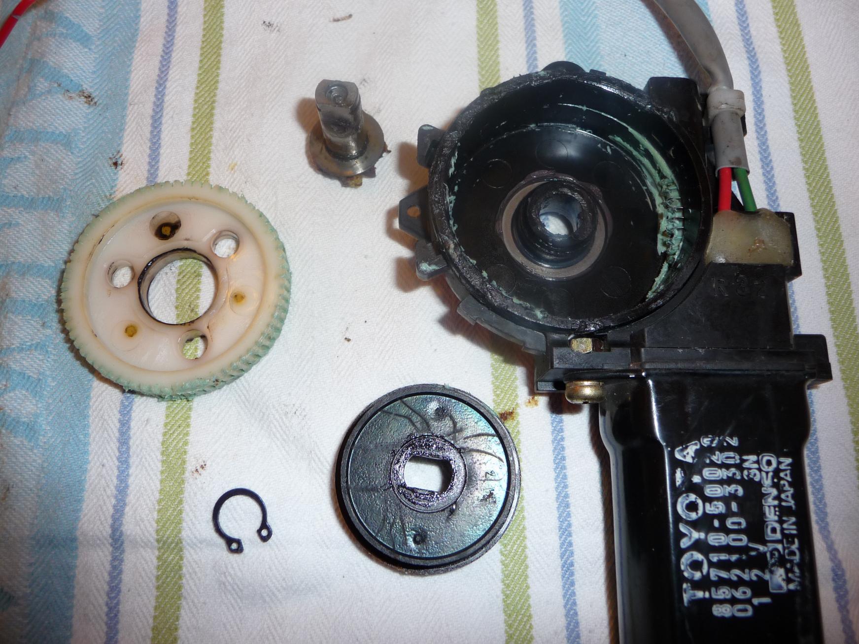

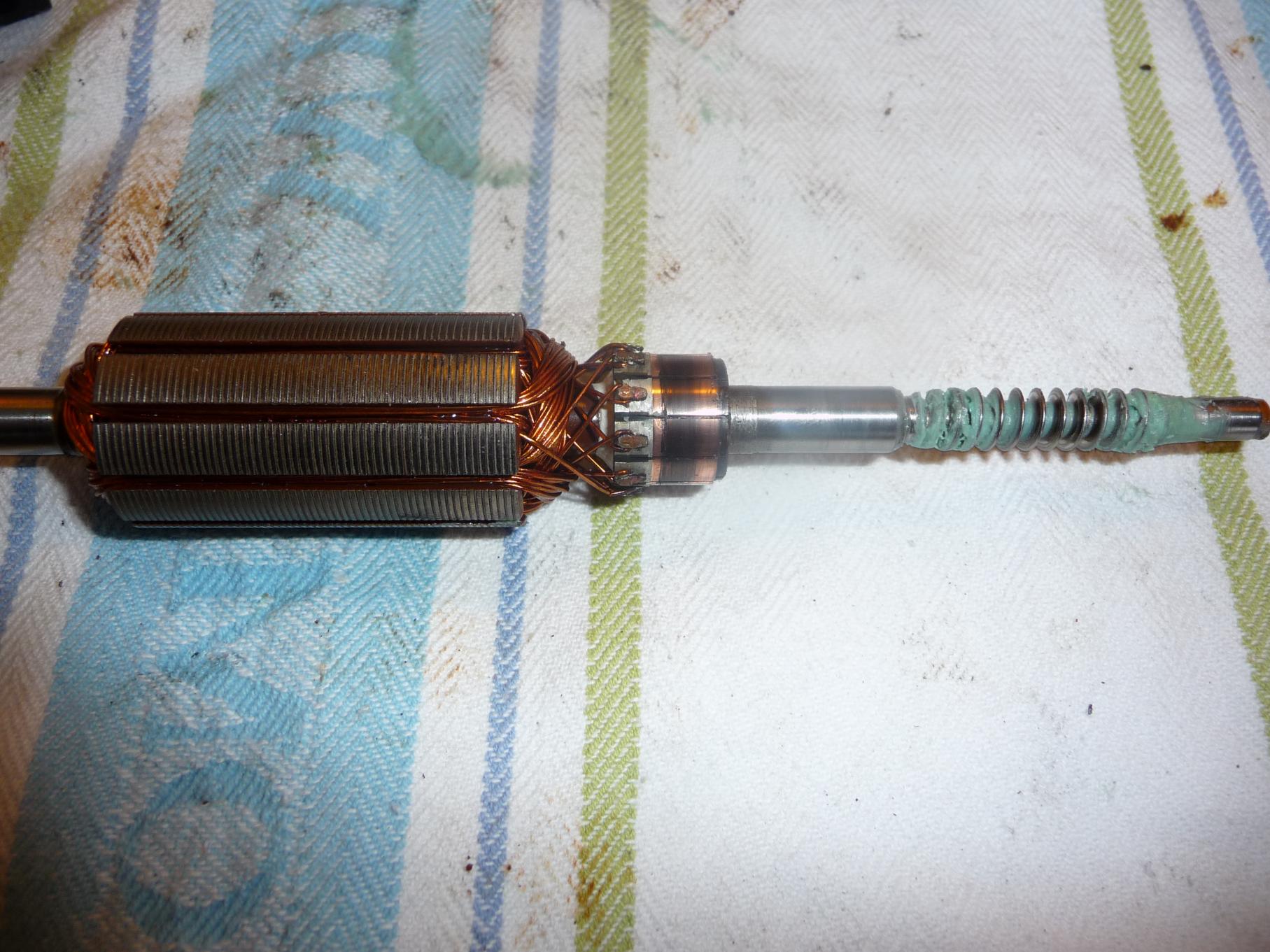

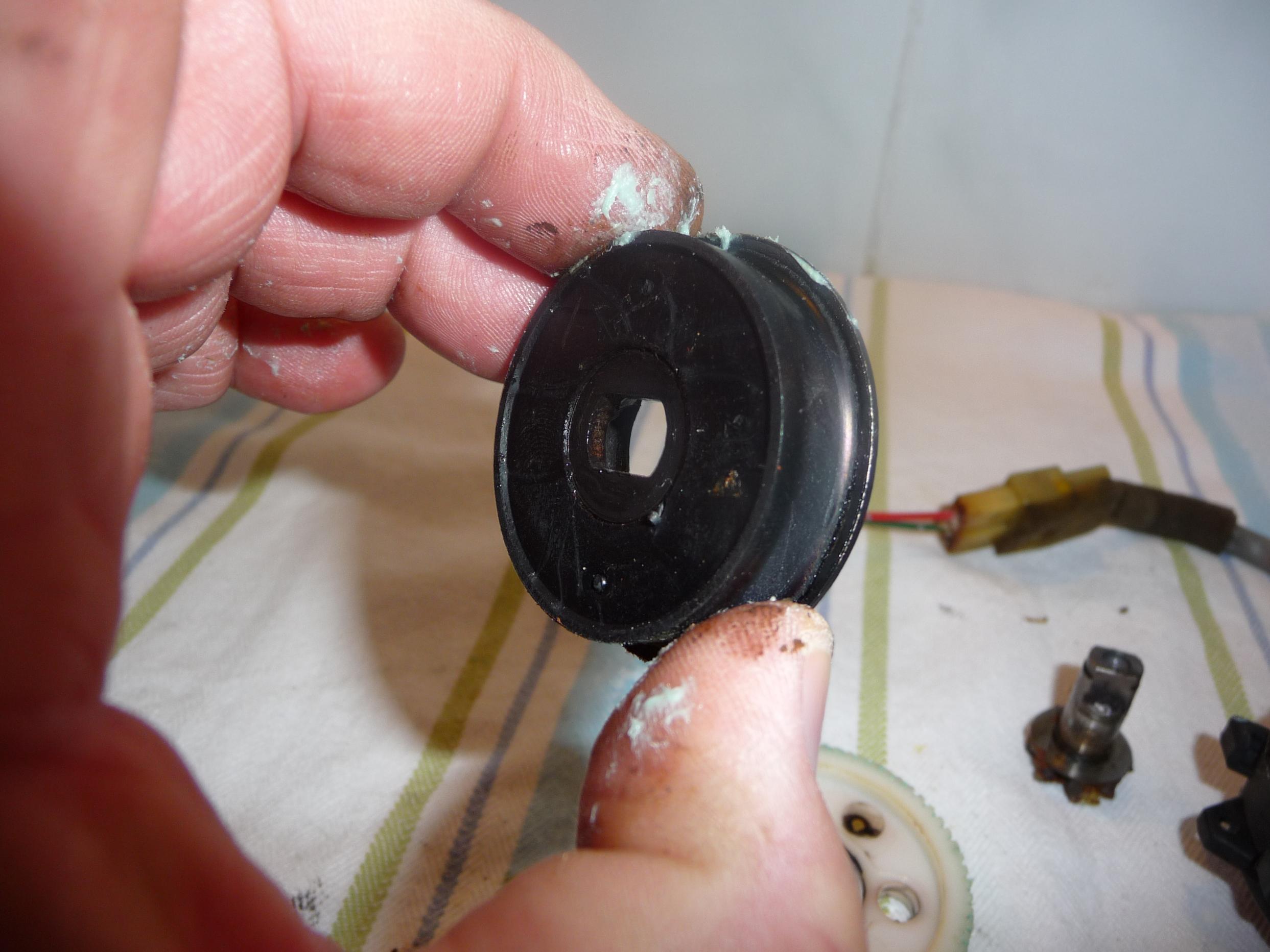

Hey, Andy. The motor arrived today. Thank you. There's good and bad news. Firstly, in comparison, it seems that the O/S rear motor that I specified (thinking that it would be the least worn), is not the same, and is a "mirror image" part. It seems that the info obout all four being the same was wrong, and that they are left and right handed. Hopefuly this will still end well, because I should be able to use the internals of the motor that you supplied, to "recon" my old one. Interestingly, the design of the drive plate is different to the image that I showed you, possibly not as robust, but it still looks like it will do the job well. Here are some pics of it, stripped I will report further when, hopefuly I finish the job on friday......Many thanks ...........Mick.
