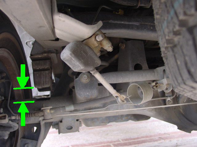

    It's above the rear axle, the actuator is on the left, the valve is on the right with a bar between (if looking from the rear) .
    It's raining here so not going to take a pic just now. Have a quick look on the net for a pic.
      Have found a picture it has a spring on it. Loking again under my truck i have nothing like it. Mine is a third gen is yours a second gen.

        Either way if yours has one I expect it needs to be on the rear axle. It adjusts the brake bias when you load the truck, I can't see how it would work anywhere else.
          Here's an idea, take a picture of your trucks axle, see if we can see it.
            Cant up load at the moment. Am i right in what i think i am looking for.
            SWIFT AND BOLD

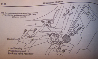

              I did a quick google, have a look here.
              I think this is a 2nd Gen Surf or maybe a Hilux.
                I lifted these images off Yotatech. Both posts said that they were 96 3rd gen 4Runner. Could they be the same as yours?....Cheers....Mick.
