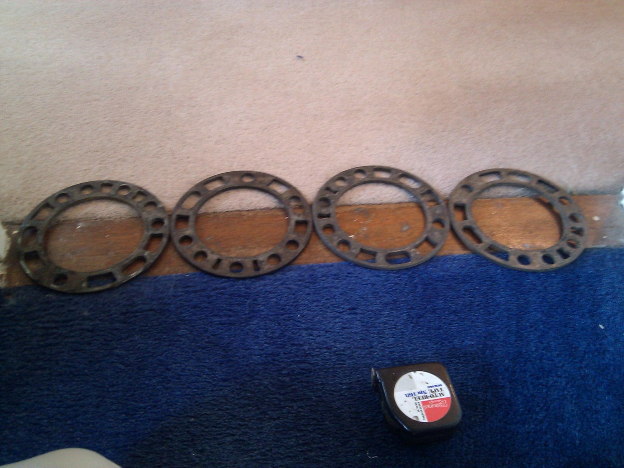

    I was in the loft the other day and realised when I saw them that I promised to upload a photo of those small spacers I have for you. I know it was some time ago, apologies for that.

    I'd forgotten all about them as I'm still using my 30mm spacers at the mo.

      Is that what you were thinking of? I measured them and they're about 4 to 5mm. TBH I can't see them making much difference?

        Yep I was talking about the 6mm spacers - reason being I have a bracket lift waiting to be fitted and it requires a back spacing of 3.75". My 8" wheels have a backspace of 4" so the 6mm spacer would make it almost spot on (1.4mm too close)
        Will probably end up using my 30mm spacers if the tyres don't rub.
