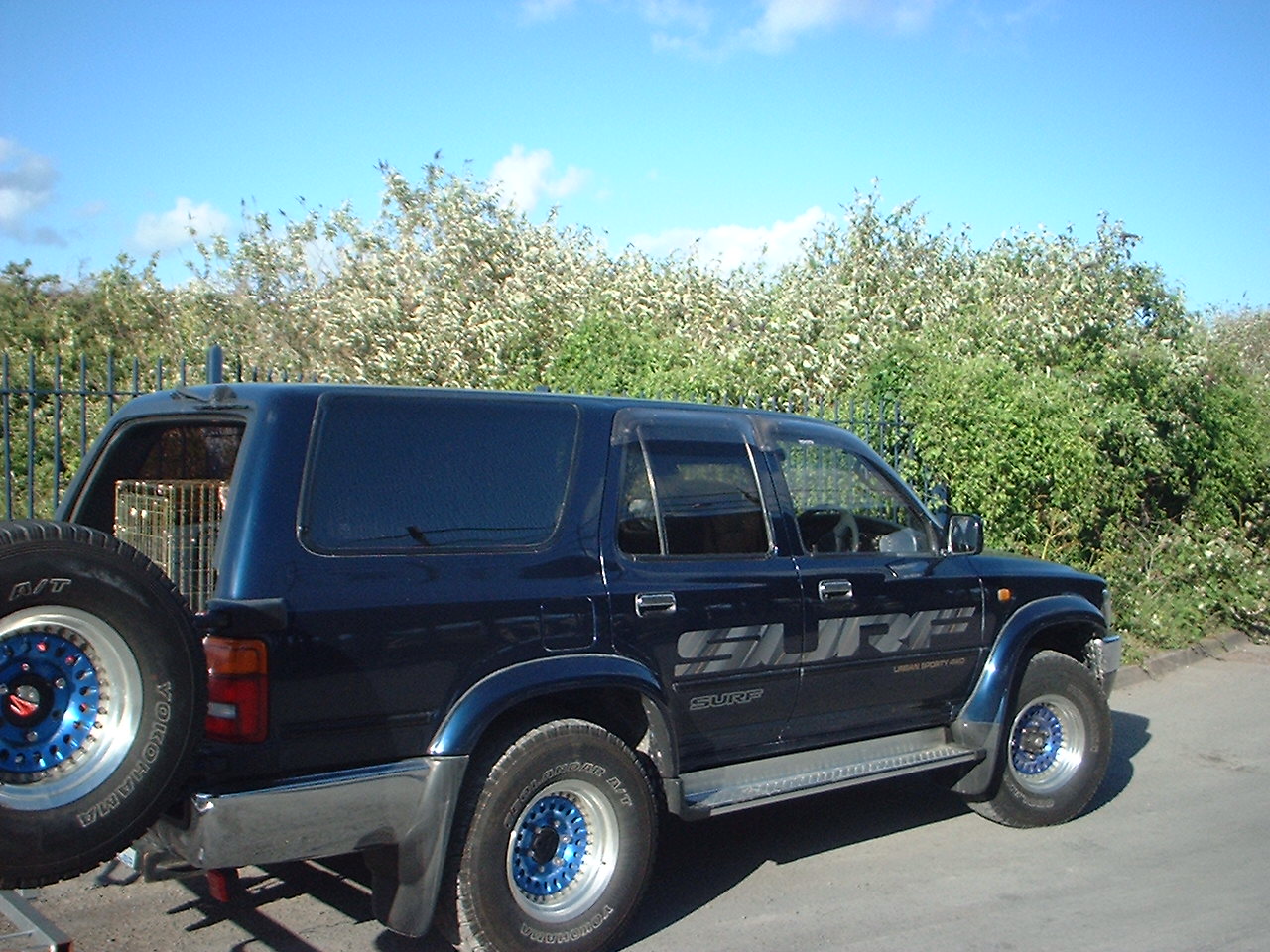

    At last been a long time got my surf already blown up as a bit of a project, took engine out then cut the end of my finger off at work which slowed me down a bit. Had to do alot to it, it already had a new head but that had been cooked so needed rebuilding. The turbo was shagged and emptied engine oil out of the exhaust then it siezed. I decided to rebuild so its got new pistons, big ends, mains, flywheel (other was badly cracked), camshaft, valves, buckets, reconditioned injectors and turbo. Goes well now and got more power than I expected always had gutless landies prior to this. Going to do a 200 mile trip tomorrow and give it a run in, really hope I've done everything up, bit paranoid after all that work!! Here's a pic I hope !?

    Well done, think you have now become the ultimate technical resource for the forum having done a ground up engine rebuild and got it working. At least you know exactly what was done to the engine so you should have a good one there with lots of miles left on it.
    Also it's a nice looking truck, love the colour and the wheels.

        Love the wheels!!! Nice truck there - well done you!!

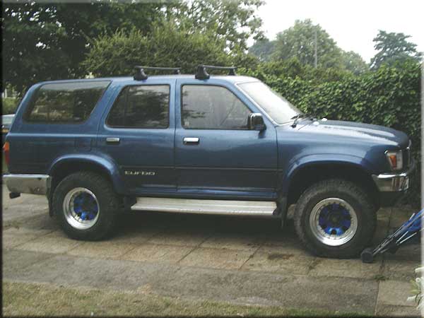

          yea well done, mmmm nice wheels, oh look the're simular 2 mine blue 1's goes faster

            Yep, Metalic blue (either plain or over Silver) gives you at least 20mph extra top speed and reduces the 0 - 60 time to less than a week
