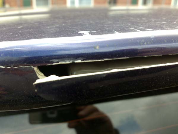

    My rear air spoiler is cracked and splitting by the rear light on it. I was thinking of gluing it up temporary in the meantime. Don't sure of any other method to fix it.

      Attached is a picture of the split spoiler. Do you have a link to a website with the camera as that sounds like a good option. Thanks.

        Bit of superglue and you'll be sorted for years with that.

                    I believe the spoilers are different from 2nd gen ones, if you want to glue yours it's made of "ABS" plastic so the "pipeweld" glue for plastic waste fittings will glue it, long as the breaks are clean and dry, plenty of glue and clamps leave it to throghly dry before removeing the clamps,

                        There is a spoiler for sale on eBay but for a 2nd. I didn't think that there was much of a difference in the body between the 2nd and 3rd gen vehicles. Would prefer to replace the spoiler rather than glue it together as it is also scraped along the side and top.
