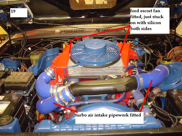

Gonna be looking round for a smaller one, found the prob with my sticky throttle, my old cable was fine, it turned out to be the butterfly cam (that the cable attaches to ) was fouling on a jubilee clip on the cooler inlet hose,
fine till ya floored it then the groove where the cable end slips in the cam jam's on the clip, just removed the cooler and piped it accross for now,
a smaller rad will be fine, this one was/is a bit on the large side,
