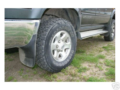

Hi all. My surf is sittin on Firestone Wilderness AT tyres and im not sure they're the right choice for road use? Whenever i take a roundabout or a sharpish bend, even at very low speed, they s-c-r-e-e-c-h. Everyone stares at me with disgust! It is in two wheel drive and the diff isnt locked. Any ideas anyone???
