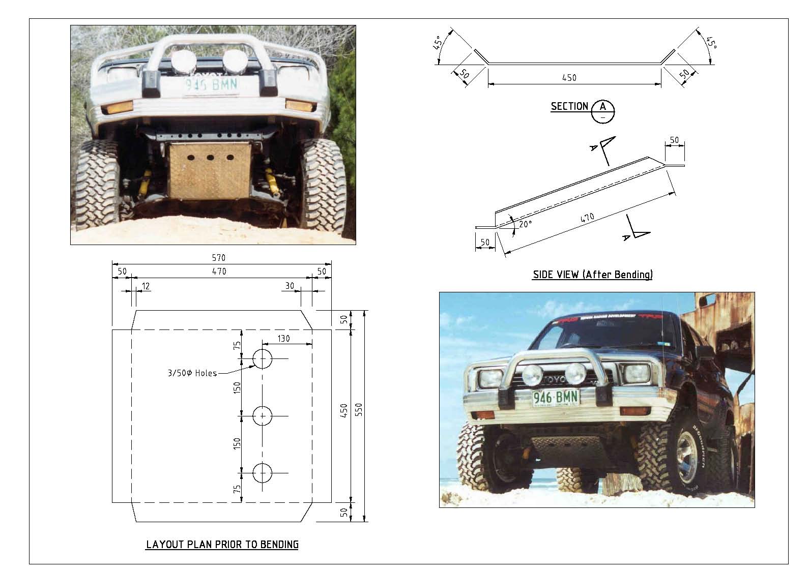

I had this image saved in a file. It looks very much like the bashplate in question. I'm sure that Andy will be able to confirm wether or not it's his. Hope that this helps....Cheers....Mick.

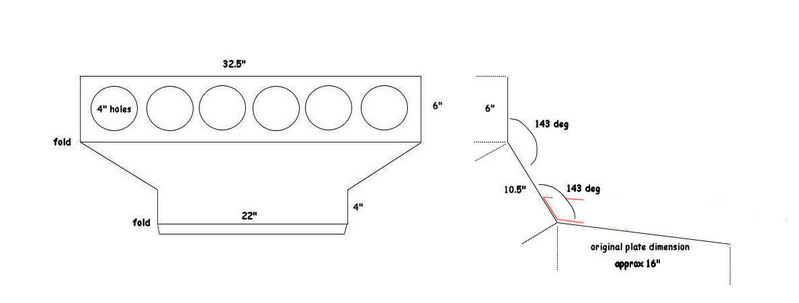

I made this one, a bit simpler but very effective, 6mm ali, tricky to fold, you need heat but nice and light (ish) to remove and refit but very strong.
I've just ordered a 2'x4' CNC plasma cutter, so I'll be able to chop these out for folks well Kerrsurfs anyways..Apaches might be too big without some fettlin
