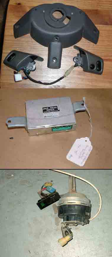

          The bits you need to instal cruise control on an early second generation 4Runner.
            i was thinking of fitting cruise to mine,,,
            has anyone done this yet???
            and if so how readily available are the parts and how bigger job is it??
              The standard American 4Runner parts are easy to find on Ebay. The system is more or less plug n play and takes a couple of hours to instal.
              The wiring is easy and 3 litre Surfs are probably already wired for cruise control, you can get the control module from lots of other Toyotas, but you might have difficulty finding an actuator suitable for a diesel engine.
