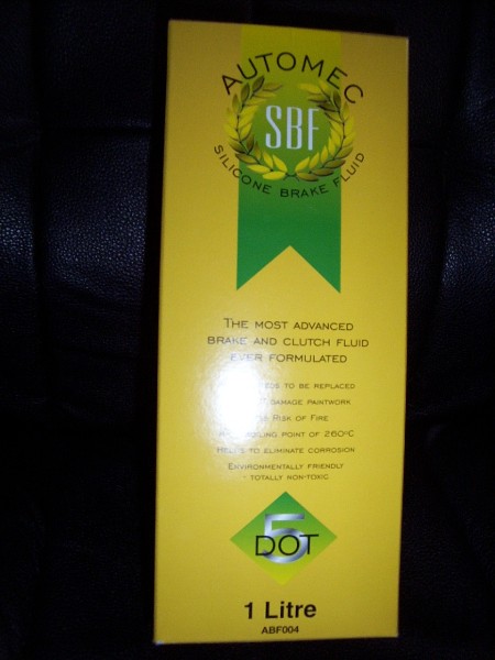

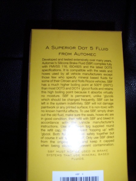

This is the stuff alot of the guys in my local Club Lotus use in older vehicles and new:
Automec SBF DOT5 .
Rear of carton reads, in breif :It is compatable with the seals and hoses used by all vehicle manufactures except for those few who use mineral based fluids ...
Higher boiling point at 500F then most DOT3 or DOT4 ......and absorbs no moisture ....
Will not damage paintwork ....
To use simply drain system .... bled out with new fluid .....
A general copy of the write up as images provided are marred by camera flash.
I have bought this fluid for my use , when car finished , possibley in another 18 years time . At least I now the shelf life is not affected .
