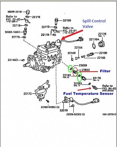

Hi Tony,
Have you got a wave washer and o ring spare for a 3.0 injection pump fuel temp sender housing ?
Just removed mine to check the filter and the filter was jammed into the bit the temp sender screws into, with the housing (22mm bit) missing its o ring and washer. Think that may explain the crap starting.
Have ringed the bits I'm after in green.
Thanks,
Rob.
