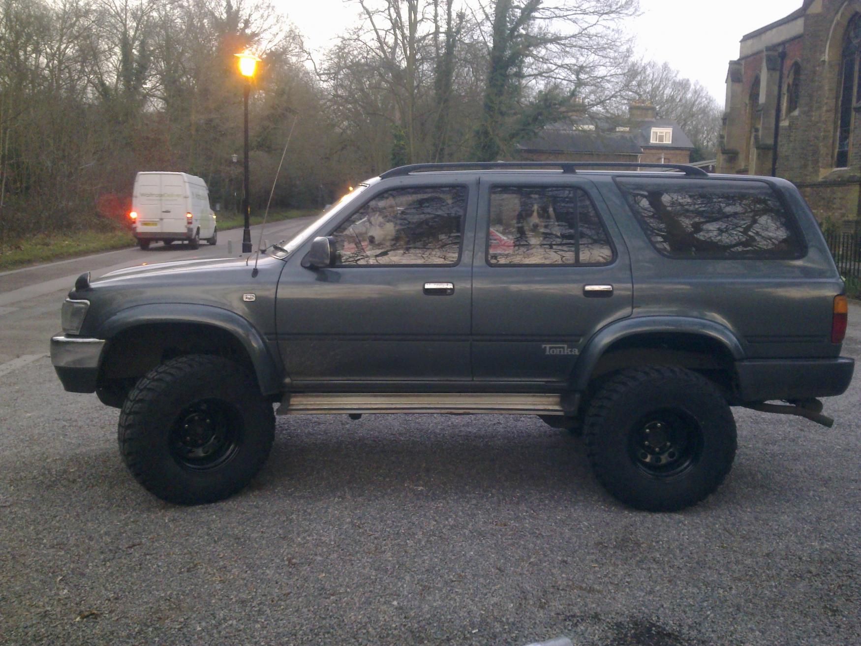

                Here's my 33/12.5/15s fitted to 8" rims, do your bulge more?
                  Slightly.
                  Best I can do till tomorrow
                  www.johnthebuilder.info
                    The writing on the top of the front wheel best shows the bulge...
