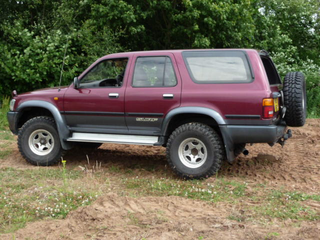

          I have 32's fitted on 15x8.5 rims and I do believe you know what my truck looks like
          I'm a custard donut monster
            32x11.50's... pics
            My 32x11.50r15's on paj rims. don't know if these are 7.5 or 8"...

                Hello Lee. Heres mine. + 2" springs, tweaked torsion bars, no bodylift. 32x11.5x15 Maxxis Bighorns on 7" rims Never had any problems.....Cheers....Mick.
