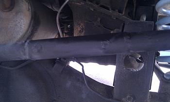

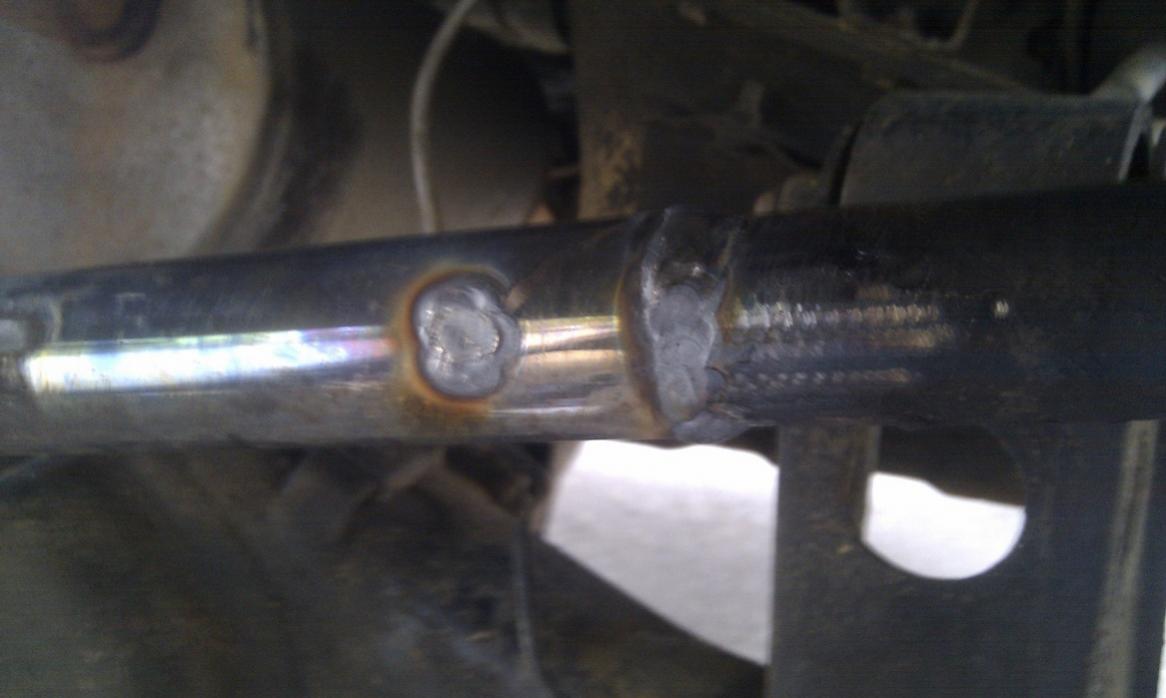

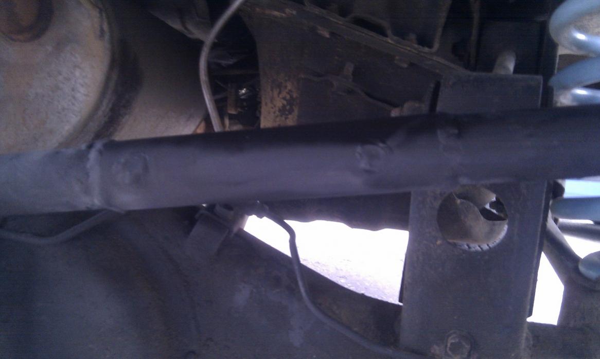

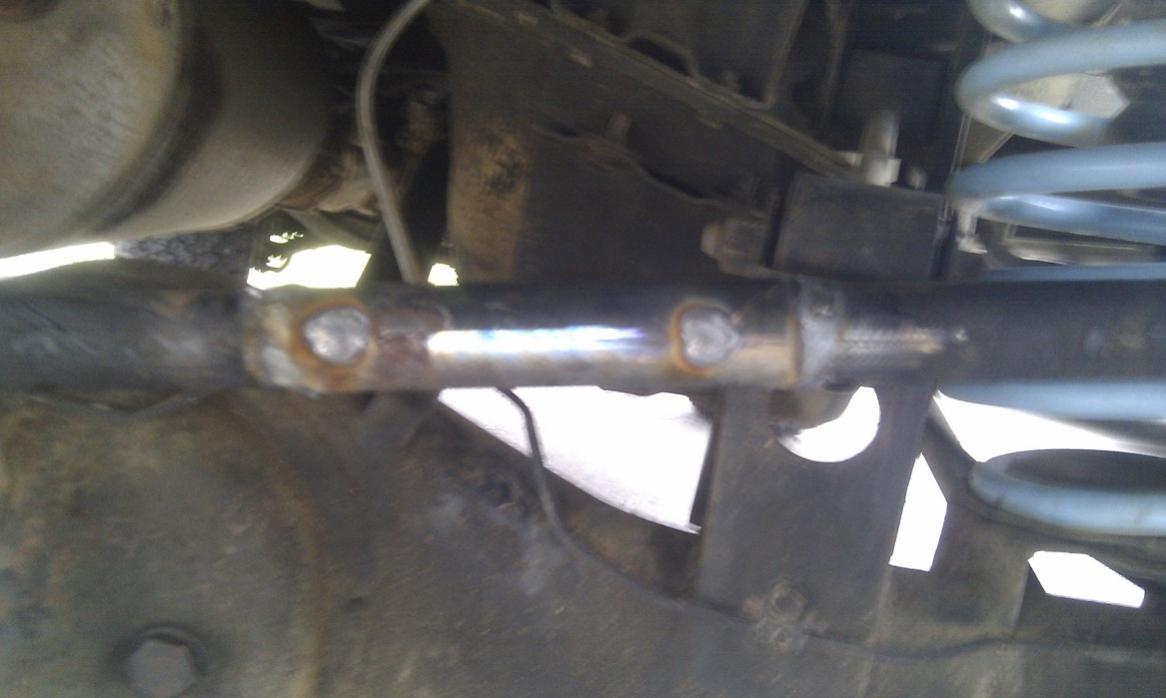

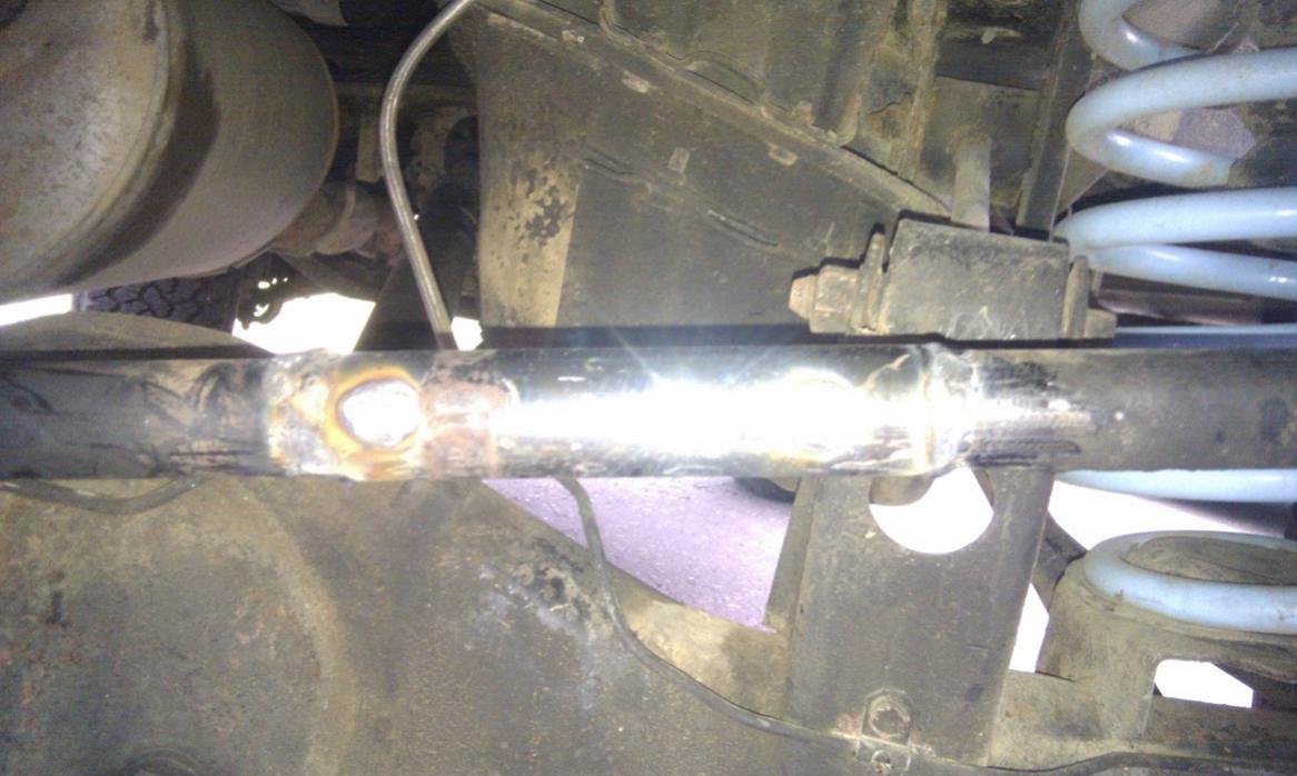

    Few months ago I cut and lengthened my panhard rod. I found some tube which was a nice fit over and cut so as to sleeve over quite a bit of the panhard rod. I then drilled some holes in the tube so I could weld more of the tube to the panhard rod than just the ends. Heres some pics.

    Nice job, going to all that effort you should have made it adjustable.
    Sent from the iPad you "lost"
      Ive never seen an adjustable one / don't know how!
      Oh Nana, what's my name?
        Try this link...
        http://www.roughtrax4x4.com/?doc=16&cid=150&vid=1350
          Thanks for the link.
          Expensive arent they.
