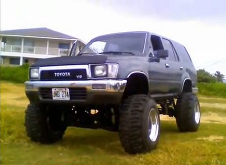

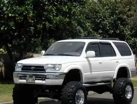

                            Thanks Mark,
                            I'm probably looking for something along the lines of these trucks:
                            Anything bigger and driving in England would be difficult I think.
                            How do you get in?

                              I've got 15x10 rims right now, will I need wider rims? I'll probably need 12" wide rims wont I
