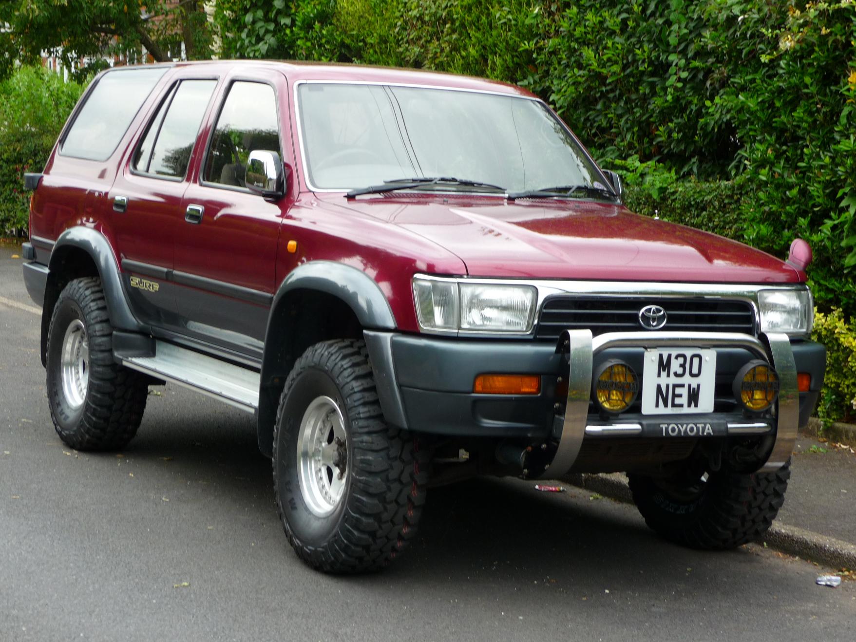

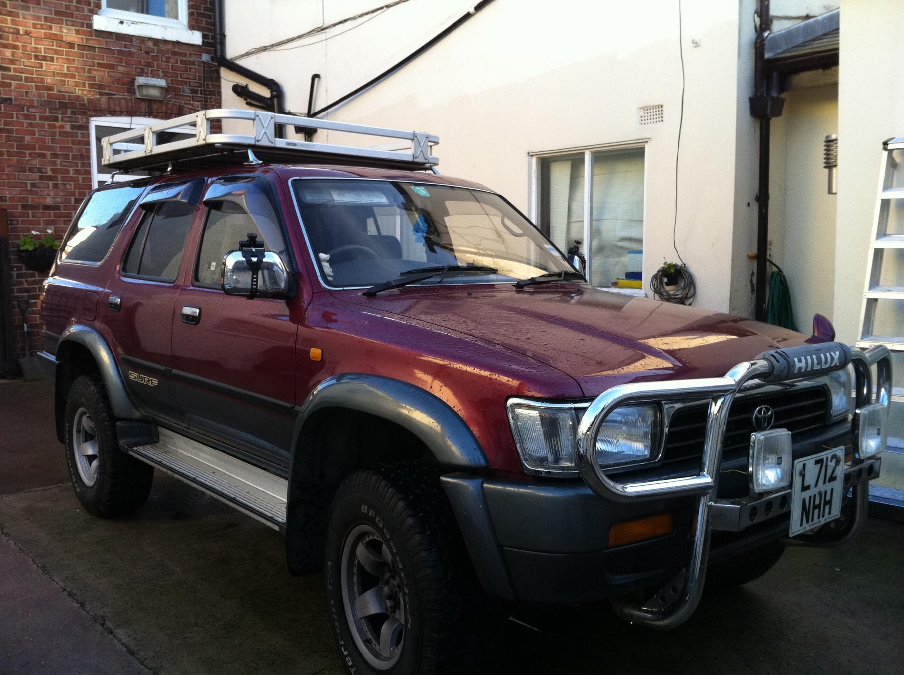

Lovelly looking truck that.
Thankyou!

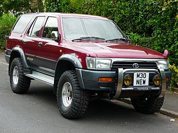

Question
1. where are the Fog lights from?
I got these lamps from ebay - stainless steel. I've had about three sets of chrome plated lamps which rusted in no time - so I splashed out on some stainless ones - about £50 the pair. They have side lamps in them too. Although the lens is pale blue - the light emitted is clear.

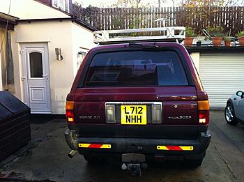

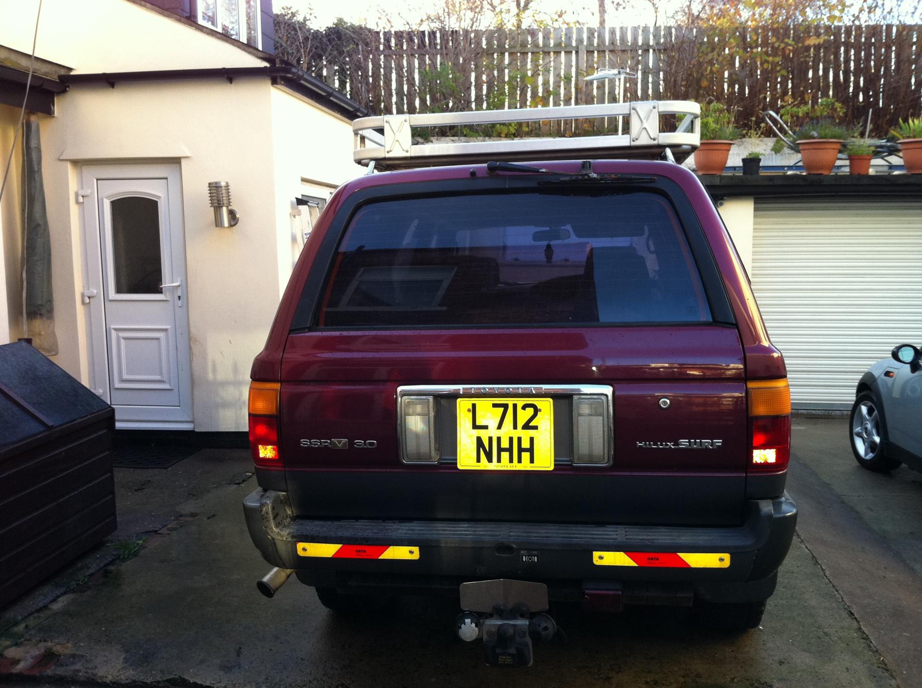

2. what roof bars are those?
The roof rails are by IronFly - got them through 4X4a&t http://www.4x4at.com/product_info.ph...product_id=134 based in yorkshire - well richmondshire. the feet have to be drilled into roof space and secured using clinch nuts - all part of kit. I bought some span bars with them but they seem to sag when any load applied so I made new bars myself from stainless steel "unistrut" - very strong and do not sag.
BTW -I know some on here have fitted roof rails from an estate (peugeot 406?) which fit perfectly.
