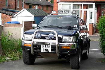

    ok, ordered the nudge bars, noticed marky got 1 of those bars with spotlights on the top, so come on boys where do i get 1 of them from, .

    marky made his from old cornflakes boxes, tin foil and of course some sticky back plastic........... and here's one i made earlier.......heehee.
    the rest of us brought ours from www.powerfuluk.com look under 4x4 spotlights.

          Marky used a modified Ski Rack to mount the lights on. You could also use a single Thule or Halfords roof Bar. Just bolt the lights to the top and run cables too them somehow - I have run the cables for mine, just haven't got the lights yet. I ran them through the roof when I had the headlining out to replace the sunroof. I have full length roof rails on mine so just need to use one of my roof bars fixed to that.

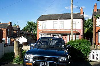

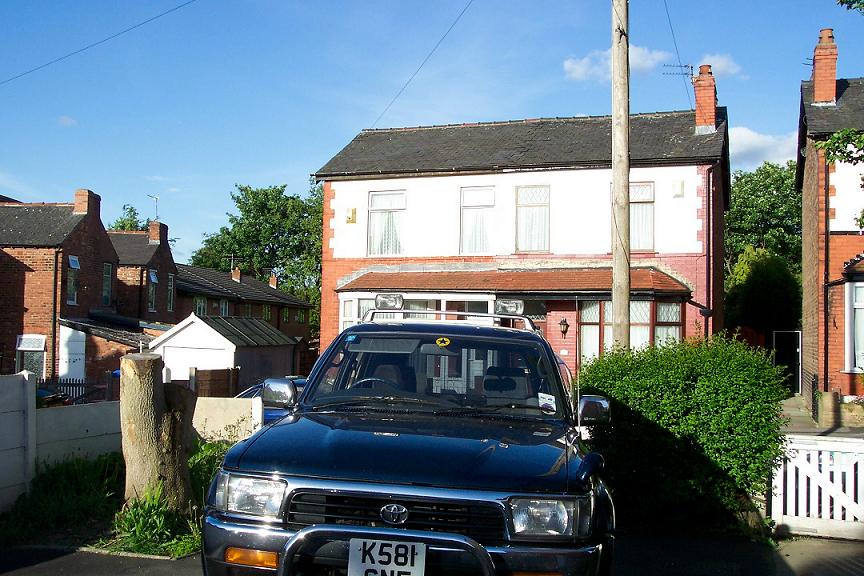

              I obtained a ski rack off a land cruiser thanks to Hilux bob. but ididnt like the finished light bar so ohsupremebeing bought it off me, he now has it on his roof

                yes i got it, had to do a little work to get it to fit, new bolts and 2 hours job done and very happy with the look too. Big thanks to marky
                  Im glad its ok. it looks good CHRIS
