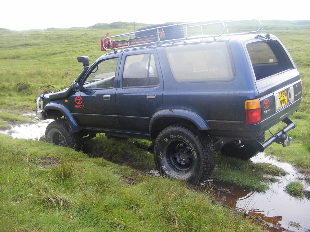

If you're planning on carrying much weight on top, make some mounting blocks and bolt the rack through the roof stiffening hoops. Strong as bu66ery then. I bolted mounting blocks onto neoprene gaskets. Never had any leaks.Cutting steps in the roof of the world
