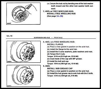

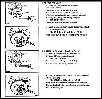

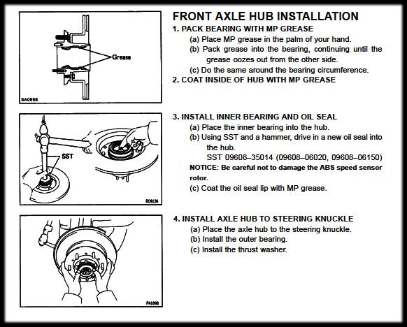

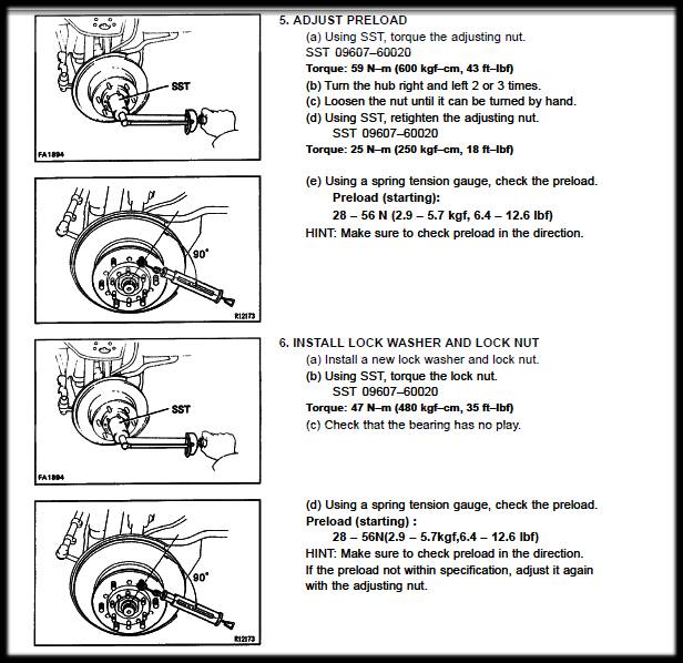

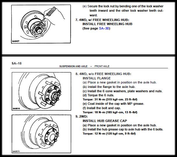

        • #19
          From the manual:
          • #20
            Example of a spring balance
            • #21
              Thanks wishbone.
              I'll be giving the images a coat of looking at before I go any further with the wheel bearings. The front plate with the six nuts looks a little complicated (cone washers etc) and I'm guessing I'd need replacement gaskets to put everything back together once removed.
