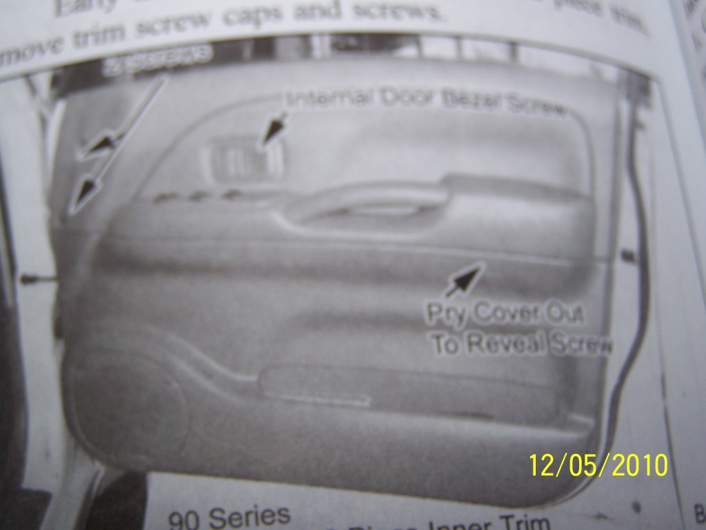

    can opener from the outside
      Electric window switches - use screwdriver to lever the unit back and up ( similar to the side wing repeaters when changing the bulb).
      One scew behind the door latch handle and you either have scew caps and screws near the hinges or they'll be the little plastic "push center in, pull out type".
      Aslo one more screw near the pull handle.
      There are two types of door trim for these, early models have a 1 piece card and later models have 2 piece card.
      I've not actually done this but that's all from the manual.
      Forgive the pic (from phone)
